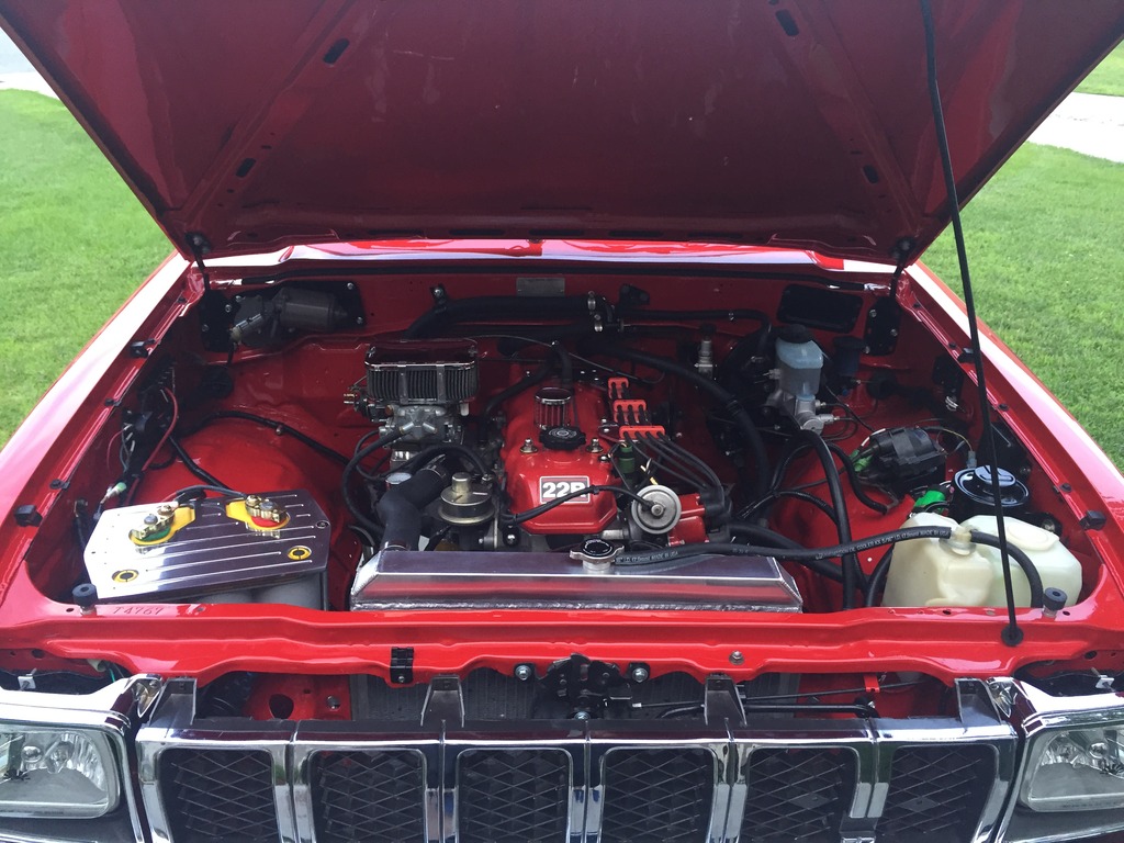

I have a fully restored 1983 4WD Pickup 5spd with a 22R that I rebuilt and first fired in March of 2015.
Specs:
  • Block bored 0.020" over and decked 0.006"
  • Engnbldr rebuild kit:
    • +0.20 domed pistons and rings
    • Standard bearings (All)
    • Dual row timing chain (steel guides)
    • New oil pump
    • New water pump
    • New timing cover
    • New gaskets
    • New freeze plugs
  • Factory connecting rods
  • Factory crankshaft
  • Rebuild head
    • Standard factory valves and springs
    • New stock camshaft (Engnbldr)
  • Completely desmogged using LCE's emissions delete kit
  • Stock intake manifold
  • Weber 32/36 with manual choke (stock jetting)
  • LCE spiral Weber adapter
  • Factory mechanical fuel pump
  • Holley fuel pressure regulator
  • Front breather filter
  • PCV valve routed to the intake manifold
  • Stock ignition and coil
  • Stock distributor (Stock curve with dual vacuum - radiator side port to the carb & head side port to the manifold)
  • NGK spark plugs
  • NGK wires
  • 40 amp alternator
  • Optima Yellow Top battery
  • Aluminum radiator
  • Power steering
  • Power power brakes
  • Exhaust:
    • TG Rock Ripper stainless headers
    • 2.25" braided stainless flex pipe (reduces stress on the exhaust manifold studs from exhaust movement)
    • 2.25 piping
    • Thrush Welded Muffler
    • Exhaust dumped straight back about 30" from the muffler to a down turn tip tucked behind the roll pan
...I think that about covers the specs
Tuning:
  • 89 octane non-ethanol fuel
  • Valvoline 10W-30 conventional motor oil with zinc additives added
  • Timing set to 10* advance with vacuum advance pinched at 900 RPM
  • Fuel pressure is set just shy of 3 psi
  • Weber 32/36 adjusted per the best lean idle method provided by Weber with the idle backed down to about 750 RPM
Results:
  • I have driven the truck about 2,000 miles since first firing the engine. So far there have been no mechanical issues with the rebuild or the components.
  • Power is good from 0 to 4,000 RPM - very noticeable increase over stock.
  • Fires up on the first bump every time WITHOUT the choke (I have not started it in cold weather yet)
  • Turns 31x10.5 tires on aluminum 15" wheels very well (gears are stock 4.10's)
  • Can maintain 75mph on the highway in 5th gear, but can struggle to maintain those speeds going up hill
  • Fuel economy is good - I'm constantly getting 19-23 MPG depending on how much my foot is in it
Cons:
  • Fuel delivery has become an issue with the Weber 32/36. There is a slight stumble when entering the secondary barrel on the carb, but before and beyond that stumble the engine runs "adequate"
  • Changing the jets provided no solution to the stumble so I have been able to determine that the carb is providing a lean condition in the upper end of the RPM range where the accelerator pump simply can't keep up with the demand. I have ordered a Weber 38 to correct this issue. There is definitely more power to be had than what the 32/36 can provide so hopefully the 38 can provide that - I'll post the results
  • I will also be upgrading to an electric fuel pump to provide a more constant fuel flow and more volume.

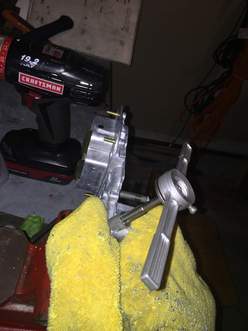

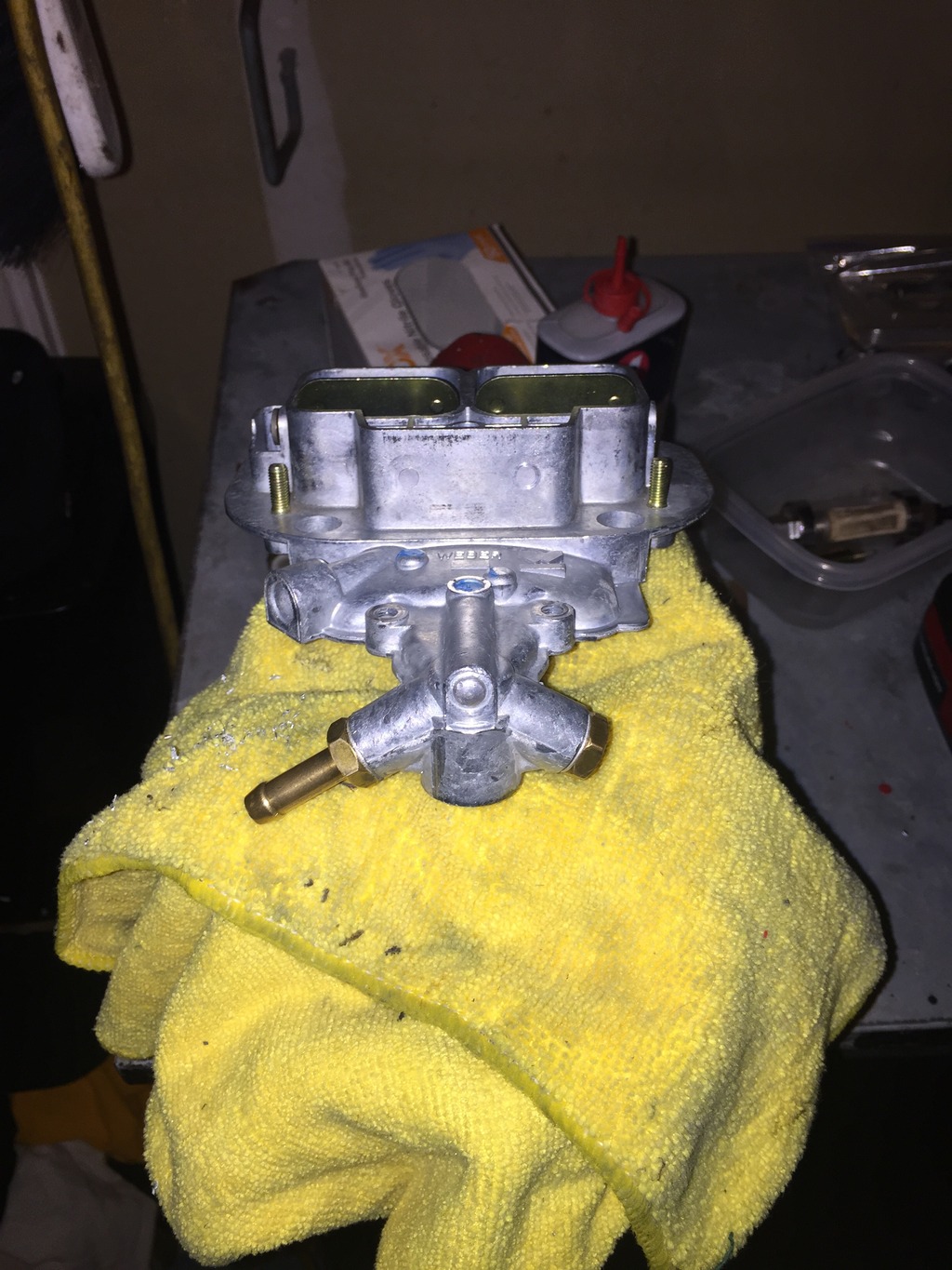

Here are some shots of what needed to be done:
Tapping the fuel inlets:
Tapped:
Fitting and plug installed:
Carb installed:
I had everything setup per the Weber baseline instructions before I installed the carb so it was just a matter of busting out the timing light and turning it over. Once it got fuel it fired right up! I started making adjustments to the mixture and it seems like the Weber baseline settings may be spot on for my truck - turning the mixture screws in or out seemed to make the idle worse. All I needed to do was bump the idle speed up about a 1/2 turn to get me around 800 RPM and then set the fast idle to 1,200 RPM. Rechecked the timing and all was good! It literally took longer for the engine to heat up that it did to tune it! 20 minutes later and I was rolling out of the garage. What are the chances of that? It's pretty comforting knowing that the 38 is pretty much a PERFECT match for my engine! I have some very slight fine tuning to do to get it just right.
RESULTS:
At this point, I'd never go back to the 32/36 - At least for this particular engine! The extra torque and HP is definitely noticeable. The carb is running slightly rich throughout the RPM range so I have some slight tuning to do to lean it out. I was worried about losing the top end, but that certainly wasn't a problem at all. I buried the speedometer at 85mph (about 94 mph corrected for tire size) on the highway! I took the picture below at about 78 mph (about 86mph) because my truck was a little too "floaty" to risk taking a picture any faster. It was riding fine, but you know how it feels with these like solid axle trucks at high speed - it ain't like driving IFS that's for sure!

I don't have any pictures of just the linkage that I can recall off hand, but flip through my build and desmog threads and you should be able to get something from them. I can tell you this much, if your linkage is binding and it is not a genuine Weber, then it likely isn't the linkage setup - it's probably the throttle linkage on the actual carb that is binding. If you do not have a genuine European made Weber then I can almost guarantee that you have issues there.

Originally Posted by kawazx636
I'll get this party started....
Specs:
    • New oil pump
    • New water pump
    • New timing cover
    • New gaskets
    • New freeze plugs
  • Rebuild head
  • NGK spark plugs
  • NGK wires
  • 40 amp alternator
  • Aluminum radiator
  • Power steering
  • Exhaust:
    • 2.25 piping
Tuning:
Results:
Cons:
Attachment 118861
Attachment 118862
