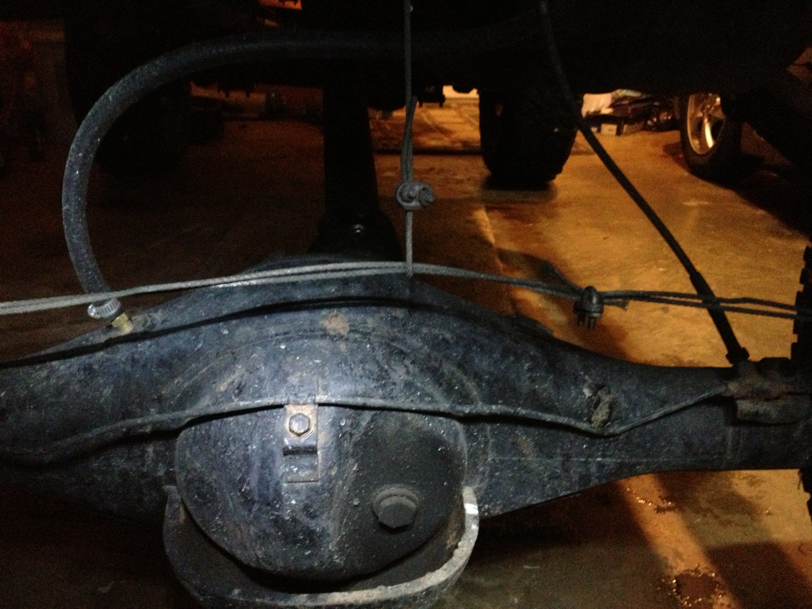

Here are some pics of what I did.

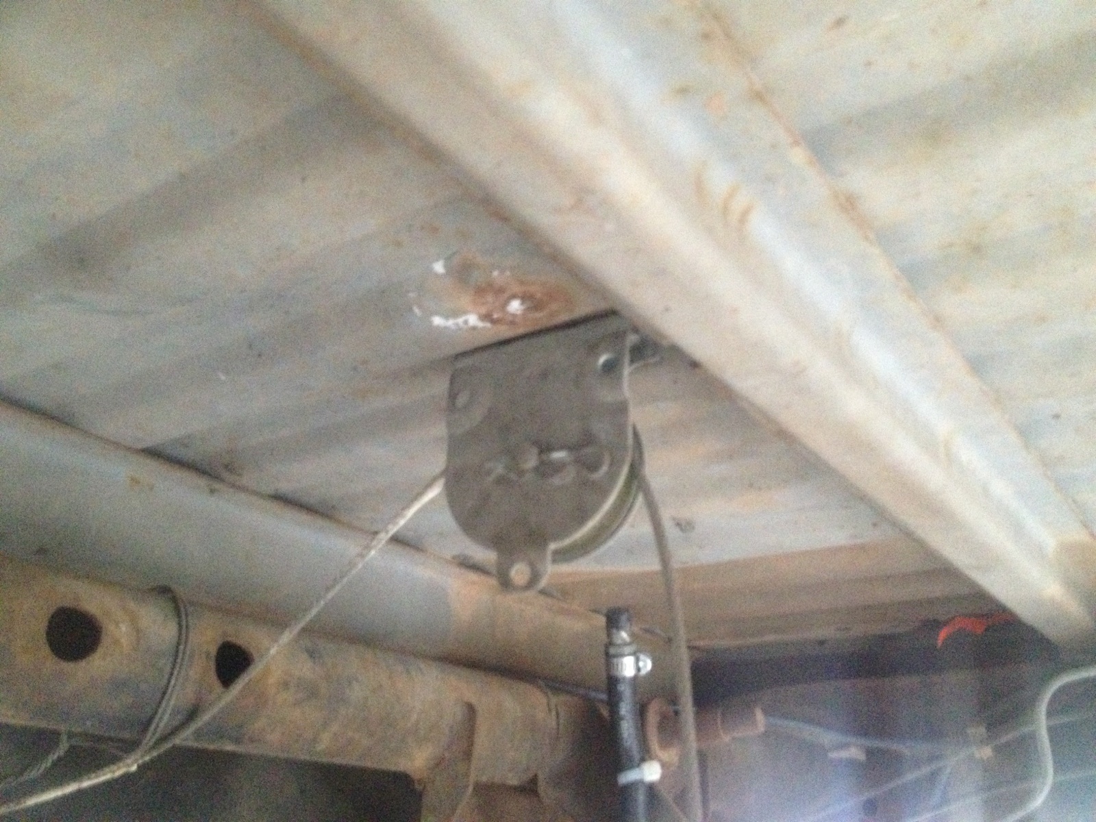

As you can see, everything is exposed and there is no cover. All parts are stainless or galvanized and so far I have has no rust problems at all. I am sure it helps that I live in Texas though...
I ran the first cable to connect the two parking brake levers.
The second cable I looped around the first, ran through a pulley and attached to the original front cable.
