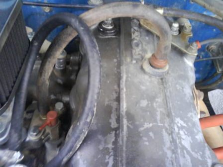

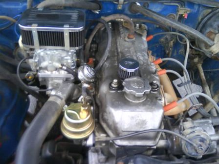

here is how my engine is plumed
Attached Thumbnails Oil leaking out of vent line filter?!-dsc00958.jpg   Oil leaking out of vent line filter?!-dsc00957.jpg
