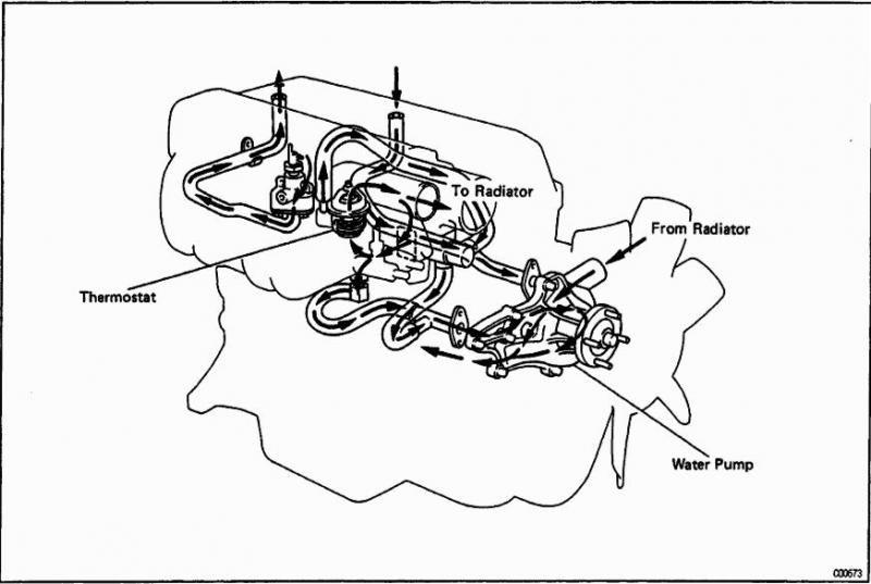

Here are the 22r and 22re flow diagrams, they show it as a return line to the pump..
