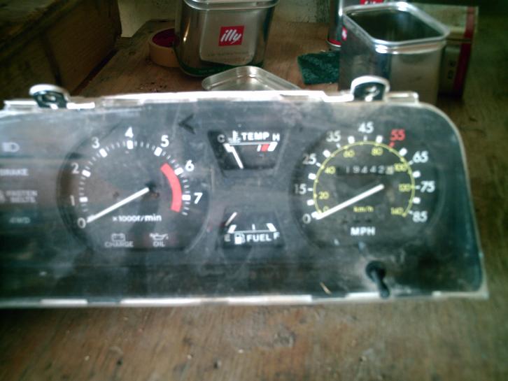

Has any one ever swaped these clusters? Do any plugs match? I know I'm going to probably have to find the plug and wires for the tach any ideas. Is this worth my time to try? It would be nice to have tach and trip meter. Any help hear would be greatly appreciated.

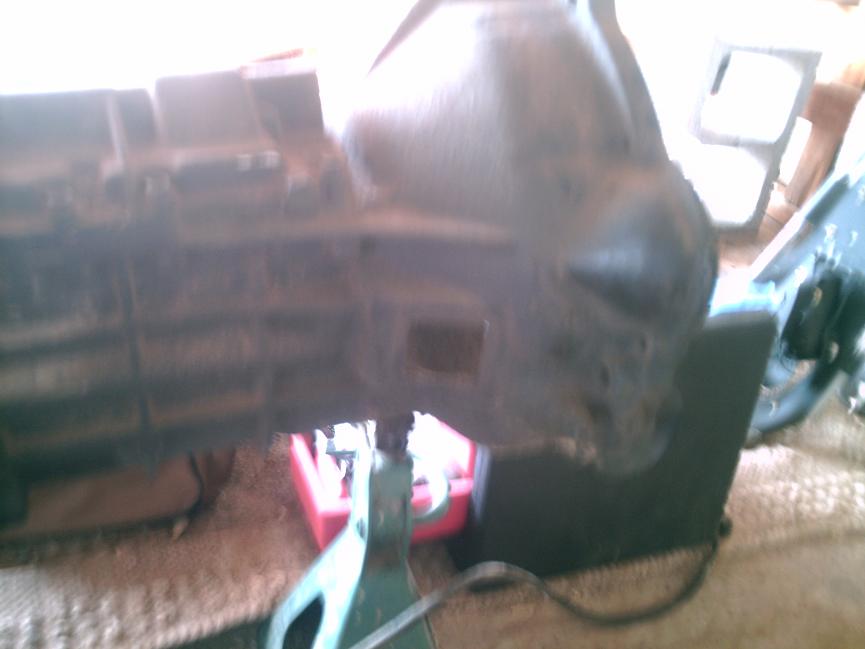

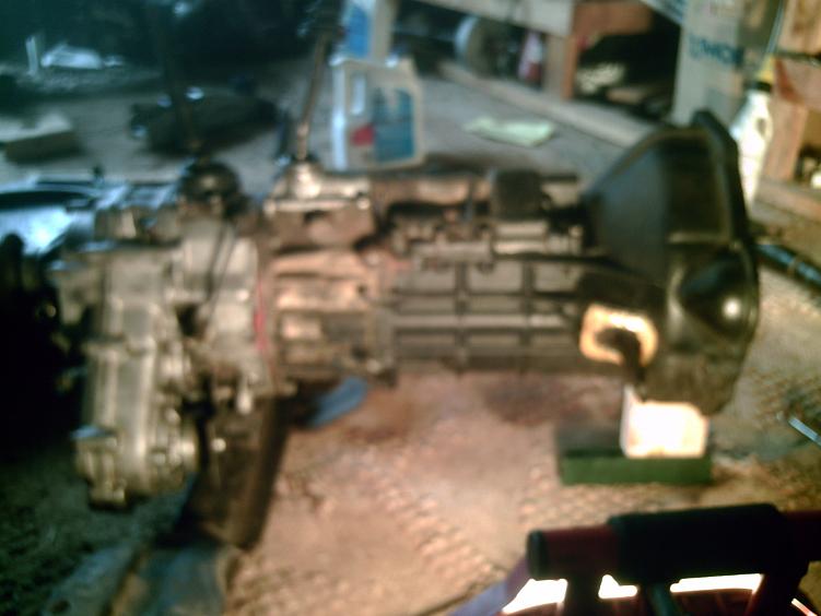

The 4 speed is great, because it works... But I got this 5 speed out of an 82.
What is that hole for? I did I search and found a guy who had swaped the l52 into his 79' mating it to his 20r, but he said he had to source longer bolts for mounting it to the bell housing of the 20r, any truth behind that I cant seem to find his thread that he did and his write up. I got the transfer case with the deal so I think I am going to just use it so I don't have to grind the groves out.

The hole? You mean where the clutch fork passes through?

Here's the thread for the gauge swap..Your swapping a '79 DLX cluster, for a '82/'83 SR5 cluster...I believe the wiring harnesses are different but I'm not sure..I did the swap but it was for gauges from the same year...If the three harnesses are the same so should be the corresponding wire colors..good luck

Look at the back of the gauges.. if there square then they probly wont work gotta find the round ones.

Yeah, you'll have your work cut out for you if you want to switch those gauges. Everything changed. You can splice all the wires from the round-style plugs in your truck over to the square-style in that newer cluster, but you'll probably need the wiring schematic for both your truck, and the year truck the cluster came out of (82 or 83) and figure out what wires go where. Not an impossible job but probably not worth it...the older style gauges with the tach look a lot cooler anyway, in my opinion. You're better off just trying to find one of these:
And...uh..yeah...that hole is where the clutch fork comes out...

I think I am going to wait the cluster out and find the easier one. After all I'm just after the tach and trip functions. Anyone want to trade for this snazzy one?

Transmission ID-to me it is hard to tell L45-50-52 series transmissions apart but this link from marlin might help:
http://www.marlincrawler.com/transmi...built-complete
Transmission bolts: you will need longer bolts for the L50-I just did the reverse conversion -put an L43 in my '81 due to availability-I had to use 2-3 washers on the two lower bolts to take up space. The upper two bolts were not an issues

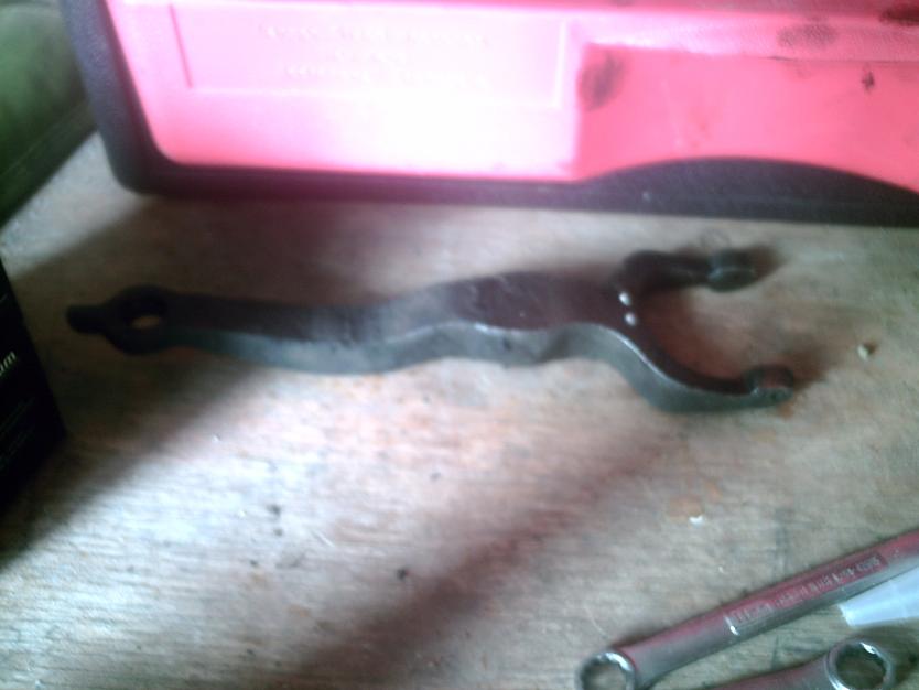

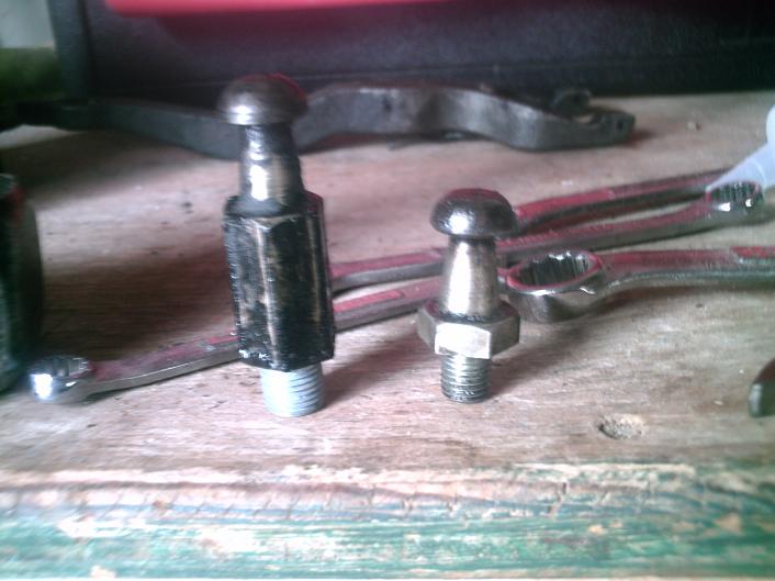

Ok folks need some help now. The clutch fork from the L43 does not work in the L50. The pivot that the fork sit on are different sizes. The L43 clutch fork hole is smaller and placed farther back. I tired to use the L43 on the L50 and the throw out bearing wouldn't sit far enough back and would push itself off on the the input shaft. DAMN. Can some one point me in the direction of a fork and dust boot? I've tried to do the "GOOGLE" search and came up with nothing. Please help! I was so close to having it to gather but she wouldn't go. After inspection I can only say that it is the fork. Thanks for any help.
The last picture is how I took some seal and made the dust boot from the L43 fit the L50. Again thanks. And if you want to sell me one feel free to email me at ryan_stimac@hotmail.com or PM me.
