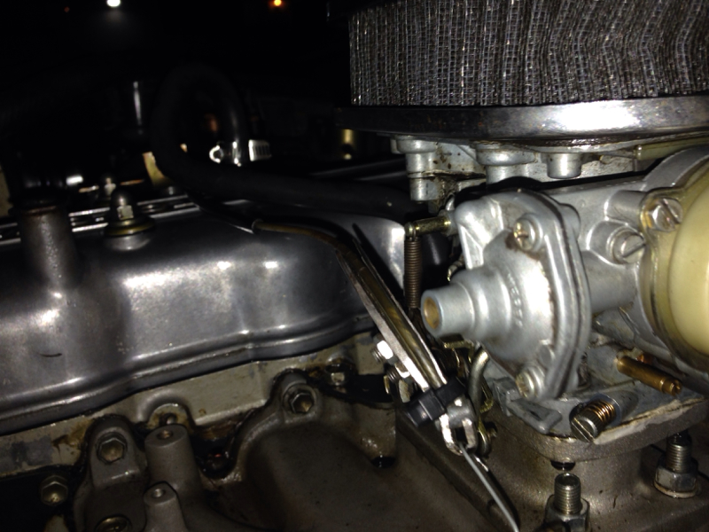

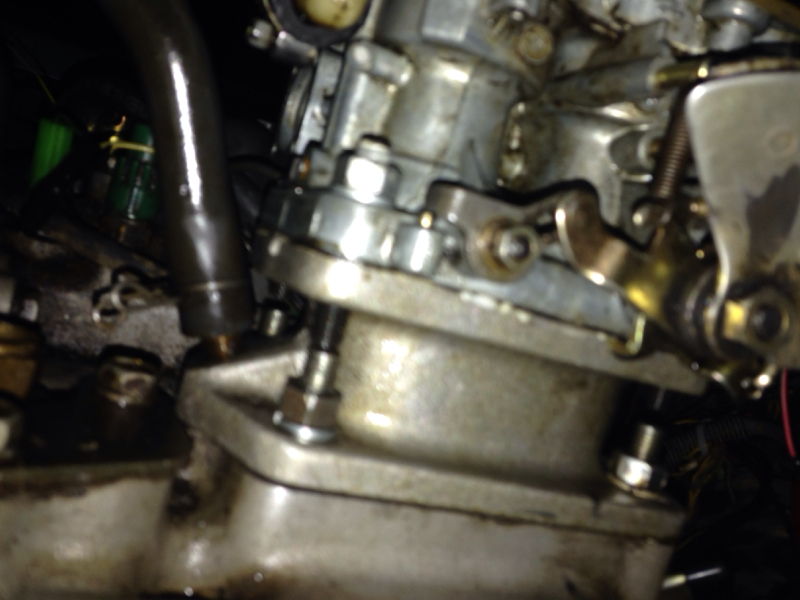

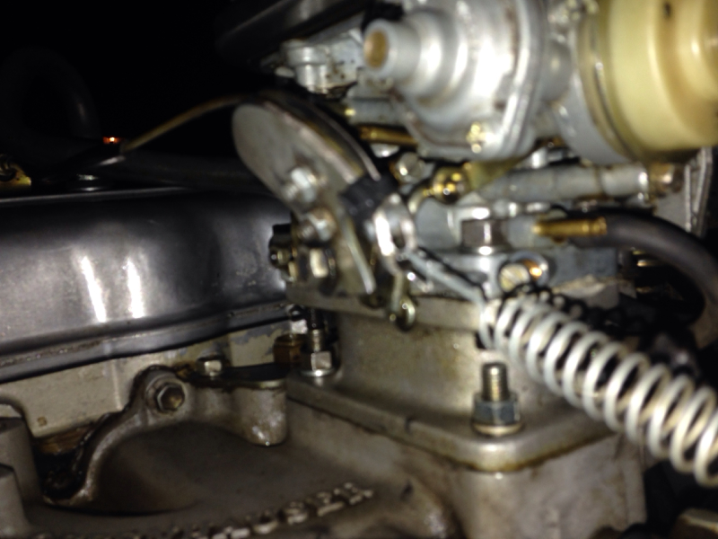

Here's some picture of my 32/36

From the looks of your pictures you're throttle cable mounts on top of your valve cover? If so the spacers they're talking about will not be used for you. If your throttle cable mounted on the intake there are two little spacers to set the bracket up to the height of the carb

There should be two holes immediately behind your carb on the intake for your stock linkage mounts. It looks like the linkage you have has been chopped a bit? I would suggest the toyota linkage adapter from weber and make a spacer for yourself that will mount to those two holes and put your linkage in line with your carb.

i used 5 washers (to cheap to buy an adapter and my washers work just as good), two closest to the block and 3 on the carb side of the bracket.
