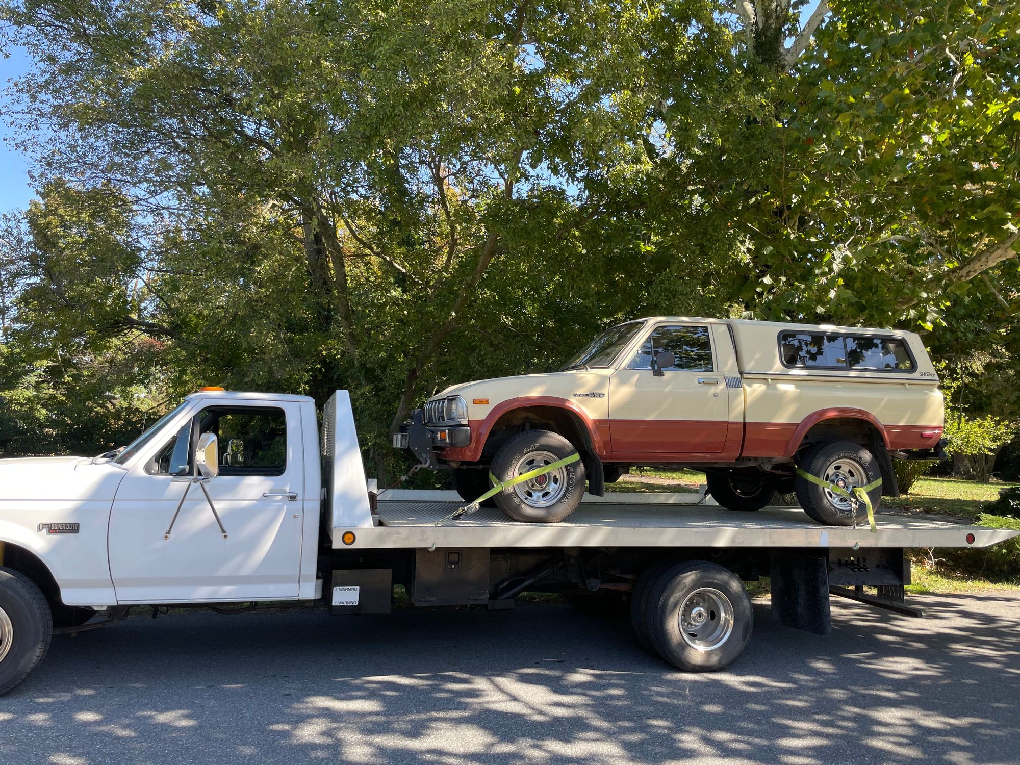

Enter the diamond in the rough I just bought. I stumbled upon an autotrader ad for this '83 SR5 that was within driving distance from me. Seemed like it could be too good to be true, because from what I've found (or not to this point) there are not many good all original pickups left in the north east area.
While negotiating and chatting with the seller over the last few weeks, I began googling (and joining this site) to try and learn anything and everything I could about the 81-83's as it seemed as though there was a chance I'd be able to get my hands on one. Then... by chance, I found this. https://dailyturismo.com/auction-wat...ota-hilux-sr5/
Read through that link for more details on the truck and its condition.
This was the same truck. Had to be. The giveaway, other than the color and snugtop was the winch and the Warn sticker on the back of the cap. Here is how it sat when I found it:

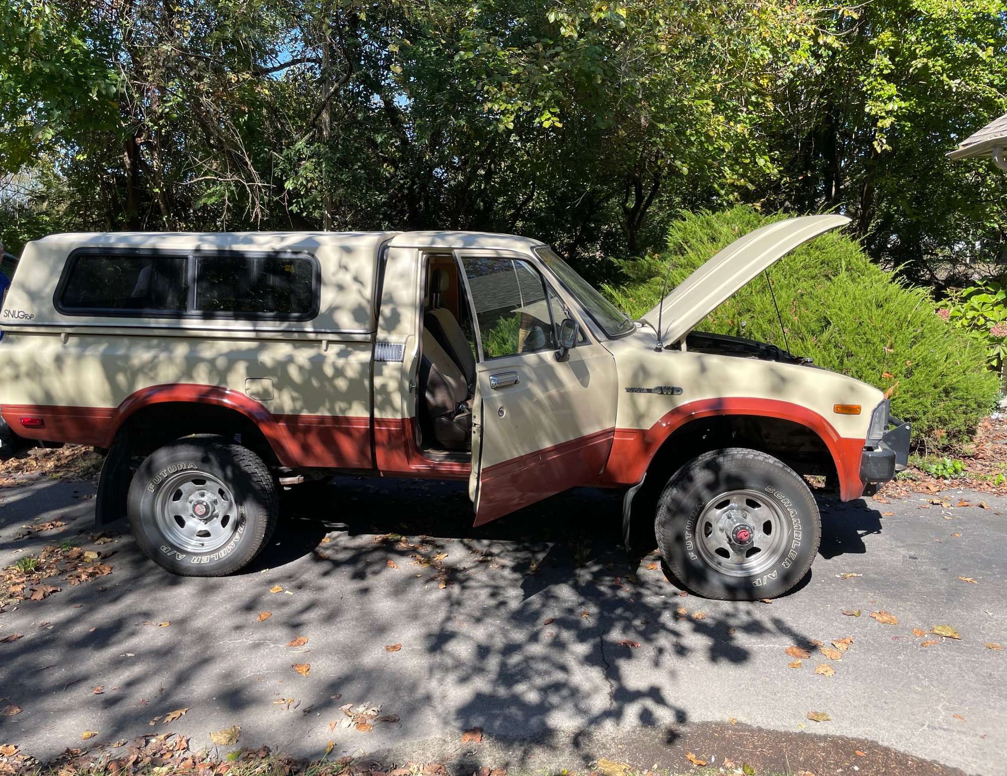

Unmolested, but dirty and dusty. Musty smelling, had some mold on the passenger seat. Doesn't run great. But this was the truck I've been looking for.
After seeing some dew on the windshield in the morning it looks like the windshield gasket by the passenger side lower corner may be leaking. This could easily be the cause of the smell/mold.

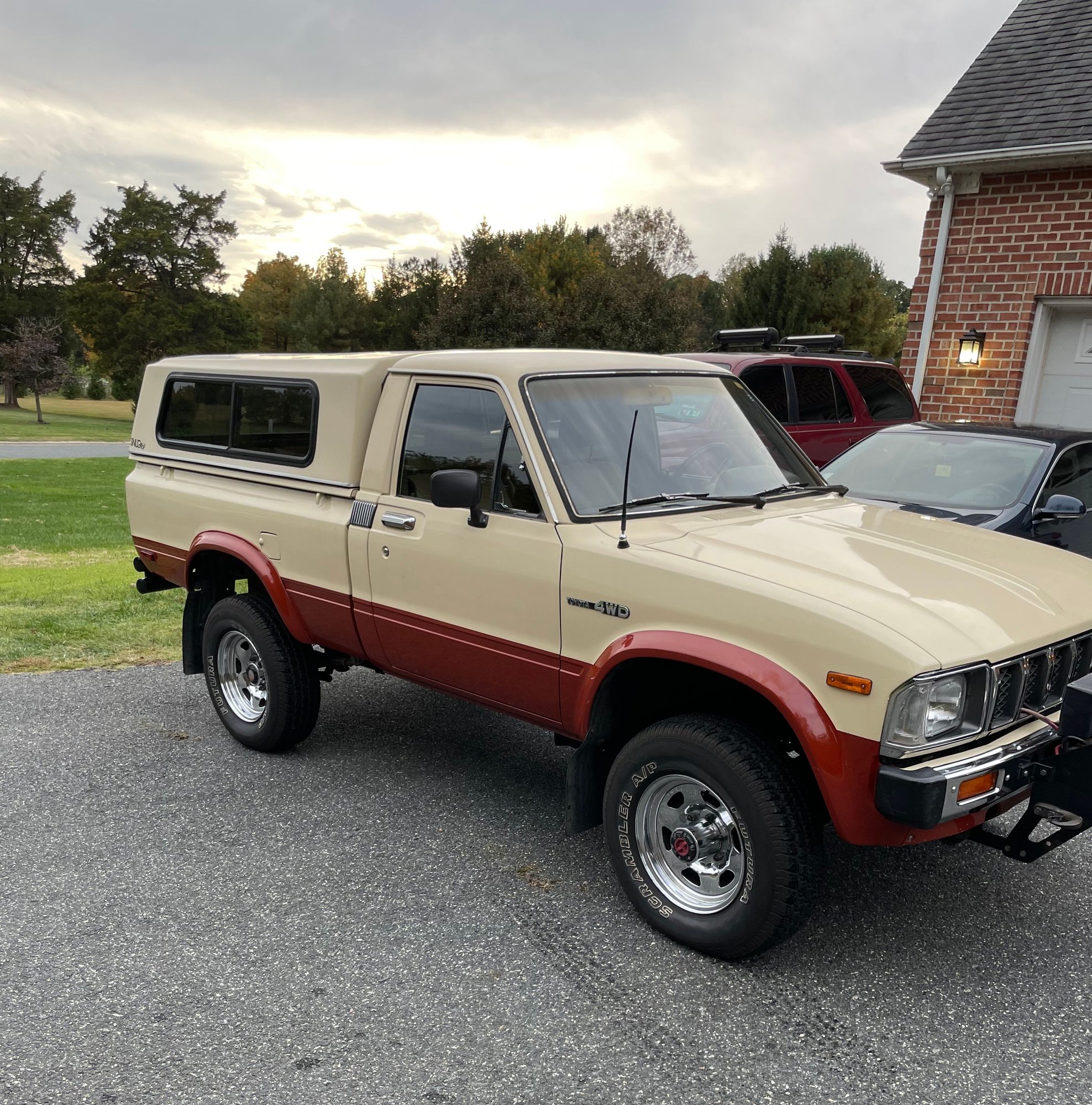

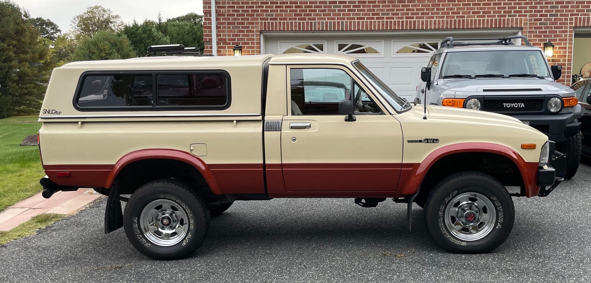

Once I got it home, my brother in law and I did a detail on it, and it cleaned up great. I cut the cat out, as it was running terribly and after a few minutes the cat would glow red. I am going to replace the entire exhaust system but if I had to guess (PLEASE correct me if not true) but when new, there were no cats on these trucks. It even had what appeared to be a botched weld job to add it, assuming because it was a CA car for the majority of its life.

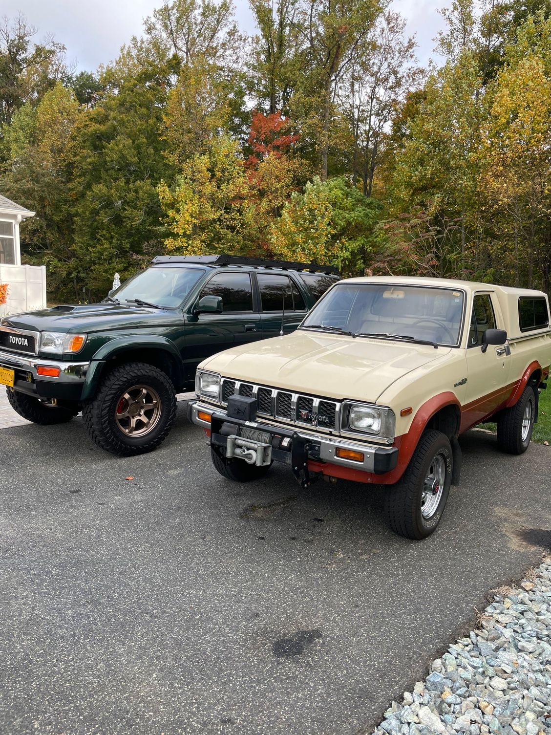

The morning after I brought it home (and a chance to whore out my 4runner)

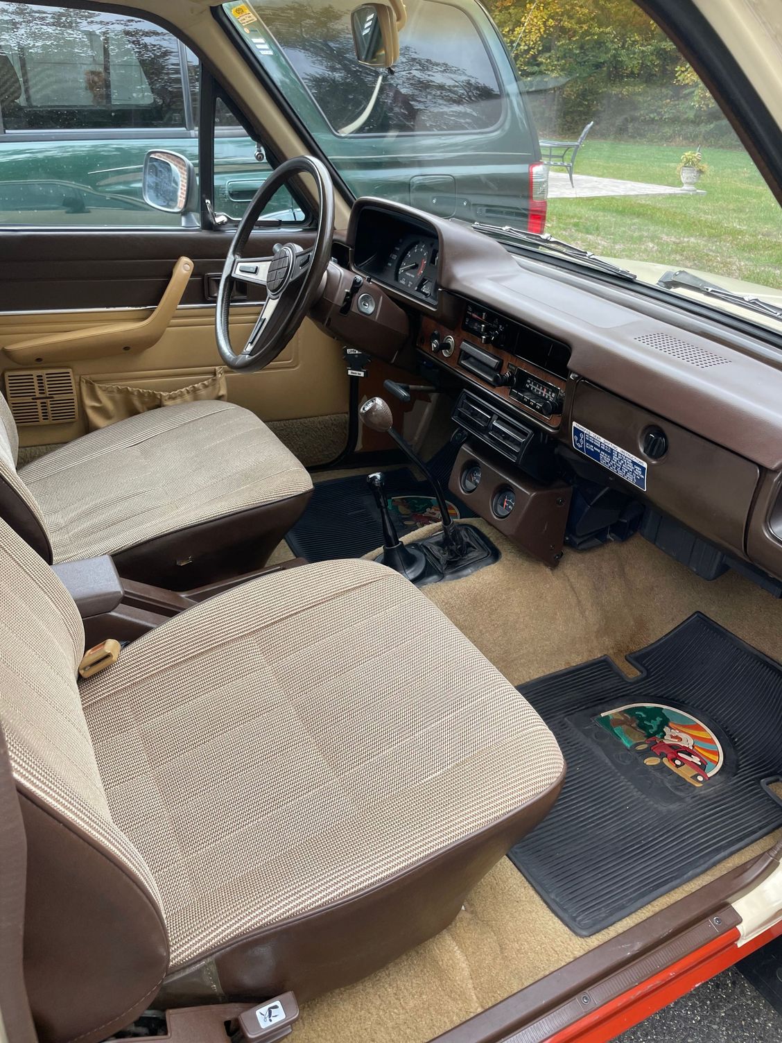

Here's how it cleaned up.

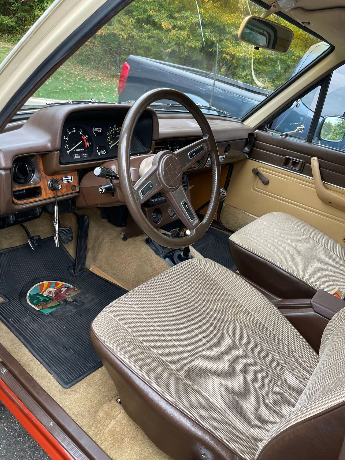

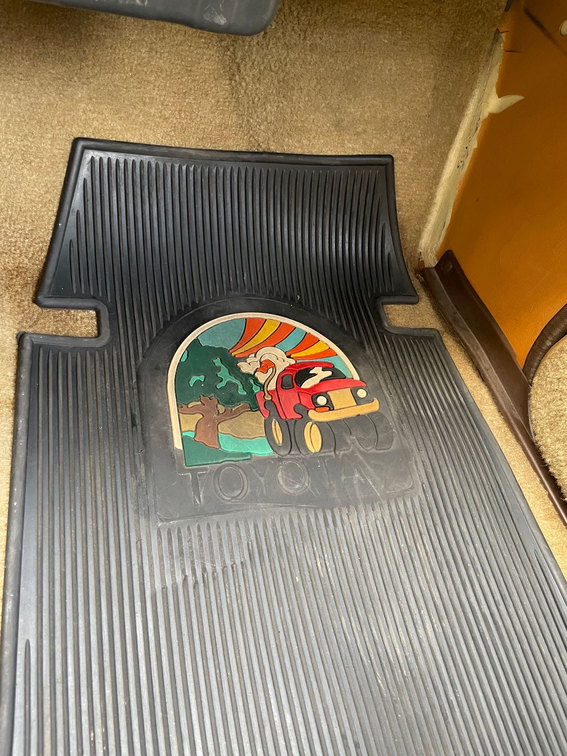

Anyone have any info on these floor mats? I think they're cool as hell. Original? I can't seem to find anything like them on the web.
Lastly, from what I gather on the web - the OE wheel width is 7"? Any fitment issues with a 31x10.5 R15 KO2 or Grabber AT?

That's a hell of a truck! Looks almost factory fresh. Your dash pad, seats, and door cards are mint!

Those floor mats are not factory Toyota, but they are 80's period correct and you need to keep them in there because they're baaaaad asssssss. Tasmanian Devil or Tweety Bird mats were also pretty popular.
I currently have 35x12.50 mud terrains on those wheels with no issues but I'm probably pushing it. 10.5 should mount no problem.

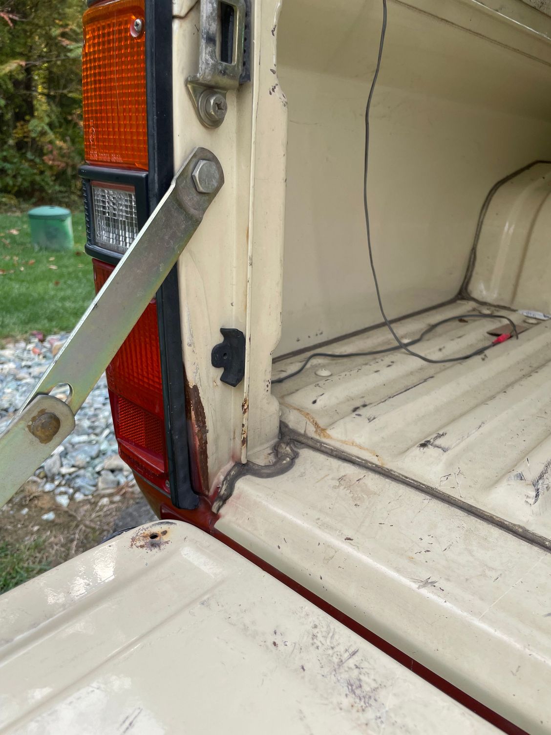

Check for rust in the cab corners where the front mud flaps screw in. That is the most common place to find trouble underneath the carpet.

After a thorough inspection this is legitimately the only spot on the truck with rust from what I've found. INCLUDING the entire frame and underside. Pictures don't even do it justice, I promise. Most will not believe the age and condition of this truck as it sits.

That's a very clean find from the pictures. It looks like someone has re-seam sealed the inside box seams...check these very carefully as this was (is) a bad rust spot. It looks like the "kick panels" in the cab have been kicked and broke and that someone has caulked them to the carpet. These are no longer available. I made mine fro ABS sheet. I believe "Slacker" on this site makes them in fiberglass; I can't re-call his business name off the top of my head. I actually hate the OEM antenna! So "only" owning mine for 40 years I've forgot more stuff then I can recall but to your questions...
