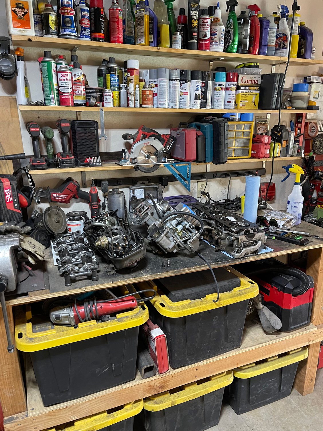

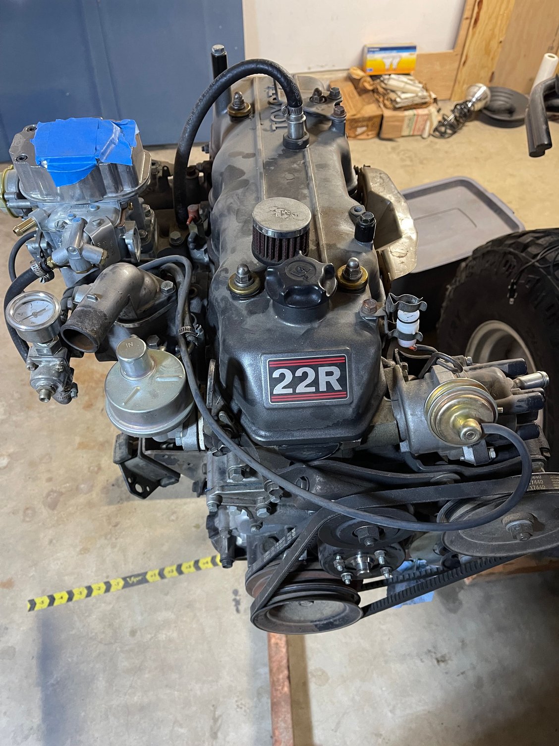

I re did a compression test with a brand new tester and found
1:80
2:120
3:120
4:120
so I re checked again and sure enough I knew I had a dead or sometimes dead number one cylinder. When I had pulled the plugs I 1 was also wet like not burning fuel. Then randomly father gifted me with a bore camera and I noticed some scratches on the cylinder walls. So this Easter I pulled out the motor and tore it all down. I was skeptical after looking at the cylinder walls because it was not that bad. Like a lite hone would fix it up so I flipped the head and got a cup of gas and poured it in. Sure enough it leaked out through the intake valve. So I tapped it and then I sealed back up??? So where I sit is I’m going to call to see if I can get a shop to completely go through the block and bore and deck and clean it then do a full bottom end rebuild. I’m hoping I can drop it offf at lce. But I did notice the head has a small crack from someone over tightening the bolt for the intake…. Probably me. And with the leaking valves im thinking it’s time for a new one plus cylinder number two has seen some debre floating around. But I can’t seem to find a head for and 82 22r lce and other sites only show 85 being the oldest?
