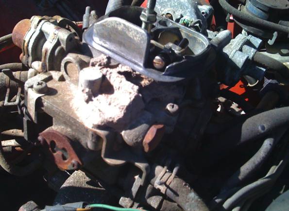

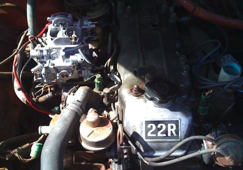

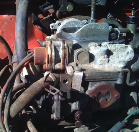

it is on a little tag hanging from the front. or so I found. I didn't send them my carb number when I ordered it. They only listed one carb for me 83, manual so I took a chance
I haven't had a problem yet. I have put about 50 miles on the carb so far and everything seems good. I am attaching some pics. Sorry about the quality but the upload size limit on here kind of sucks.
the first two are my old and the last is the new.

Holy ##$%&*!@#$%^&&**^%$ you seriously wondered what might be wrong with your carb! That thing's crazy! I'll bet there's some improvement!
