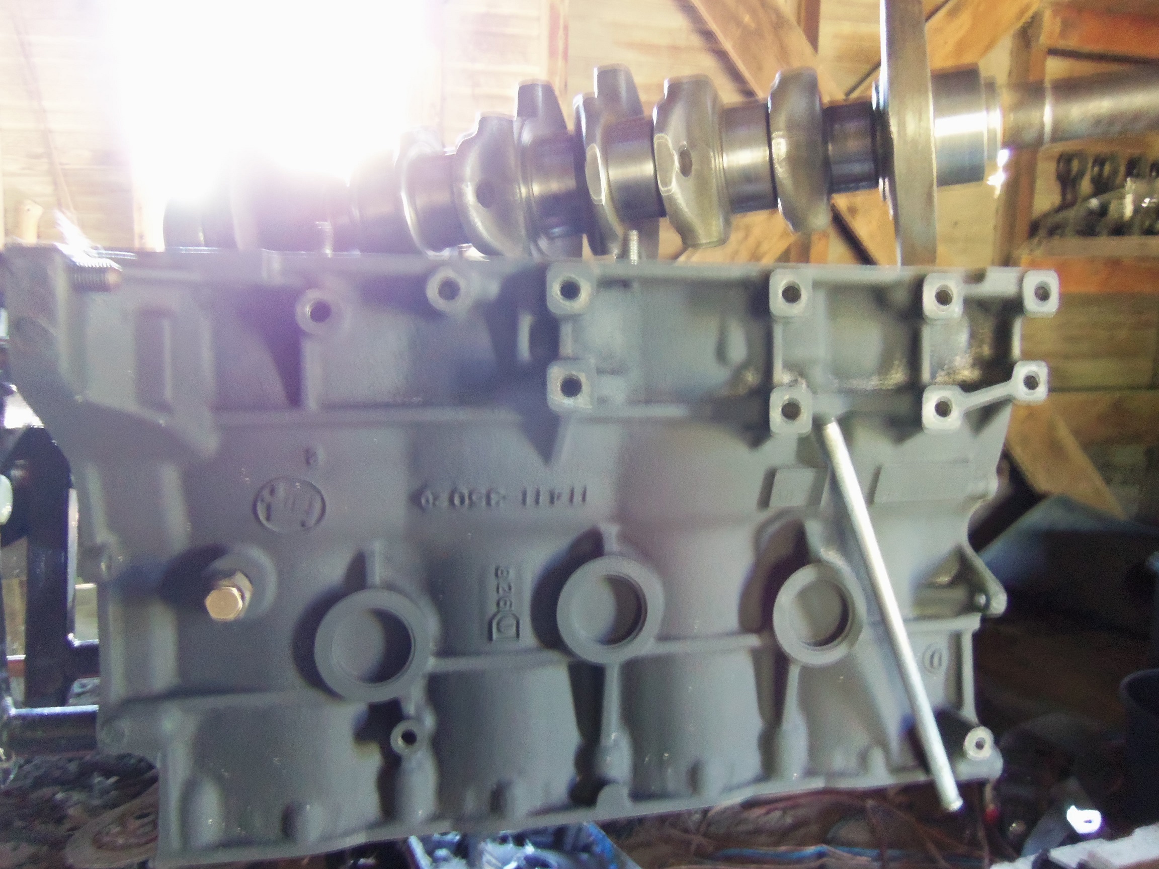

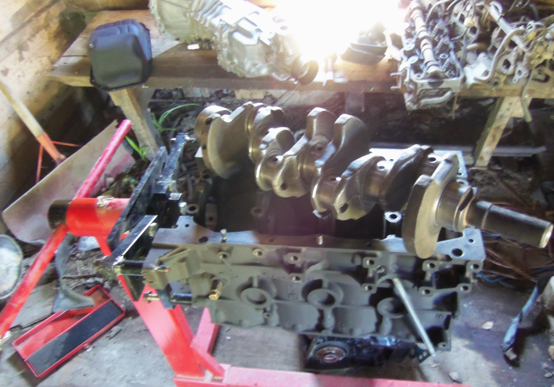

Oh man, thank you for this post! You have no idea lol! I posted some pictures of the 22R I am re-building from my '85 2wd pickup. Just so you know what your engine would look like if you were drunk and didn't know what you were doing! Hic! You are doing great work and you answered a TON of my questions, I seriously can't thank you enough.

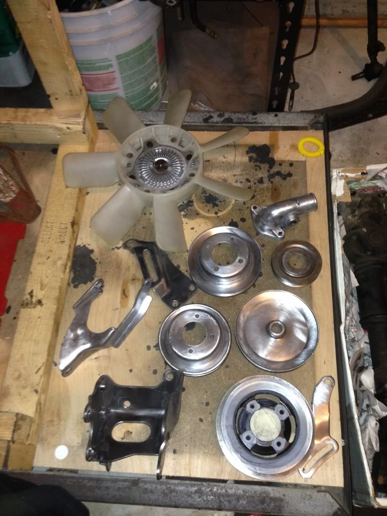

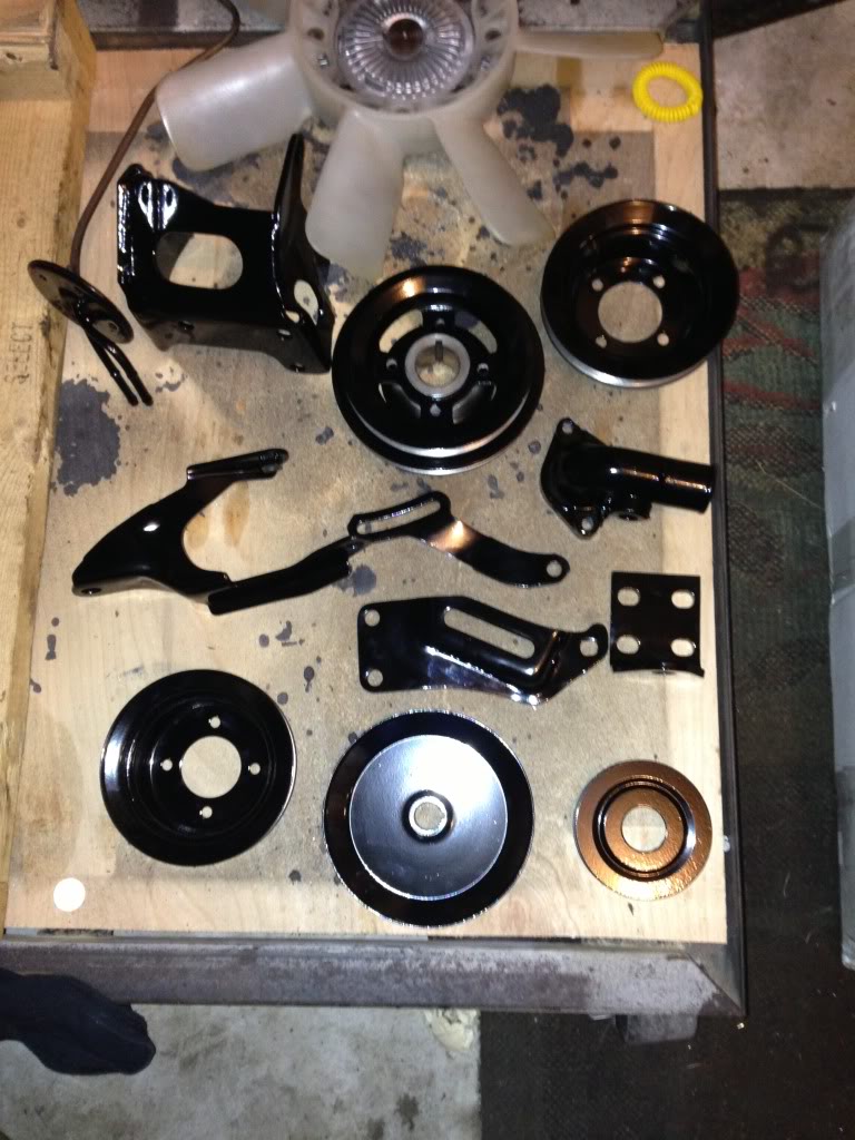

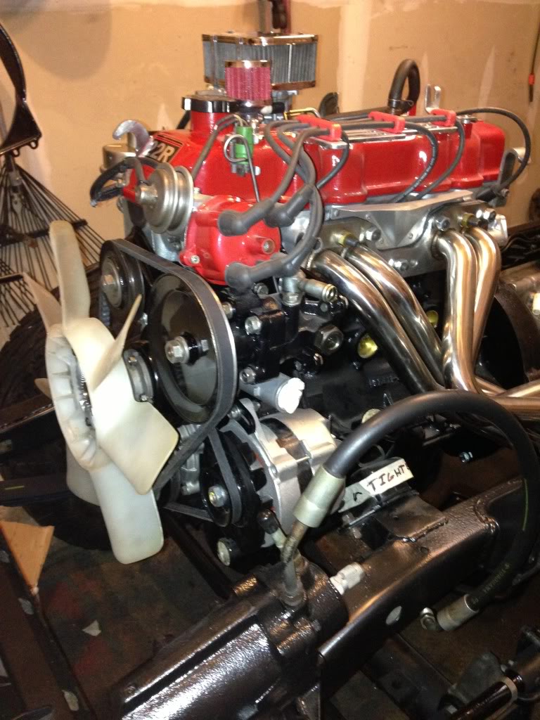

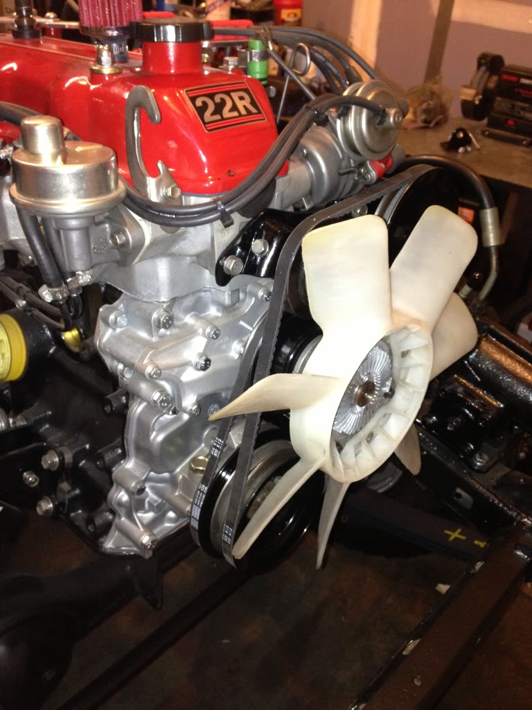

Well I decided to take all the engine pulleys and brackets off to strip and powdercoat. In case some of you don't follow my build up thread, I bought a powdercoating kit from Eastwood a while back. So I wire brushed the paint off of all the engine pulleys and brackets - The duplicolor high temp paint that I used was crap so it went fairly easy. It's kind of depressing knowing that I spent so much time and money prepping and painting the parts, but the powdercoating will be well worth it - they'll last longer than the motor and we all know that will be a long time given the longevity of 22R motors!
Took everything off, AGAIN...
Paint stripped:
Powdercoated gloss black:
Re-installed:
In all, it took about 6 hours of work to disassemble, strip, powdercoat and re-install. Well worth the effort and what I love about powdercoating is that once the part cools it can be put into service immediately. No more waiting for paint to dry!

Originally Posted by Roark
On this last post, how did you strip the paint from your pulleys so quickly>
Just used a 6" wire wheel on my right angle grinder. The grinder has a locking trigger so I set the grinder in my vice and work the parts on it.

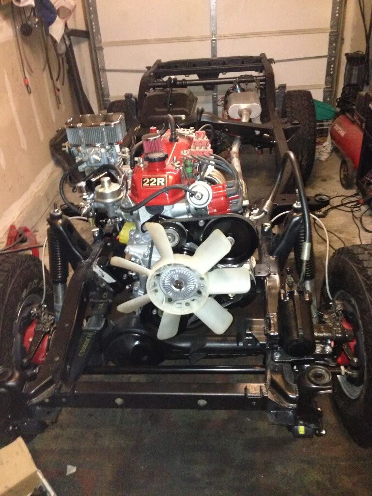

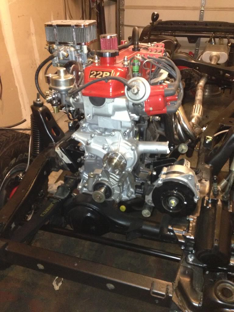

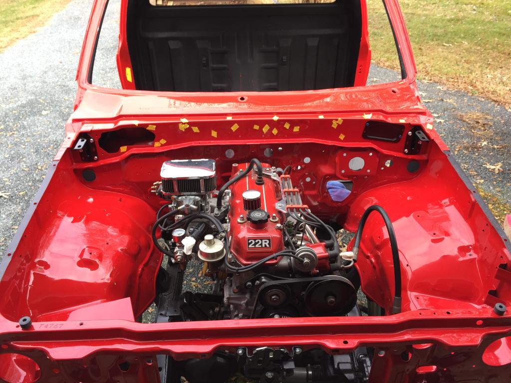

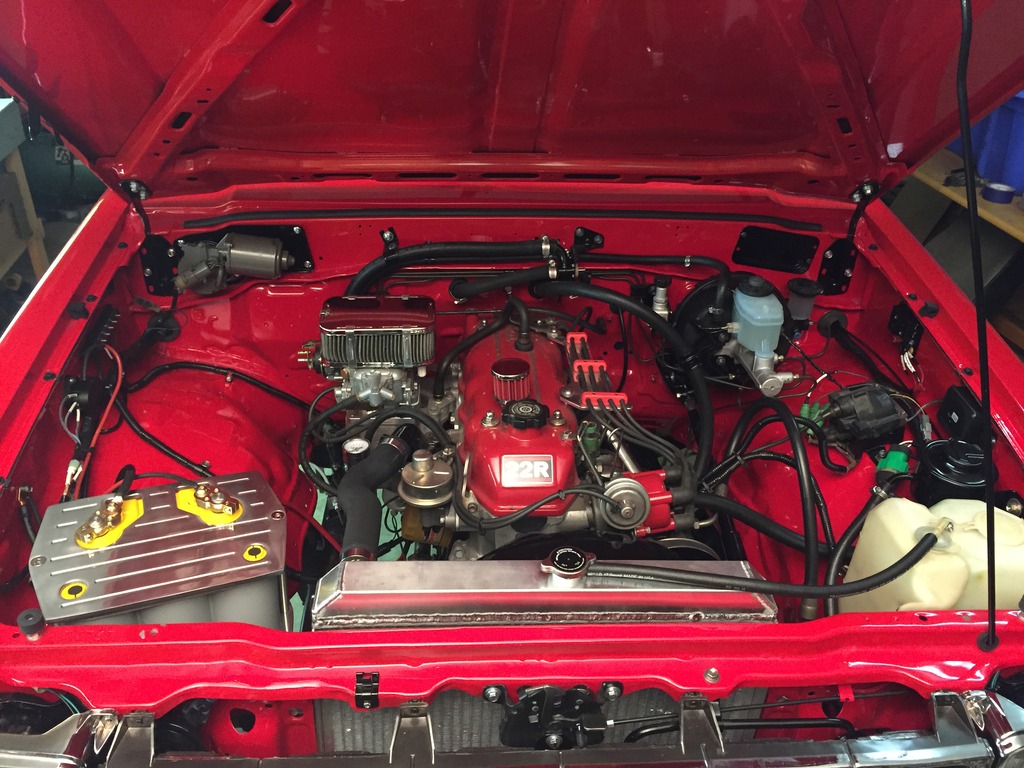

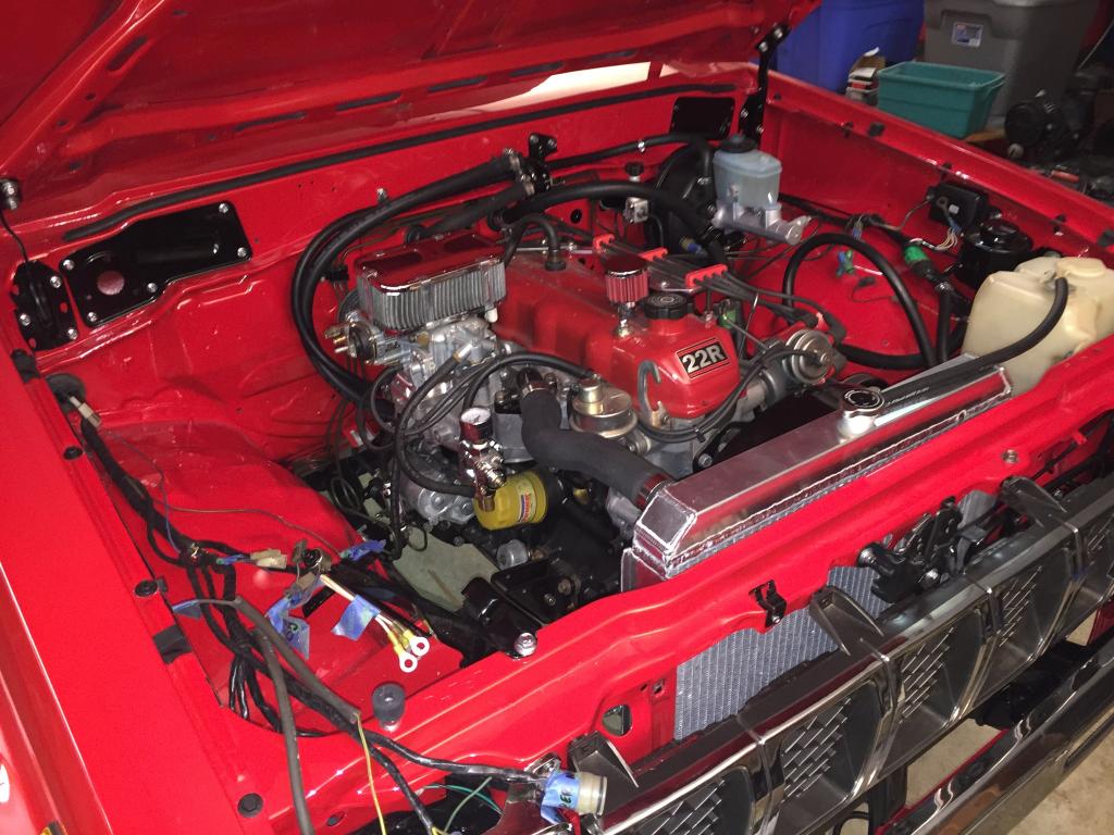

I am wrapping up my truck's restoration so I figured I'd post a couple of the engine's final resting place here as well as some pictures of the truck.
Pre-wiring and plumbing:
Plumbed and installing wiring:
And ready to fire:

Where did you get the aluminum radiator?
Old May 13, 2015 | 01:04 PM
  #58
kawazx636's Avatar
iTrader: (3)
Joined: Jan 2012
Posts: 3,218
Likes: 26
From: Salisbury, MD
It is a Silla Radiator that I got off eBay. It is for a 84-88 pickup, but fits perfectly with no modifications
