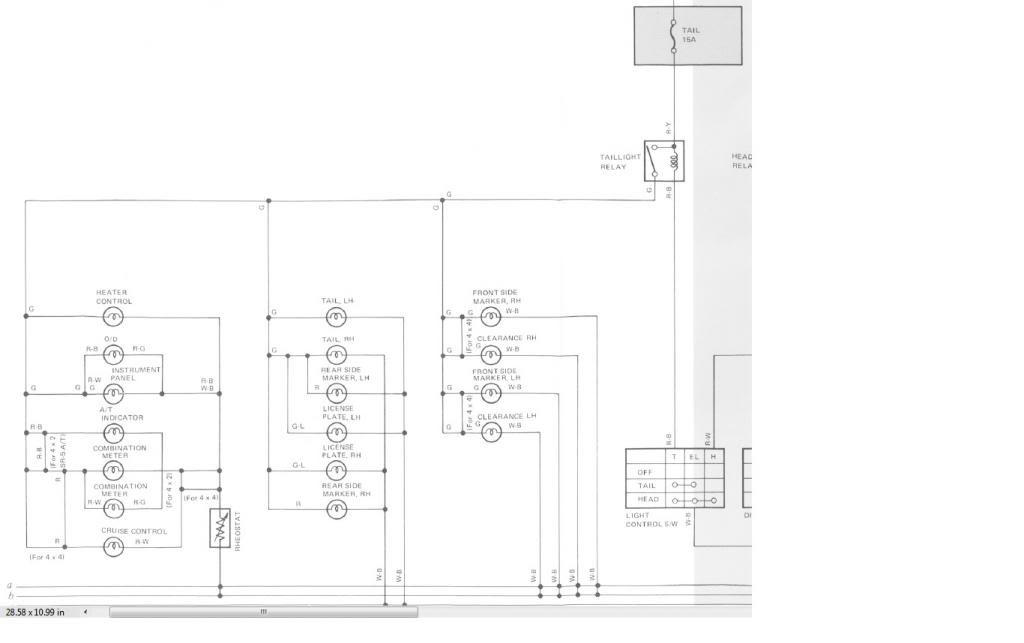

Here is a screenshot of the wiring for the dash back lights. looks to be controlled off of a "tail light relay".
Maybe you could look for that relay and see if the relay works and if its is getting power to it.

Ok, so after getting home and doing some more digging into this, I'm sure it has to do with 32 years of my life.
I had disconnected some wires from the fusebox when I took the dash out. ANd some are dangling loose.
But before the dash came out, they all worked fine, except one tail light that was out when I pulled the camper top off in mid 90's. It had a brake light wired into the left rear brake wiring at a shop.
Basically now, my headlights work, and the red lights on the dash.
The rear tails/brakes are out, the dome light and any light basically except the headlights.
But now, I'm not sure what goes back where.
They were just pushed into a fuseholder and made to work. And, I think one was screwed to a frame bolt as a ground. Sounds simple to just duplicate, but it's not.
Here's why:
I've had 1 rollbar with two KC lites and a back light suspended.
I've had a camper top with inside lights wired into it.
And the camper top also had a brake light in the rear window that was wired into it.
And I've had two sets of fog lights on the front bumper at different times.
In addition to the jumble of wires that I had ran to the radio and equalizer and additional Jensens behind the seats.
Some of those wires, I, in my stupid youth..ran.
Some, not, they were ran by a professional. They're coming out of the crevices and cracks on the bed and ran under the carpet and around the steering column and everywhere, lol. Duct tape.
And, once when a drunk ran into me and I had the whole thing repainted, the wires running between the truck and bed both got painted blue.
I'm not sure what's ground, what's hot, what a speaker, whats a brake, what's a backup.
So....it's a hot wirey mess right now and to be on the safe side and clean that up, I'm going to get someone else to figure that out when it's trailered to Billy's garage next week for the carb and brakes.
