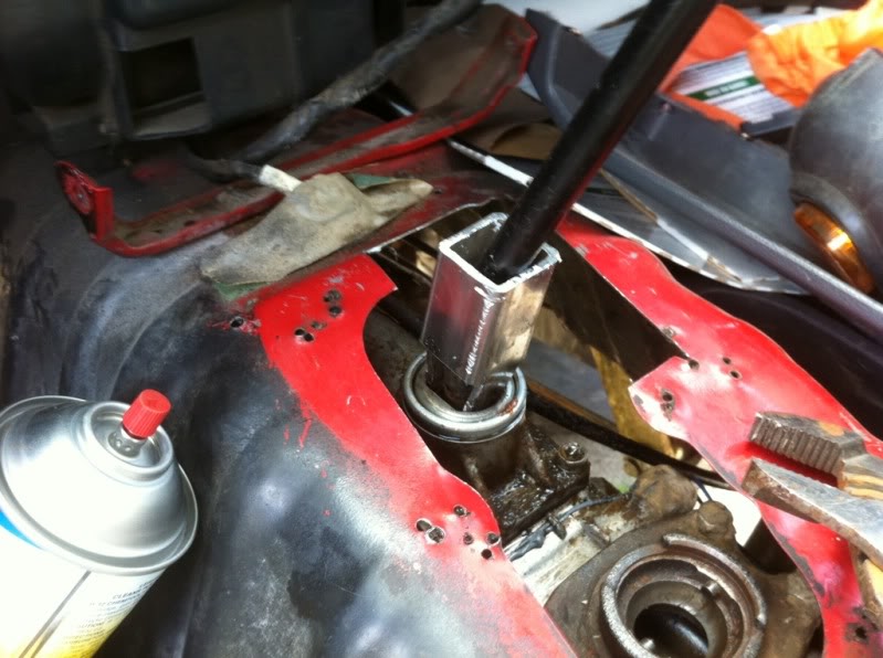

OK, ancient thread but i thought i would update this thing with what I made a month or so after posting this thread
Originally Posted by dropzone
Poor Man's shift lever retainer removal tool:
here is a pic out of the manual that shows the SST:
since i had the idea of using an old socket or some tubing I thought I would give it a shot. 6 minutes with the grinder I had this:
1" square tubing, notched and bent in slightly to fit in the shifter retainer
slip it over the shift lever
use your tool of choice, push down and turn to the left about a 1/4 turn
bingo:

About time
Good info, would be easier on the fingers.

I took a large pair of reversible snap ring pliers ground a notch on the outside of each leg. Push and twist
