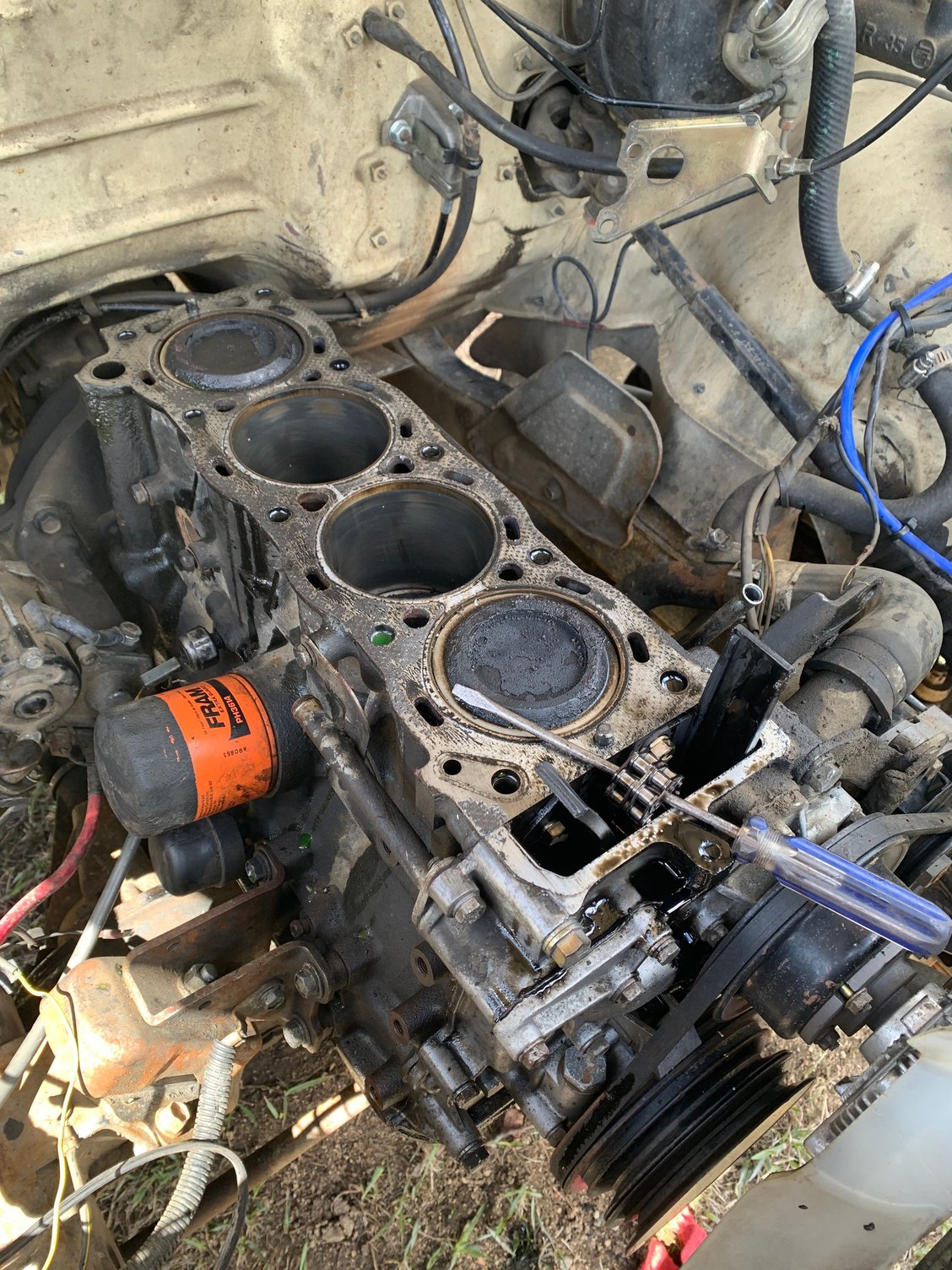

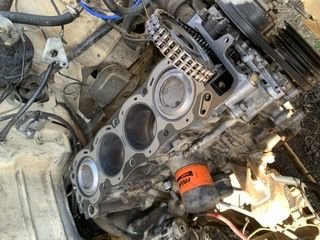

Because I am not an engine builder, rather learning as I go, here are a few shots of the block with head removed. Do that look like glazing to folks? Enough to be letting a quart of oil sneak past, every 400 miles or so?
All carbon’ed up after first pulling the head
Cleaned and ready to go back together

Youd need to get in closer for us to see the pattern on the cylinder walls.

Unfortunately when I had the head off, I didn’t think to take any close up shots of the cylinder walls. Truck has been down for a little bit while I rebuilt the front axle, but now I am driving it again. Did a piston soak with B-12 while it was on jack stands, thinking at least it couldn’t hurt. Switched to 10w-40 and still seeing no change in oil consumption. Still need to get the OEM PVC, though I don’t have high hopes since after installing a breather in place of the existing PVC on a test drive, it still produced the same volume of smoke, under the same circumstances. Looking more and more like a rebuild is in my future ...
