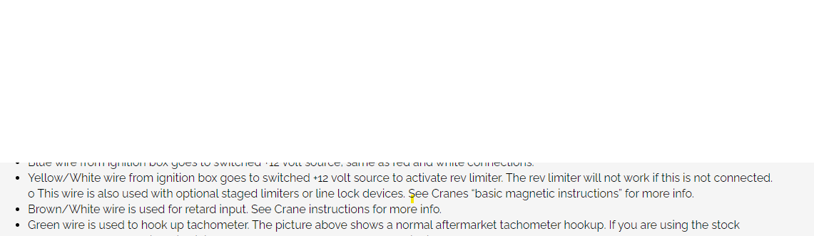

Originally Posted by coldenfilms
Did this end up working for you? I have a 1986 Toyota pickup with one in it. No matter what I do with the rev limiter dials the truck cuts out at 4500 rpm.
I found this in the instructions for the ignition kit:
Source: https://lcengineering.com/part-10820...-instructions/
I would assume from this that if the Yellow/White wire isn't hooked up to a power source, the rev limited would be disabled.
