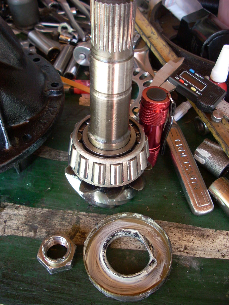

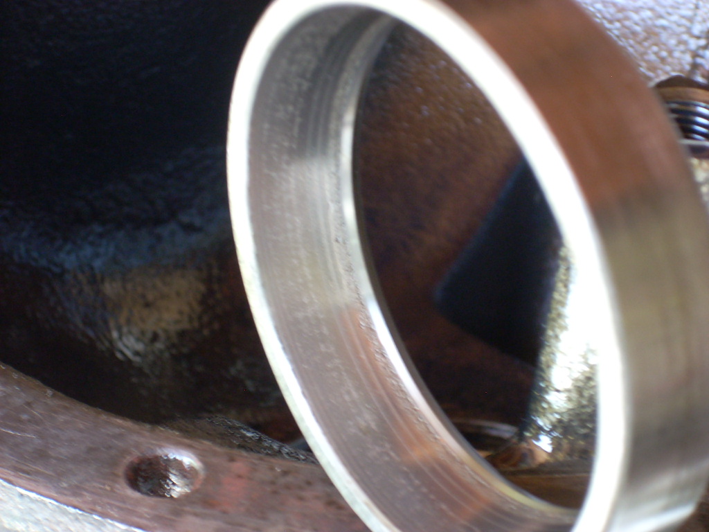

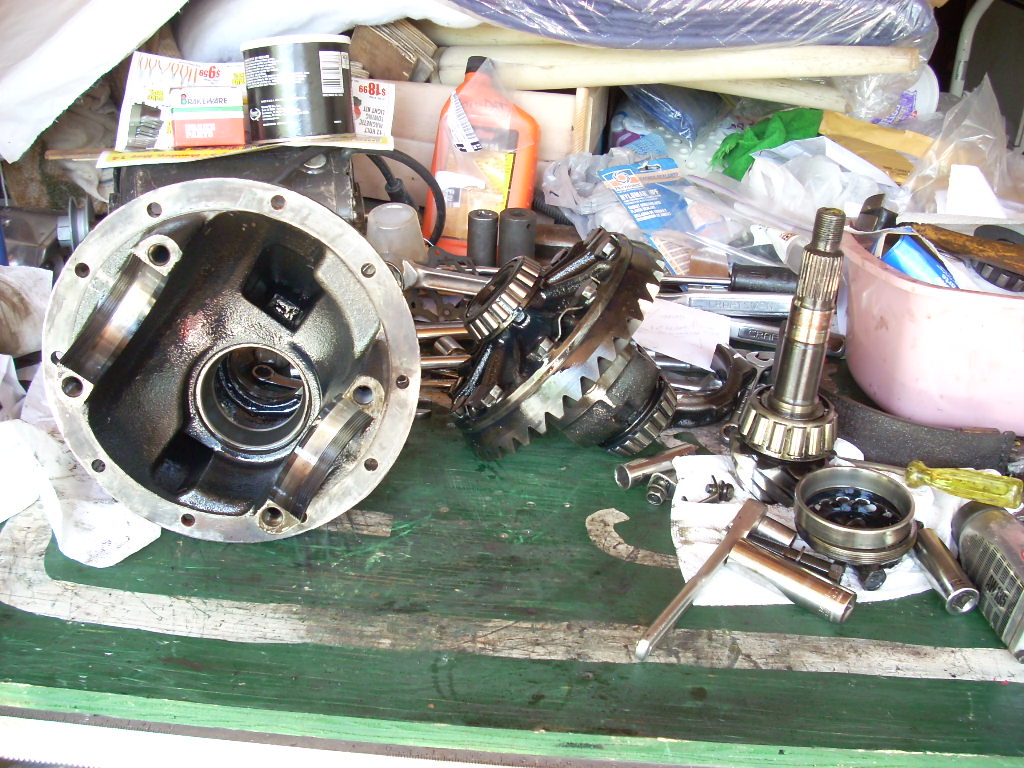

If your not just throwing it in there? I'd check preload to 7.8 to 11.3 INCH lbs. I set my ring & pinion lash to .007 but ended up with .005, I wouldn't go tighter than that and check throughout the full rotation of ring gear.
I ended up with a lash of .005 because my bearing race was spinning on pinion shaft so used locktite 620 to bond it to shaft but it sets real fast. As quick as i was, getting all the shims and such on buy the time I got the torque right it was setting up and couldn't pull it in any farther, good enough and didn't have to buy a new R&P set. The 620 is removable with heat and a press.
Pics to add some eye candy
Not needing to be perfect I saved some $ by replacing ring gear bearing races but kept the bearing rollers as looked good plus didn't have to pull or press bearing except for pinion big bearing.
