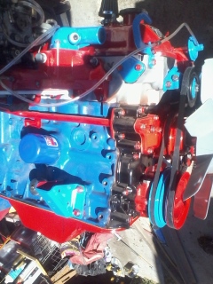

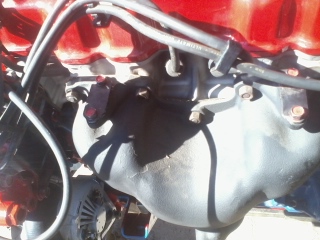

20R de-smogged!
Old Oct 22, 2013 | 06:28 PM

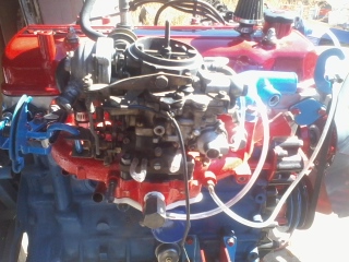

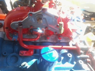

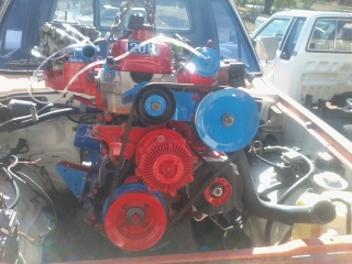

20R de-smogged!
Old Oct 23, 2013 | 08:13 AM

De-smogged 20R
Patriotic it is! I even managed to sneak a little white on the starter and alternator plus some gray on the fan. Ran outta green. I might have got carried away with the rattle cans!!! I fired it for the first time today. Still working on the timing but other than a high idle it runs good. It has the RV cam so that may ad to my tuning drama but I am driving it 1,000 miles tomorrow night so I better get on it! My next project is a 22R with a 20R head, RV cam, Weber and a header, also de-smogged. After that I have a 4x4 with a 22RET (turbo) to rebuild, maybe a few more 20R's too!

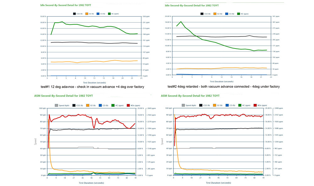

i have 82 22r - partiality de-smogged - Tho i need to pass smog -- here in canada -- lower smog standards Than California with a weber carb ( EDITED /CORRECTED idle mix 2.0 turns out idle 1.5 turns in after touching linkage) 2 vacuum lines for distrib advance... see pic attached for routing of vacuum lines FYI that i found on line that seem to work well :-)
EGR valve not functional - not hooked up
air pump functional - not hooked up
air injection on exhaust manifold - capped / plugged
I'm passing flying colours on all fronts by miles -- BUT NOT on N0x I'm running 12% over the MAX limit at speed test... idle test is cool as well...
catalytic converter is unknown years old..
so to my question =
part 1) if i hook up the air pump directly to the exhaust manifold do you think that it would drop my N0x by a min of 12%
part 2) if i buy a new California catalytic would that give me that 12% +++ reduction on N0x that I'm looking for ?? tho that will come at a 200.00 price tag... but i just might have to do that... and i would if it was VERY likely to solve my N0x problem... your thoughts?
part3) I'm aware that High N0x is caused by high combustion temperatures - which can be attributed to running too far advanced on timing, running lean...ect -- anyone have any experience with installing larger jets on the weber ( not the idle ones) to richen the mixture - and there by possibly lowering combustion temps -- tho with the possible side effect of raising all the other emissions -- catch 22???
all the valves and vacuum switches are removed ( previously - not by me) so hooking up the EGR circut will be very problematic...
you can see my smog test under 2 different setups see bottom for picture ...maybe that will be helpful to others.. :-)
the LHS pic is test #1 the uneven red line N0x was caused by the tech doing the test - dropping speed to near the min required ( sub note there was a one way check valve in the vacuum advance ( normal advance "ported " i don't know why... holding the advance on the distributor) the idle advance was capped and plugged)
test #2 on RHS had both vacuum advance hoses connected
thanks in advance...

The fact that the idle mix screw is turned 2.25 turns out to run best shows that you are running too small jets on your low circuit.
