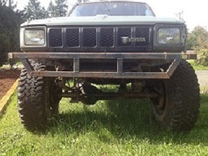

Picture test. First try.
Attached Thumbnails A couple steering questions (read plenty of threads)-img_0942.jpg
Old Jun 20, 2012 | 08:56 PM
lancelincoln's Avatar
Joined: May 2012
Posts: 48
From: Olympic Peninsula, WA
Ok, trying again, haha.
Looking pretty blown out.
Hoping the knuckle rebuild helps.
Possibly can't tell, but the center link is bent.
Plan on painting a solid color as well, just not sure what yet.
I am keeping the tailgate with the "MENS" sign though!
And finally, never saw one with the speaker grill still in tact, let alone zero cracks in dash.
If this worked, I will post pics of the rebuild and such as well.
