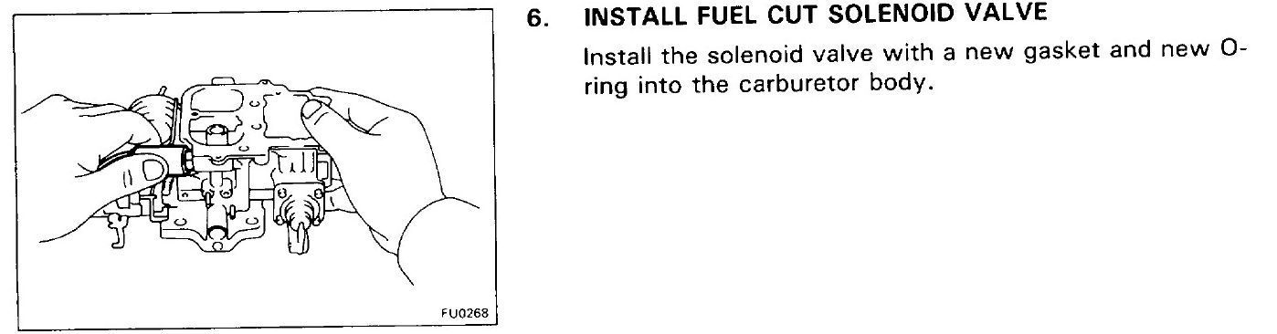

Check the operation of the fuel cut solenoid (see diagram). You can pull it off, and connect it directly to the battery to verify operation. It has a tapered pin , which is drawn back into the solenoid's body when voltage is applied, as it is when the key is in the Run position. The pin is allowed to return forward, into the carb body, when the voltage is shut off. Check that there is voltage on it's plug with the key in Run, and none at any other time.
When the pin is in the carb body, it shuts the fuel supply off, and when retracted, it allows the fuel to flow. It's main purpose is to prevent dieseling after shut down of the engine, but it also prevents the siphoning you're seeing.
Solenoid is gripped by the fingers in the picture.
BE CAREFUL!!!
The pin is driven out of the solenoid body with great force. Keep body parts, like fingers, well away from the pin!!!
Is this any help?

I put a new one in a couple of years ago. I’ll definitely check it again. I may need to look at a drawing of how the low idle circuit runs, but I’m having a hard time thinking how that would cause off engine flooding. Not saying it couldn’t though. Thank you.
