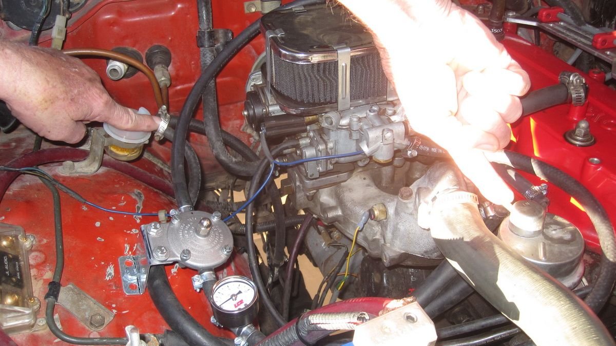

I am in the process of hooking up my fuel regulator/pressure gauge that I received from LCE engineering. I have them hooked up correctly, I believe from the fuel pump to the carb, but I am only getting 1 1/2 psi. This does not change with any adjustment to the regulator. I called a tech at LCE and he believes it is possible that the fuel return line and line to the charcoal can is misconfigured. Not sure how that can be because I have had the truck 7 years and it is the same configuration as when I got it. Here are some pics.
So above shows the line from the fuel pump tube closest to the manifold to the carb with the regulator/gauge in between.

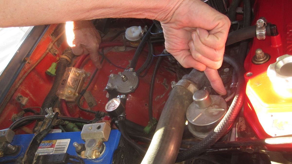

Here you can see the top tube on the fuel pump, which was marked "IN", goes directly to the charcoal canister.
And the middle tube on the fuel pump goes directly to the gas tank.
Again, other than inserting the new regulator/gauge, the fuel regulator hoses are configured the same as it has been since I bought it.
Can anyone add some insight to this problem so I can get my 3.5 to 4 psi pressure to my carb?

I am not able to find any diagrams online showing the normal hookup to the fuel pump. I guess my immediate question is this. Does the fuel return line go directly to the gas tank, or does it have the charcoal canister inline? Right now, the charcoal canister is inline from the gas tank to the "IN" input on the fuel pump. If it is correct that way, I suppose I could have a bad diaphragm in the fuel pump that is not allowing enough pressure to the carb. I removed the fuel regulater temporarily to check the pressure from the fuel pump to the carb. It is showing about 1 1/2 psi. I pinched the return hose to block return flow with some pliers and the gauge reading was just over 5 psi. When I released it, I returned to about 1 1/2 psi to the carb.
Any help with this issue would be greatly appreciated.

Are you calling your fuel filter the Charcoal Canister??
Why do you need a fuel pressure regulator??
Not sure just what your trying to do here.
But a pressure gauge should be on the pressure side of the pump to measure the pressure going to the carb.
the 3 fuel pump connections.
You have the fuel in which would come direct from the fuel filter.
you then have the return line going to the tank.
you have the supply line going to the carb.

Thanks for your reply. Yes, that is a fuel filter. The tech I was in touch with insisted that was a charcoal cannister which began a lot of my confusion. So I believe everything is hooked up correctly.
The fuel pressure regulator is recommended for the weber carb to reduce the pressure to 3.5 to 4 psi. I have this along with the pressure gauge on the pressure side between the fuel pump and carb. The pressurei is only 1.5 psi. So it seems I need to either replace the fuel pump or possibly plug the fuel return outlet, which when I tested gave it the 5+ psi pressure. I have actually read on this forum that plugging that fuel return outlet is suggested when used with the Weber carb.

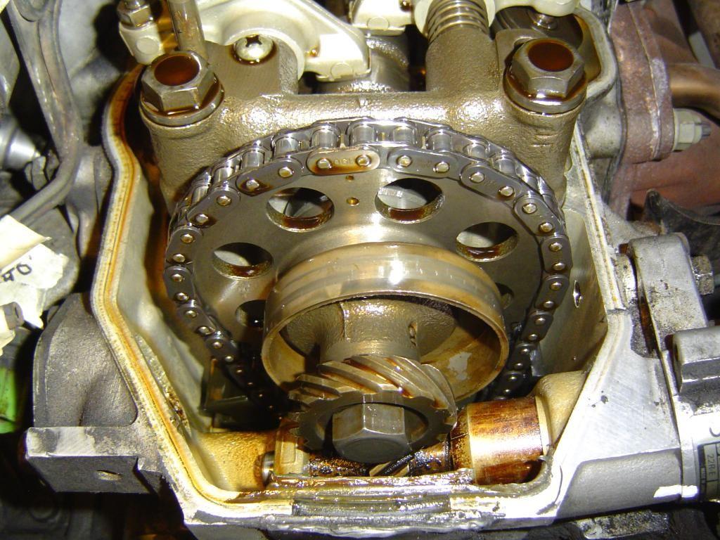

What is the eccentric like that drives the pump is it in good shape??
Some time pumps leak internal your not getting any gas in the oil are you??
Has this ever worked Correct??
This truck came in a big box all in pieces??

Sorry, I have no idea what the eccentric is your referring to. It is a mechanical pump. No oil/gas mixing. But I do believe there is an internal leak in the diaphram of the pump which is keeping it at a low pressure by returning too much gas to the tank. Surprisingly it was and is running pretty well with the low pressure that it is pumping out. It is because I am adding the regulator/guage that I am discovering these things. This was a salvage vehicle and I am not sure what the PO did to get it on the road. I am pretty green when it comes to auto mechanics and am making a concerted effort to become proficient at maintaining this truck. I will replace the pump in a day or two and go from there.

The pump has a arm on it. That arm rides on the eccentric inside the head. It is ran off the timing chain. If you take the valve cover gasket off you can see it. Smooth round off centered thing on the top timing gear. In this pic it is between the timing chain gear, and the distributor gear. Note: this is not my pic and is a picture of a 22re so it has a electric fuel pump rather then the manual, you have so its not installed in this pic.

OK, I went ahead and hooked the return line back up and now just have the short hose connected between the carb and the fuel pump (no regulator). I was able to put the pressure gauge inline. This time during idle the gauge jumped between 1.5 psi and 2 psi. When I increased the rpm around 1800 rpm it fluctuated between 2 and 2 1/2 psi. So apparently the flow was impeded somewhat when I tested with that 5' of fuel line with the regulator hooked up, as Schnayke pointed out. I test drove it and its running very well so I will leave it as it is and use the new regulator as a paperweight. I bought a timing light recently and planned on doing that procedure for the first time, but I honestly don't know how it could sound any better than it does now. I'll check it anyway to get familiar with the procedure, but probably won't adjust it.
