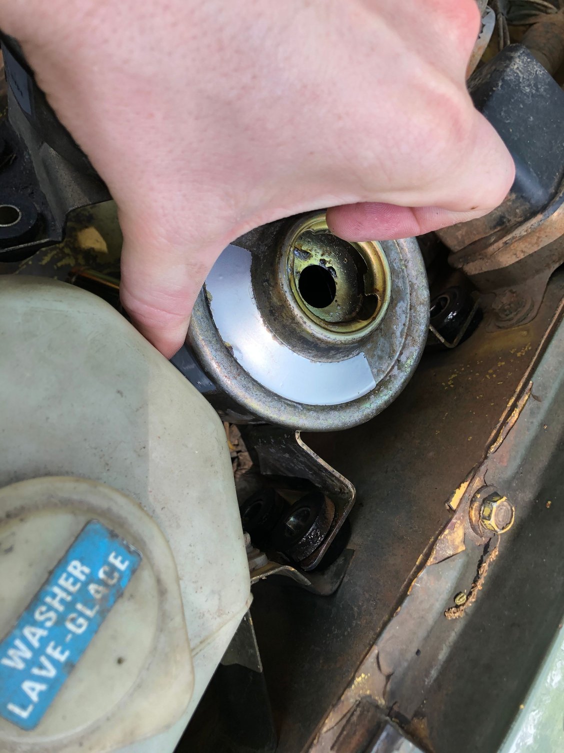

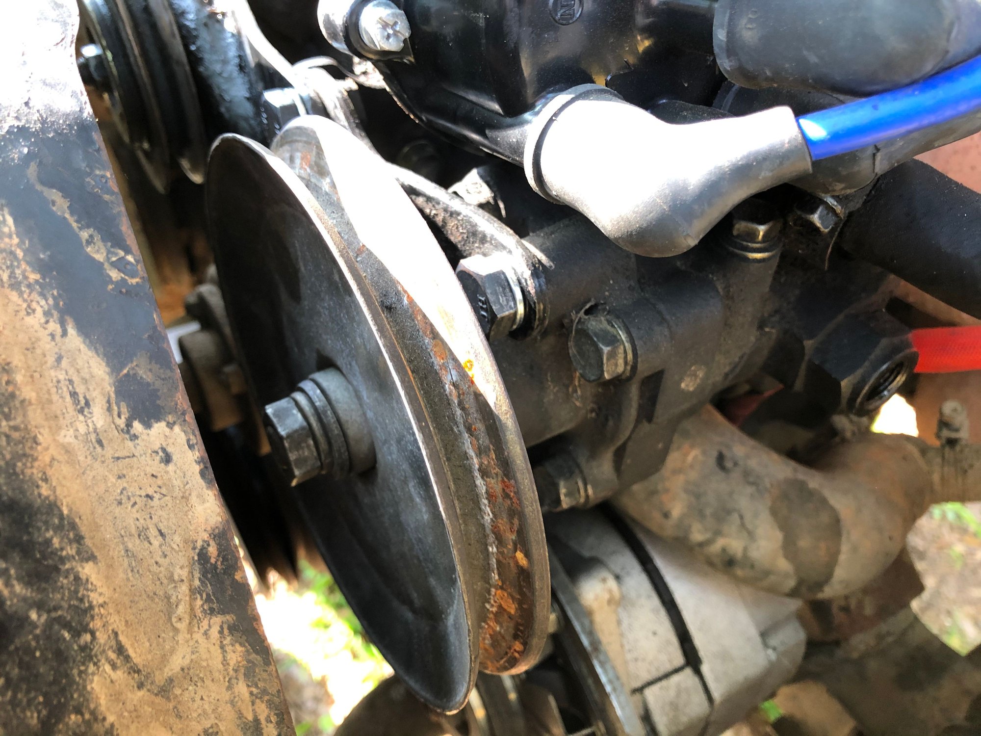

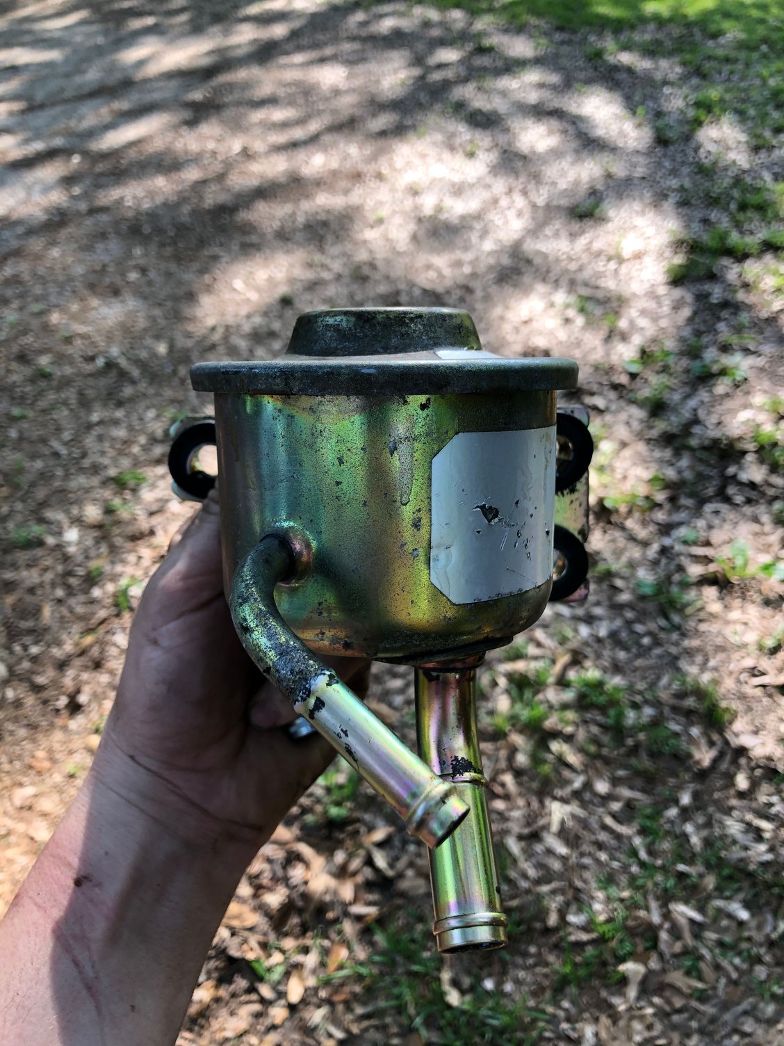

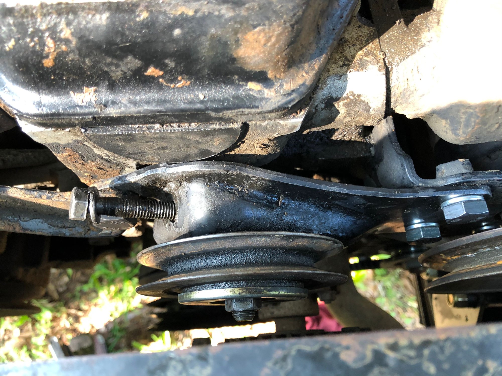

I’m smack in the middle of this myself on my 1980. Parts I have on so far
ifs box -1988 4runner
pump/bracket - 85 truck
tensioner - 85 I think
extra crank pulley off any 20r/22r
i have to have the reservoir from an early pickup that mounts to the side wall not on the inner fender, I found this out now I have one of each haha.
I THINK this is how the res goes in
Pump and pulley
Res
Tensioner
Pump and pulley
Res
Tensioner
Thanks!!
Why did you have to get 2 different reservoirs? Why did the first one not work?
How will you connect the steering column to the new IFS box?

Originally Posted by Groundpounder17
Thanks!!
the columns are the same. Slips right on. The reservoirs changed Sometime in the early 80s the later models bolt to the fender and the earlier models bolt to the side of the engine bay. It’s not possible to bolt the fender mounting style onto our vendors without a custom bracket
