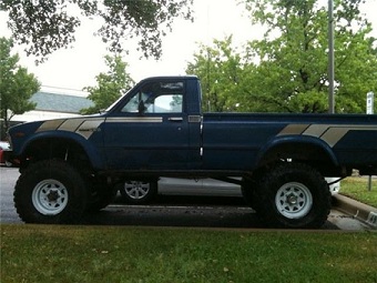

Im a long time YT reader, and a first time poster.
i have an 83 and my motor bit the dust, i found a 85 efi motor with a fresh rebuild. i have no interest in EFI the cons outweigh the pros for me (i dont crawl and i dont want to touch wiring) My question is can i just put my carbureted intake and head on the EFI block? that would make my life so nice and easy. any input is appreciated thanks guys
attached is the beast
