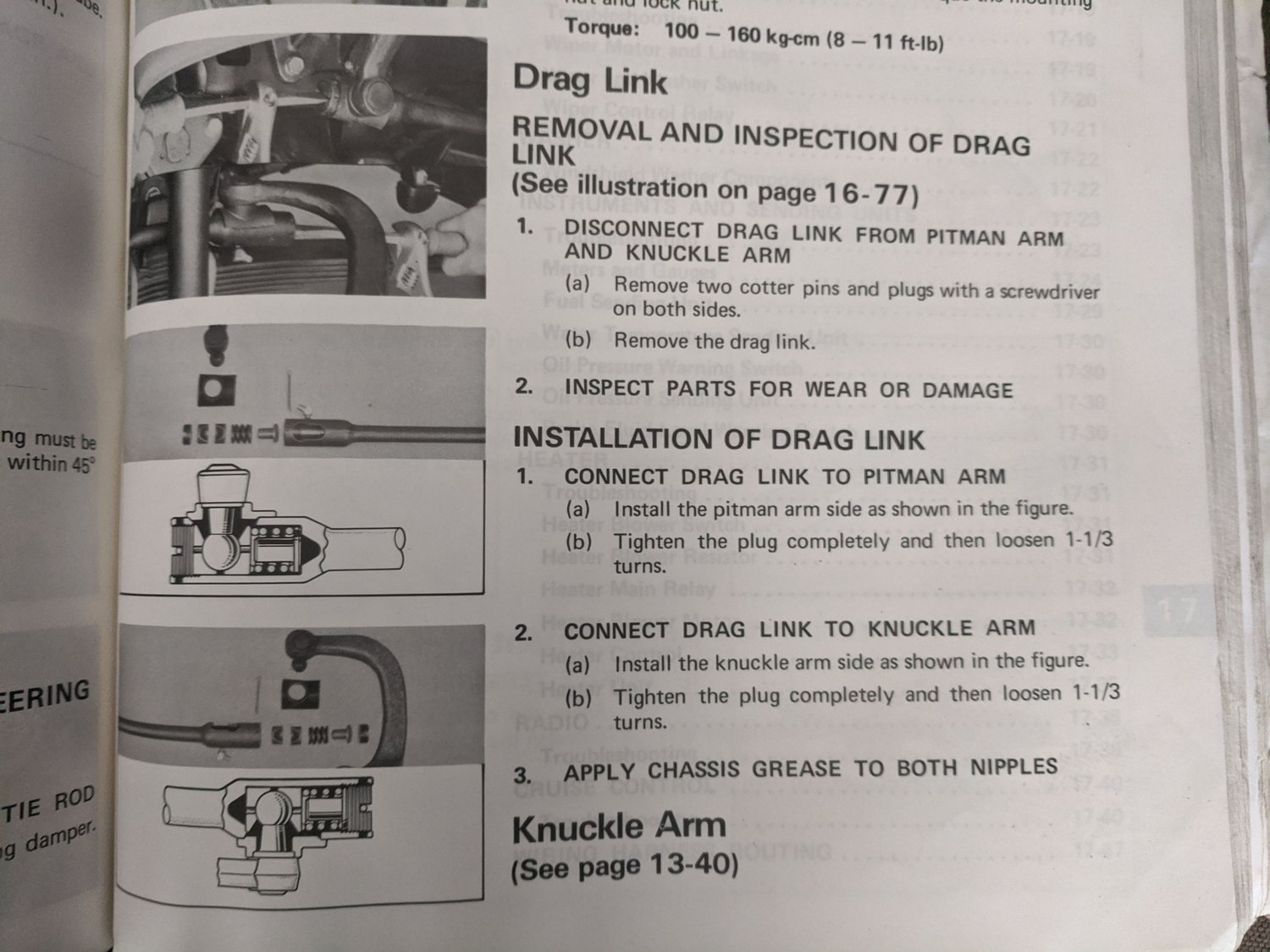

Glad that helps. There is a little bit of a trick to setting the preload. Here is the page from the 83 FSM:
The trick is that you use a large flat head screwdriver with a square shank and put a crescent wrench on the shank to get the necessary leverage to tighten it completely (if you look closely you can see this in the first image)
I highly recommend you get a copy of the FSM if you're going to be working on your truck. if you can't find a good paper copy, You can get this PDF for free courtesy of 83Toyota88 of Yotatech:
https://www.yotatech.com/forums/f114...wnload-261385/
But I'd really recommend the paper version. There are some other good books out there as well but the FSM is tops.

Brilliant. Back out 1 1/3 from tight. Thanks a ton for the tip and the PDF. Hugely helpful.

My pleasure. You'll find that the 1 1/3 will be kind of be designated by where the slot in the end cap aligns with the holes available for the cotter pin to go into.
Old Jun 15, 2022 | 11:53 AM
Jonnymorrow's Avatar
Joined: Mar 2022
Posts: 30
Likes: 5
Absolutely. I assume 1 1/3 ish to nearest pin hole. Thanks again!
