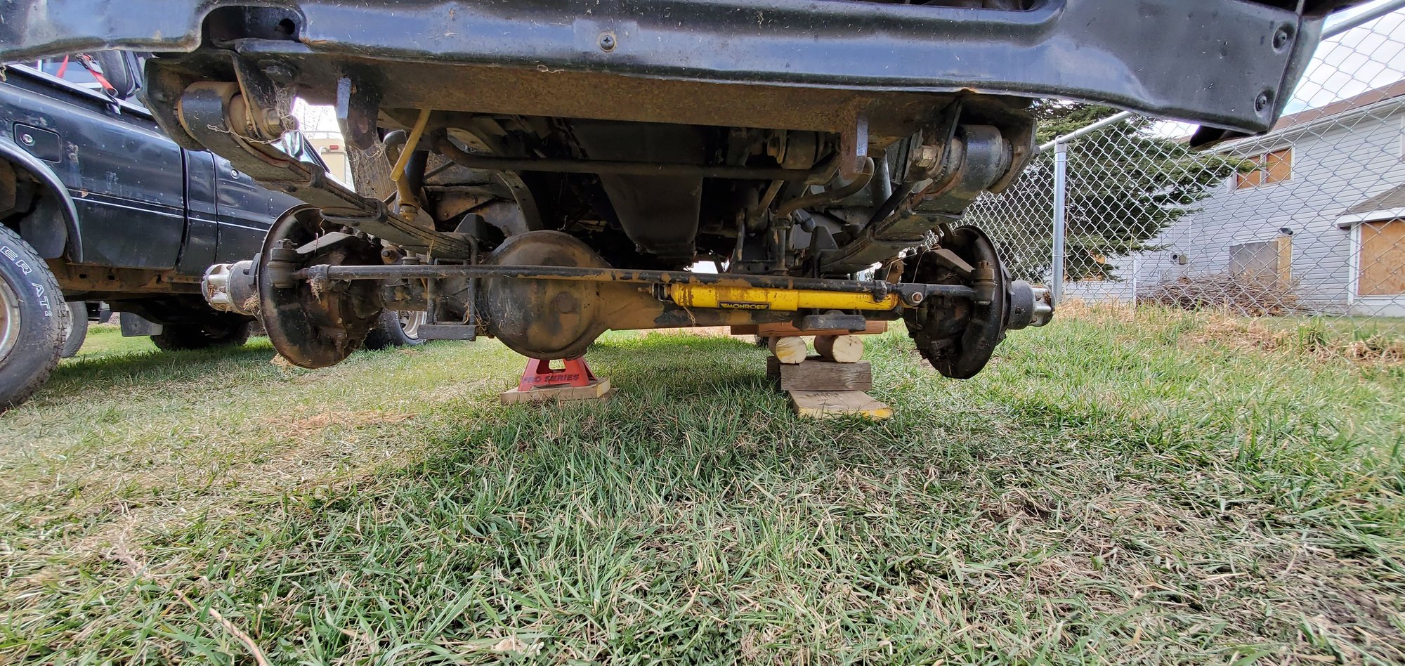

Thanks for the reply. My plan with the '82 is to just raise it enough (I understand that 2" suspension plugs 2" body life is recommended, but maybe a 4" suspension is better? Or would that lead to hood clearance issues?) to install a 4.3 Chevy engine and then pop in some lockers and use it as my main weekend Toy. The '83 short box will be done next and I'll likely get more radical with it. They're such simple, yet incredibly well engineered vehicles. I appreciate the knowledge resource of forums like this one.
Anyway, here are the two old beasts as they sit today. Not the best photo, but cropped from my security camera footage.
Cheers!
