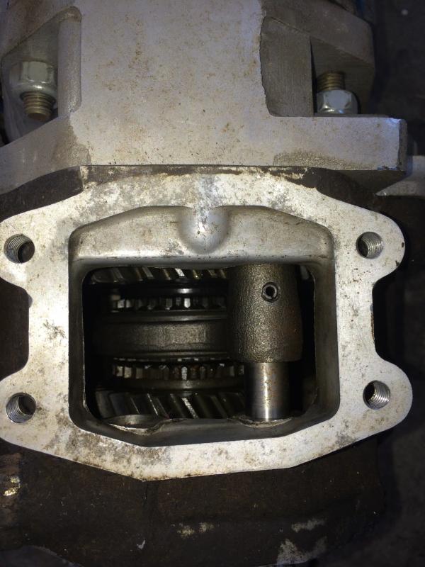

Looks like the forward most T-case is set up for forward shift. My W56 uses the topshift t-case. Not a big deal. I Tapped the roll pin at the shifter fork out at the detent spring channel. Used needle noses to catch it then slid it forward and cut it off. Slid back in place and re-install roll pin. So do some more research. Marlin's site has loads of information. So does pirate faq's. As YT faq's might have it too. 4crawler has lots of cool info too. Been years since I did install and I have a hard time keeping good photo's for write ups.

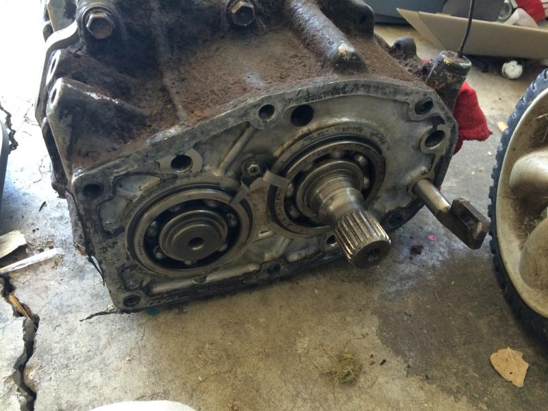

Thanks for all the info, that should keep me busy for awhile. Here are some better pictures of what the cases look like on the inside. I bought these like this and want to make sure everything is in order before i take it to a shop to have it installed.
Size:  78.8 KBName:  IMG_1037.jpg
Size:  72.2 KBName:  IMG_1038.jpg
Size:  66.7 KBName:  IMG_1039.jpg
Let me know what else has to be done. Some say it is all ready to go, others say it needs the shift rod adjusted.

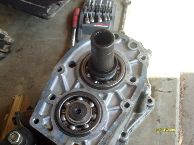

i am pretty sure that forward rod needs to come out of the crawl box(forward case)
it has been awhile since i had my dual cases out but i don't remember it being there
this is a pic from a few years ago when my transmission got trashed, no shift rail extending out.Name:  friedinputshaft2.jpg
and it is not shown in T-G dual case instructions.
https://www.trail-gear.com/TG/prodInfo/pdf/dualcase.pdf
not sure if you can just cut it off or drive out that pin.
it has been a long time, so i would check the instructions above

DropZone, i think you are right. I feel like i have read a million different articles on how to do this right, yet everytime i think i am close, there appears to be another issue. Guess thats what i get for now shelling out $2,000 for a prebuilt setup.
I think i need to convert the forward case to a top shift. That should be a simple swap, for the most part.
Anybody want to weigh in on this? Its being mated to a w56 trans, and i would like it to have triple sticks if possible.

Dude- please don't tell me you paid $2k for that dirty set? does it at least have 4.7's? Did it come with a truck?
you could have ordered a pro built set from Marlin or T-G for less than that and gotten a warranty
https://www.marlincrawler.com/transf...p-4runner-kits
https://www.trail-gear.com/TG/Trail-...x#.VLXl09LF9Qg
didn't even think about Foward shift, yet they need to be top shift
