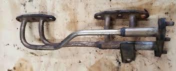

I picked up a used part like shown above but different as it is one tube not 2. This one wraps around the head and terminates in a 2 bolt plate. That bolt up to another pipe that goes almost all the way to the air valve. That part is hard to locate. And then are smog referee may not buy off on it. I have to check with them first.

Air injection pipe
Here is a picture of the 85 pipe for the system. If anyone has a spare or removed yours and want to sell it please let me know. I also need the 85 control valve too.
