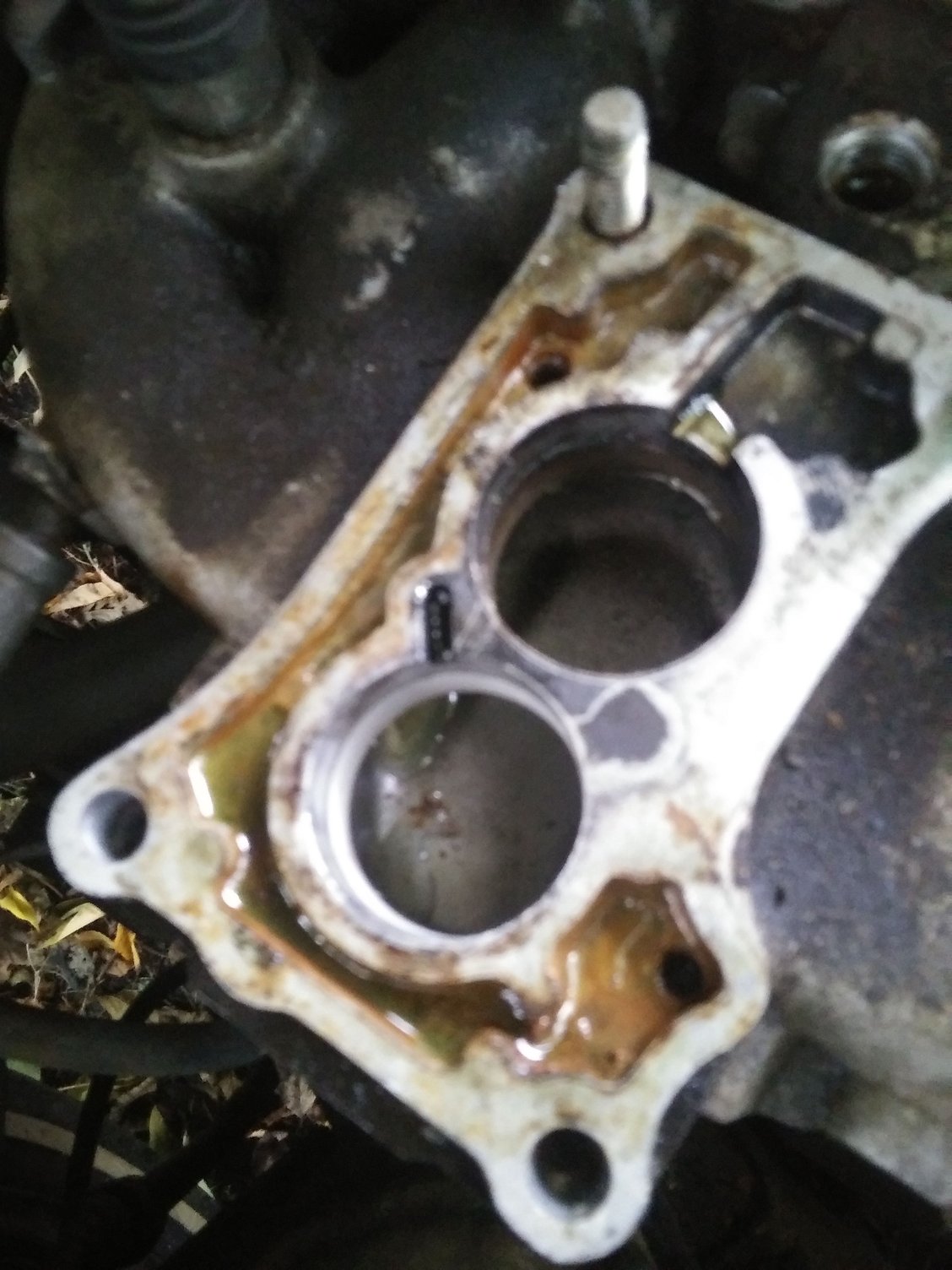

this is just plate that is between the carb and intake but it has coolant passages in it. It looks like it would be fine to block them off from here because it just flows out one hole and in the other but i read somewhere that the weber wont mount to this plate so if I take it off its just 2 holes and no channel for the coolant to circulate so the weber will block off this coolant passage.

Thank you for the picture, it makes things clearer. I did not know that you had also removed the phenolic spacer/insulator as well. It's the thick black spacer that sits under the stock carb. In the picture that actually appears to be the top of the intake manifold & there should be no further "plates" there. You may be able to mount the Weber on top of the stock spacer, but if you buy the Weber in kit form it comes with 2 aluminum spacers that take the place of the stock spacer. It also has a gasket that goes under the bottom spacer & that will seal off the coolant passage from leaks. If you want to be sure go with the kit & get Weber's spacers.
Here's what the kit looks like: https://www.lceperformance.com/Weber...-p/1030021.htm and you can see the spacers & gaskets that come with it in that pic.
