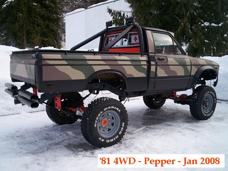

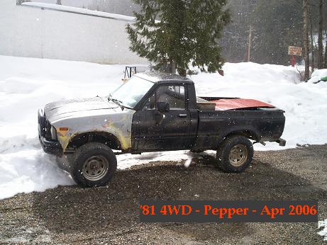

So here is the design for the new ball stud, kinda works the same as a tie rod end. and some pix of the truck. hope you enjoy, and still looking for other ideas.

OT: but Cool job on the Bed converion, with the paint job it came out better than I had pictured...
What size tires are you planning on running?
