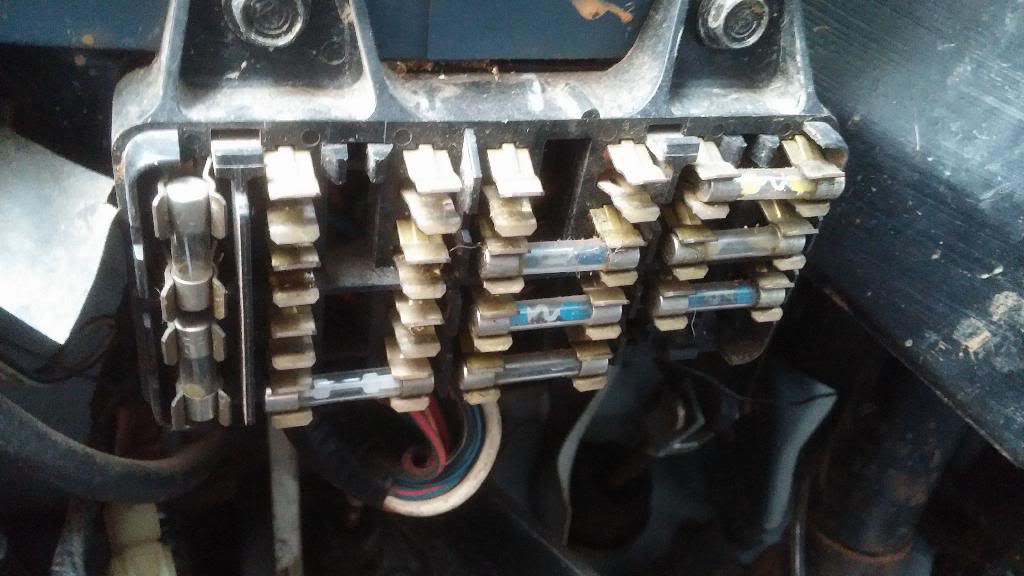

Anyone got a copy of the fuse indicator diagram? p/ o did a hack job of wiring under the dash and im looking for starting point.

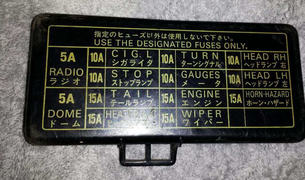

This is the cover from my 81 4x4

Posts: 38
Thank you!
