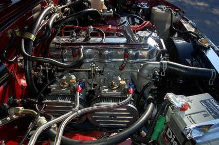

Old Jul 18, 2012 | 12:20 PM
suncomb1's Avatar
Joined: May 2009
Posts: 684
From: Downingtown, PA
Photo Of DCOE carb setup.
