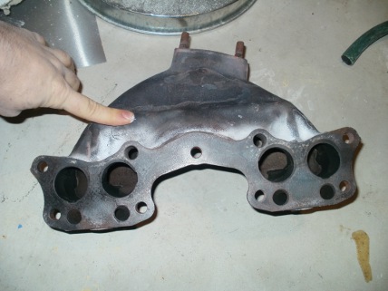

So, I have now officially had the manifold fixed 8 times. This time, I purchased a "header" and used this instead of the cast iron manifold. This drastically reduced the noise of the truck, however, I am still getting carbon monixide into the cab! How can I tell? Well, for one, I have a carbon monixide detector in the cab, and it goes off as soon as I start up the truck. For two, if I drive for like 15 minutes in the truck I start to feel woozy.
This really sucks, cause I have about 800 bucks sunk into trying to fix this problem, and it's still not fixed. The only thing I can think to do at this point, is have the header planed down (this is the new header, not the old exhaust mani), and I bought this goop from Dow Corning which apparently can be used instead of a gasket, to make the seal. I suppose I could try fixing it this way, instead of using a gasket, but other than that, I'm really out of options. If this fix doesn't do it, I think I'm going to drive this camper out to the middle of a field, attach some TNT to it, and blow it to kingdom come. At least I'll get some enjoyment out of it.
Old Jan 31, 2012 | 12:30 AM
fiddlewallop's Avatar
Joined: Nov 2011
Posts: 23
Mercuryman, when you said you can have the "head" planed, were you talking about the part of the actual "engine" that the exhaust manifold attaches to?
I get confused now, because my mechanic explained to me that the "header" which is what I have on their now, is just another word for a souped up exhaust manifold, except the "header" has longer pipes and therefore the exhaust doesn't merge into one singular pipe for a longer period of time. BUT, I think this is different from the "head" that you're refering to, which, I believe, is the part of the actual engine where the exhaust manifold connects to. If that's the case, it would seem tricky to me to get that planed down, just due to space restrictions. Maybe it's possible, I don't know.
Because, I think when the machine shop planes down the mani, they just put it on a really large table sander for a couple minutes, and plane it down that way. If they needed to plane down a part of the engine, that would be tricky because they obviously won't be taking the engine out. Not sure how they'd pull that off.

Old Jan 31, 2012 | 06:26 AM
83's Avatar
83
Joined: May 2008
Posts: 4,591
Likes: 126
From: Montana
Yes, the head is the upper half of the engine, with the valves in it. A "header" is an aftermarket exhaust manifold. Or at least that's what people call them.
The head is aluminum, so if the engine was overheated at some point, it is possible for it to warp. If it is warped, yes, it needs to come out of the engine in order to be flattened, as far as I know.
Figure out if the surface is flat, and go from there.
Old Jan 31, 2012 | 10:09 PM
MercuryMan's Avatar
Joined: Jan 2012
Posts: 32
From: Springdale, NWA
In the US we call all aftermarket stuff 'headers' and the usual factory set up is an exhaust manifold. In the UK they call it all exhaust manifolds. So it can be confusing, but they do the same job and are basically the same part, headers are designed to give you better flow in most cases than the factory stuff.
Right, that is your surest method. Buy a new head gasket, remove your head and take it to a shop and they can remove any high points (warpage), if you do this make sure they have your header too and can mod the header if needed after the head is flattened.
But there is another option if you don't want to go to all that trouble. You can determine if your head is warped using a metal straight edge, lay it across the gasket surface and use a feeler gauge to measure the clearances. There shouldn't be more than .003" diff. in a 6" span or more than .006" total difference. You want to measure straight across and on the diagonals.
If it's warped and you're brave you can fix it using an old school technique. Attach your new gasket (with contact cement) to the header or your old manifold would be better if its easier to maneuver in there and coat your gasket with Prussian blue dye. Then very carefully attach the mounting bolts and began to tighten evenly all around as you get close make sure you are going in at the same rate and in small increments. As soon as you began to make contact with the gasket go only a little farther. Carefully back it off and observe where the dye transfered (obviously before you do this the head must be clean and free of oil/grease). These are your high points and need to be sanded down. Place rags in your holes and sand down only those spots. You must go slow in the process and make sure you don't remove too much, and use progressively finer grit as you go. I would still remove the head if it were me just because long hours of leaning over my engine might make me crazy, but it can be done while still in there.
Do you know for sure the leak isn't in your pipe somewhere? I realize you've been having trouble with the header but CO can come in from a leaky pipe as well. You could leak test the system and see where it's compromised.
Oh and don't blow the little beastie up-although I must admit that would be quite a show especially with a full tank of gas-but whatever it is...IT can be fixed.
