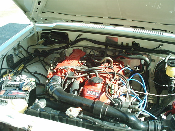

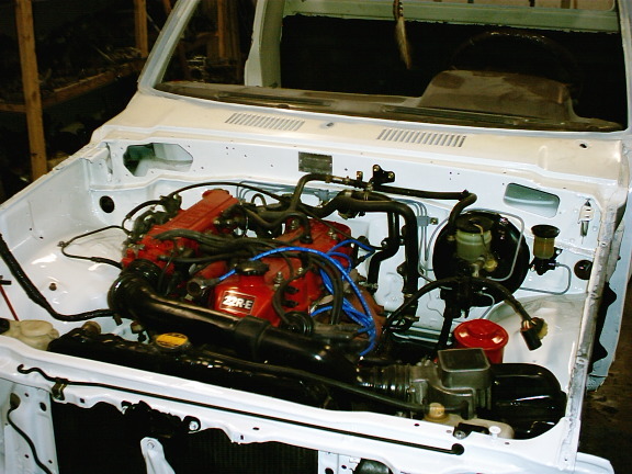

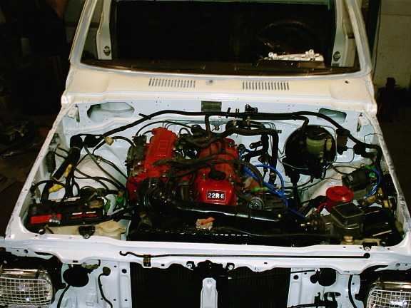

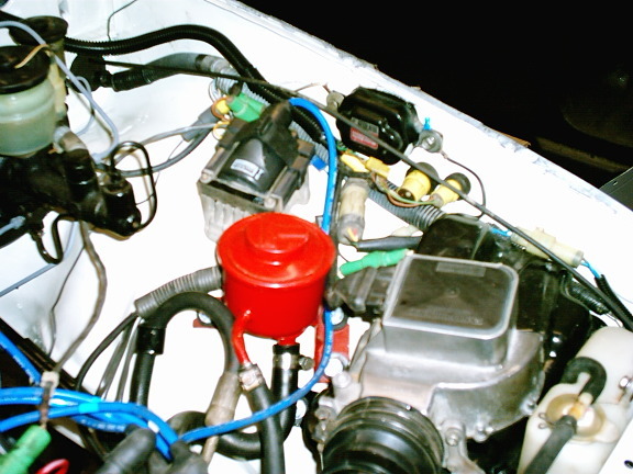

hey sorry about not posting on your other post about the p/s .. got busy .
here is the swap I did ~12 years ago .. and yep , I used the 84-88 w/washer tank and also the coolant reservoir

Thanks very much, that is very helpful! I have basically the same coolant tank and airbox, looks like I need to do some creative work to wedge them in like you did. Did you use the original mounts for the airbox?

I think so , but honestly , I don't remember
