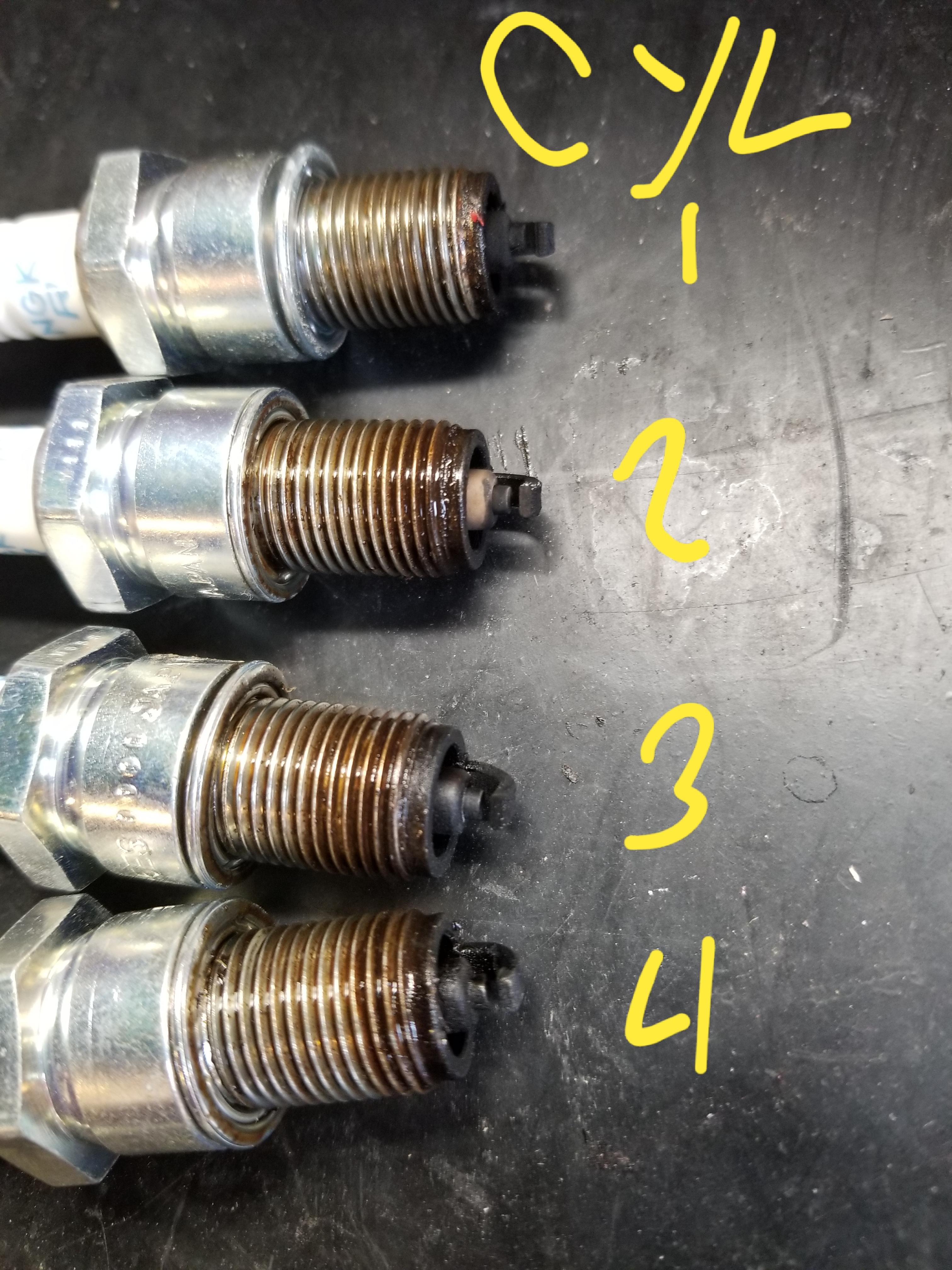

I keep hoping that it's only water vapor, but that seems like a lot of smoke at startup and initial drive. Not to mention the #2 spark plug having the appearance of being steam cleaned.
If you aren't loosing coolant or using oil is has to be water vapor. I'm not sure what to say about the #2 plug unless this is an RE (but your post says R)and one fuel injector is dumping fuel or this cylinder has a misfire, so the fuel isn't being burnt and is washing down the cylinder and plug.

I believe I do have a 1981 California edition truck because every thing is sill intact and working emissions wise, it even has the “Sensor” light on the dash. It does pass the emissions test here in Utah which is great. For arguments sake how would I tell if I had a later long block installed? I assume that I can check the serial number of the existing block with Toyota, to get a production date. If I do have a late date block I might have to take up Skypilot’s offer in regards to the cylinder head. Today did get away from me, and I had no time to play with the Pickup, which is a bummer. I’m off to work and will not be able to turn wrenches till the end of the week. Thus, an update is forth coming, it’s just going to take me a little time. I would like to thank every one who has commented with ideas and possible avenues to pursue.

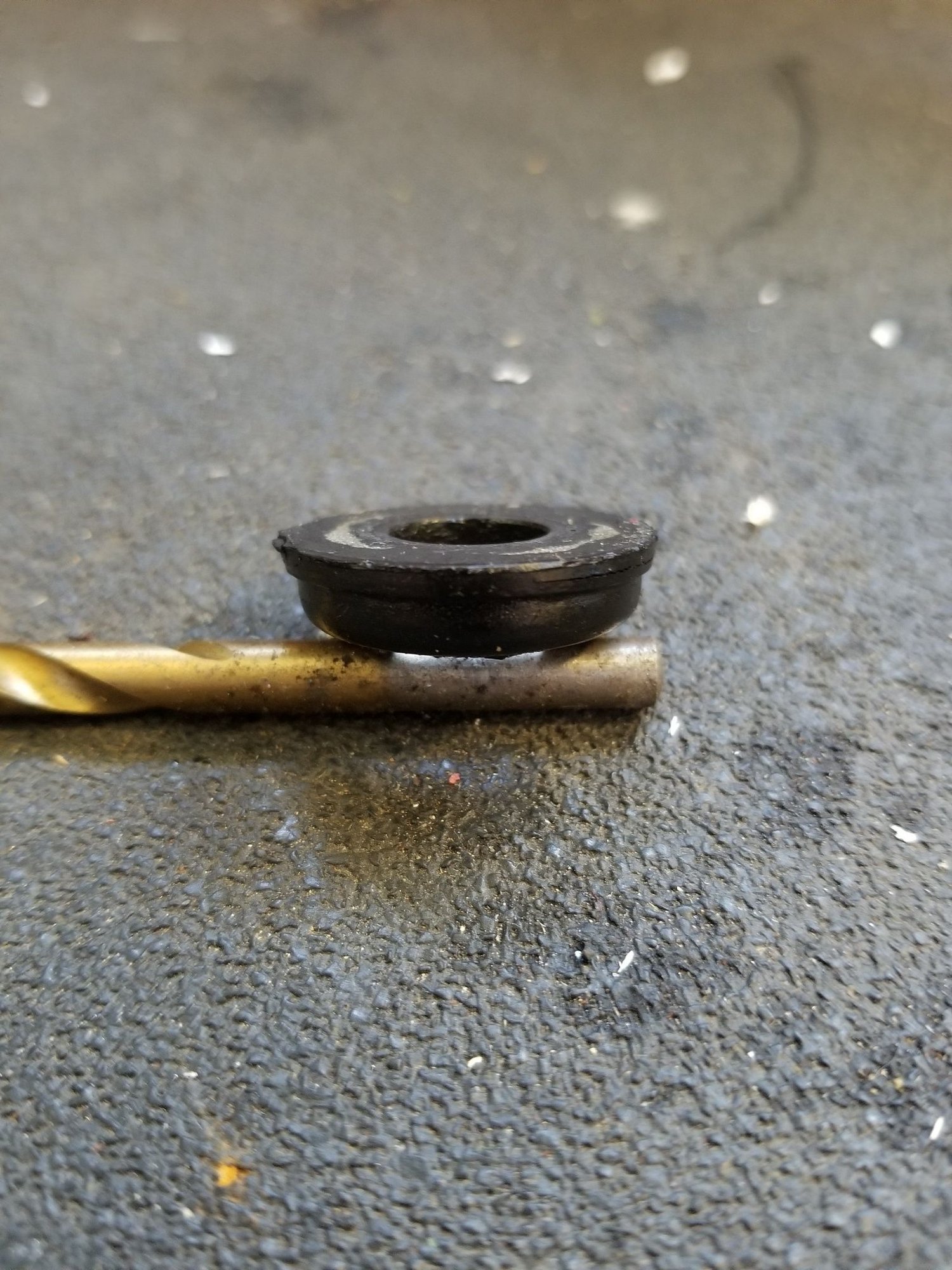

Problem solved! This hard piece of rubber was resting over the oil drain hole in the back of the head. Only thing I can think of is that it is the bottom of the pcv grommet. You can't see it because their is a oil baffle covering in on the inside of the valve cover, so when I pulled the old grommet out and put the new one in, this piece wiggled its way out after a bit of driving. Thank you for every one!

I still cannot believe that the problem was resolved so easily. I have to give credit to a thread I read on IH8Mud, since someone else was experiencing the same issues as I was and that was the fix. Just check the oil drain hole in the cylinder head for any obstructions. Now that I think about it, the smoke only occurred when driving uphill, which led me to that post. Now I can focus on rebuilding the front axle, with new wiper seals and bearings from Marlin Crawler. Rebuild the leaking manual steering box by replacing all of the seals. Next fitting a bed bar to the existing holes in the current bed. Last but not least, install some new KC Highliters on the bed bar. I can’t wait to drive this truck all spring, summer and fall, she is really my pavement princess.
