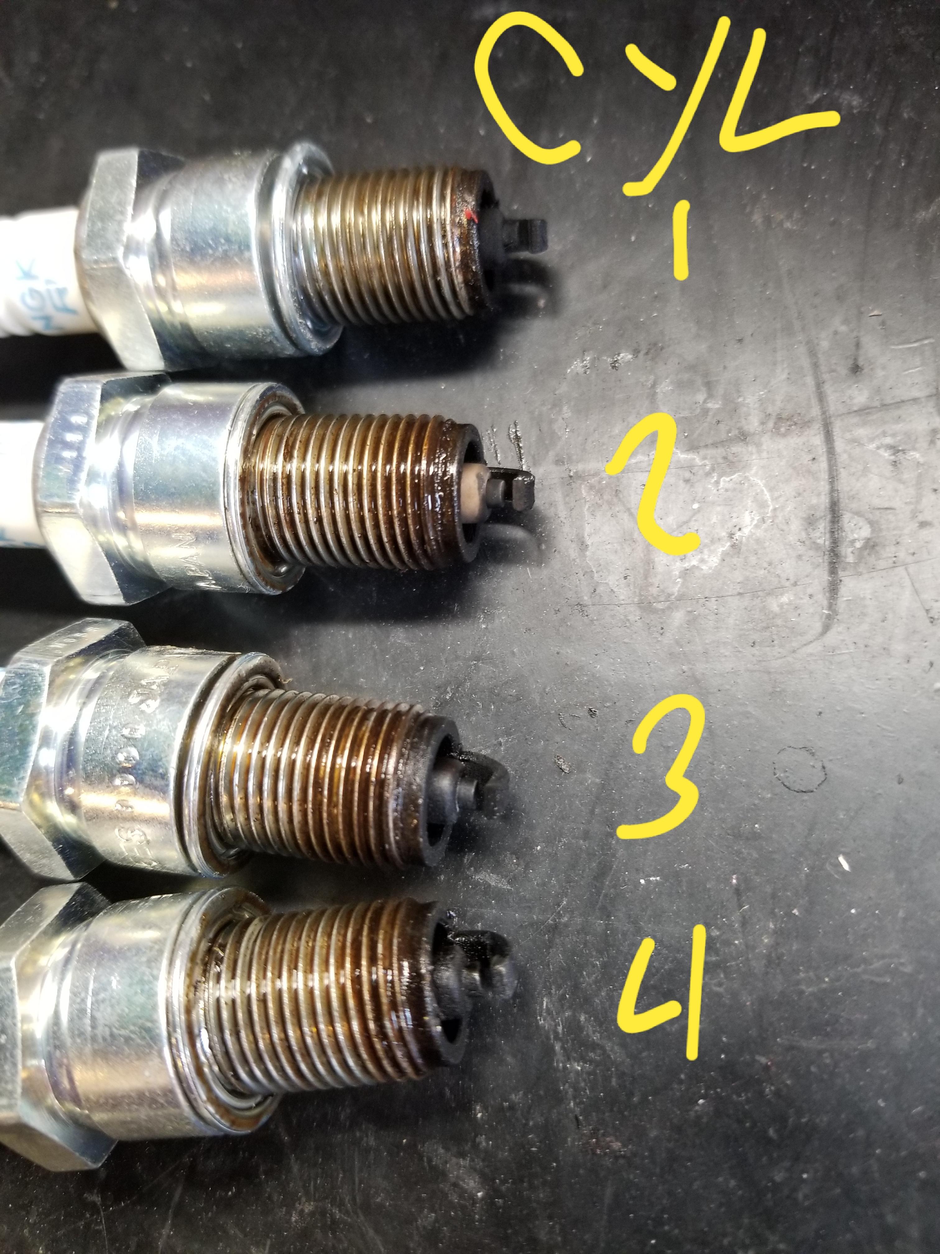

22R and White smoke.
My question is in regards to the intake manifold gasket on a 1981 22R California edition engine. The engine has 165K miles on it and runs strong, no lag in power or hesitations of any kind. The coolant is always full and no leaks have been detected on either the block, timing cover or head gasket. The oil is clean and free of any coolant. The cylinder compression was tested and they were all reading at 160psi, +/- 2psi. The other morning, I noticed a cloud of white smoke coming from the exhaust during the engine warm up and initial drive. My initial though was that the head gasket was going bad. Though with the above observations mentioned I was wondering how possible is it for the intake manifold gasket to fail resulting in coolant to enter the combustion chamber? I pulled the plugs and only cylinder number two show signs of being clean, i.e. steam cleaning from the coolant. Is this possible or should I concede that my head gasket is blown?22R and White smoke.-ngkplugs.jpg

Plug 2 actually looks pretty good in your picture. Plugs 1, 3, and 4 look like they're rich or fouled. And they all look wet and oily around the threads and even onto the diode. So unless your valve cover is leaking oil down on to the outside of your plugs you're getting excessive oil into your combustion chambers. Maybe blow-by?
I know your compression test checked out so that would kind of go against that idea.
You've got all of the factory California emissions equipment? You could be venting oil from your valve cover back into the motor more than usual. I don't know I'm just spitballing.

The truck does have all of the California emissions equipment installed and it is working. I did have the carburetor rebuilt by National Carburetors (they did a great job), and they tuned it for my altitude of use here in Utah. The truck is completely stock and I have restored it using only oem parts from Toyota. I believe that the truck does run a bit rich and I have yet to adjust the carburetor, thus resulting in three of the four plugs being fouled. As a result of the number two plug being relatively clean, leads me to believe that I have a developing head gasket failure or a potential leak at the union of the intake manifold and engine block. There are no oil leaks that I can see, even the back of the valve cover is dry. Prior to this white smoke, I did do a valve adjustment, though I doubt that this has anything to do with the excessive white smoke that is emitted from the tail pipe upon start up. Otherwise, the truck runs great! So, I’m at a loss. I just apprehensive about changing the head gasket, since it’s a lot of work when I can just change the intake gasket and be done with much less trauma.

Oil smoke on startup would more likely be valve seals. Do the carb adjustment to lean it out some.
agree 2 is the normal looking plug.
