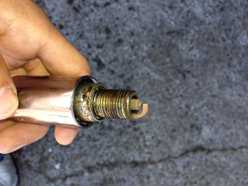

The blow by is likely the rings. You should be able to chirp the tires in 4th with 5.29s and 31's. Try sea foaming the engine then check the compression. Leak down test would be a really good idea as well. Post up resuts and we'll try to get you heading down the right path. What do the spark plugs look like?

Here's what all the plugs looked like last week when I pulled them.

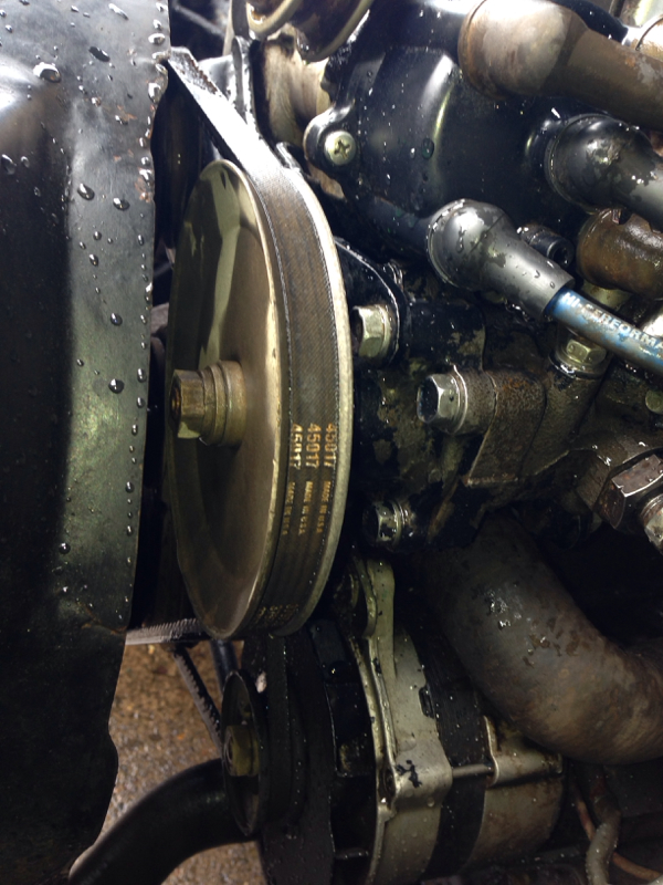

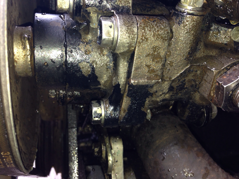

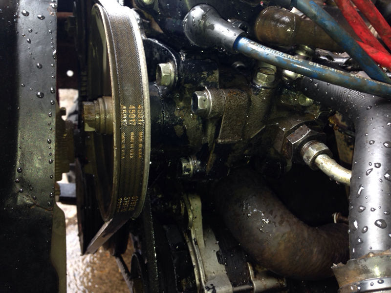

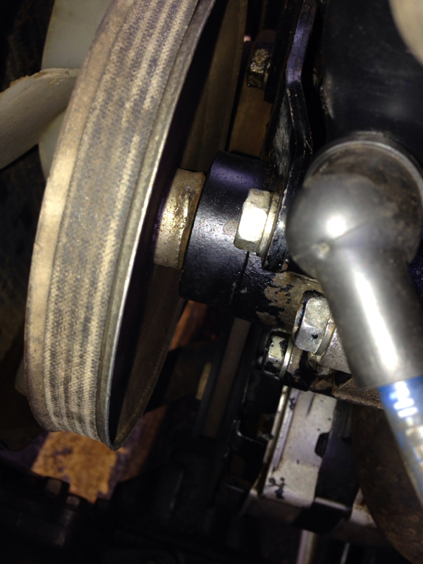

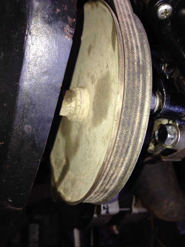

Can anyone identify this pulley and or ps pump? It is making noise and wobbling a bit. Has a little bit of in and out motion when I push/pull with hands. I went to carquest and they pulled a complete pulley apparently for this 22r but is was way smaller and different. He mentioned that the ps pump on my truck may not be the oem version or that the last owner could of did a trail fix with a different pulley.

We'll after googling some images the pulley I have looks right. Guy at carquest must have had the wrong part. Mugged I gotta try to get a new one or a bearing and pull it and try to press a new bearing in. Will search to see if I can do this as I don't have some tools I'm thinking I will need. I have no press, no bench vice and no pulley puller or torch haha.

That looks like the correct pulley. The factory part number is 44311-20010 - Vane pump pulley. If you ever need to get some parts diagrams or part numbers, check out http://www.villagetoyotaparts.com/default.aspx
But I wouldn't order from them since the majority of the parts are not available.
You don't need any special tools to get that pulley off either. Just leave the belt on with the truck in gear so you can break the bolt loose (17 or 19mm wrench). Then loosen the tensioner and remove the belt to free up the pulley. PAY ATTENTION WHEN YOU REMOVE THE PULLEY - the pulley is keyed and there is a small key bit that sits in a notch on the vane pump shaft. YOU WILL LOSE IT IF YOU ARE NOT CAREFUL! Without the key bit, your pulley will spin freely (perhaps it is missing already thus causing your wobble). The pulley should come off with minimal effort and no tools.

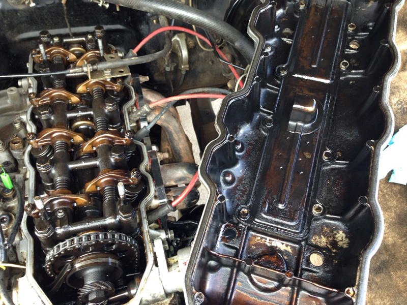

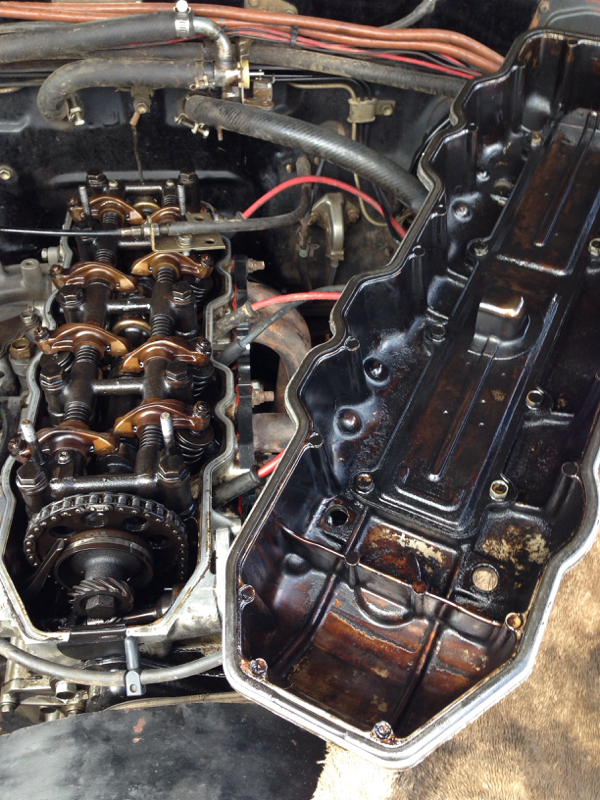

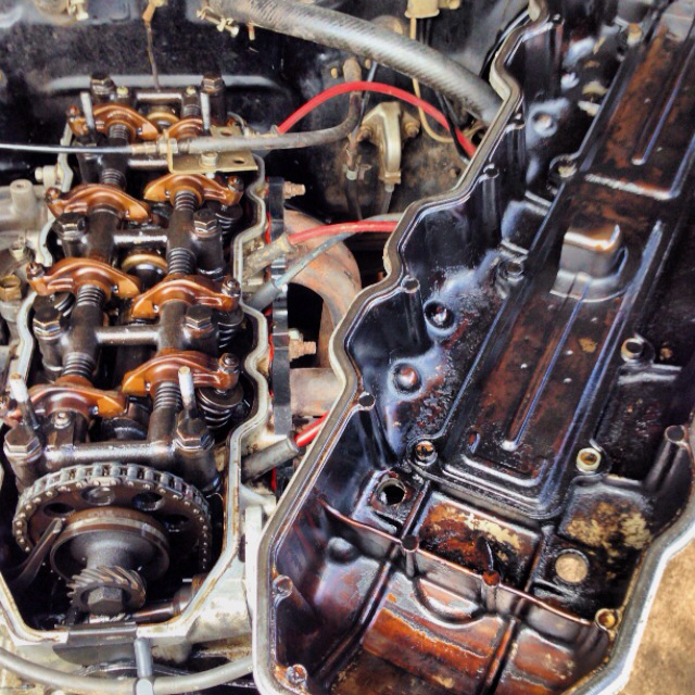

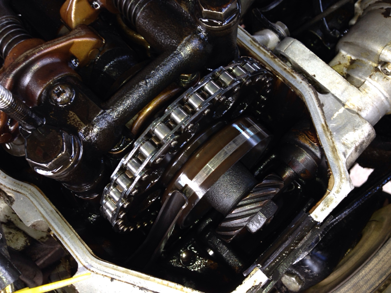

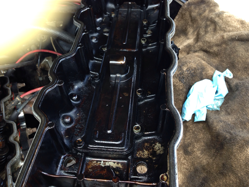

Pulled the valve cover off to adjust valves and "right stuff" the half moons cause they didn't get silicone whoever put it on last and were leaking.
Heres a video of the timing chain area and play etc.
[YOUTUBE]D1J5-18e0xU[/YOUTUBE]

Timing chain seemed fine to aswell as everything else so it's all put together and running good. Set the valves to 7 and 11
