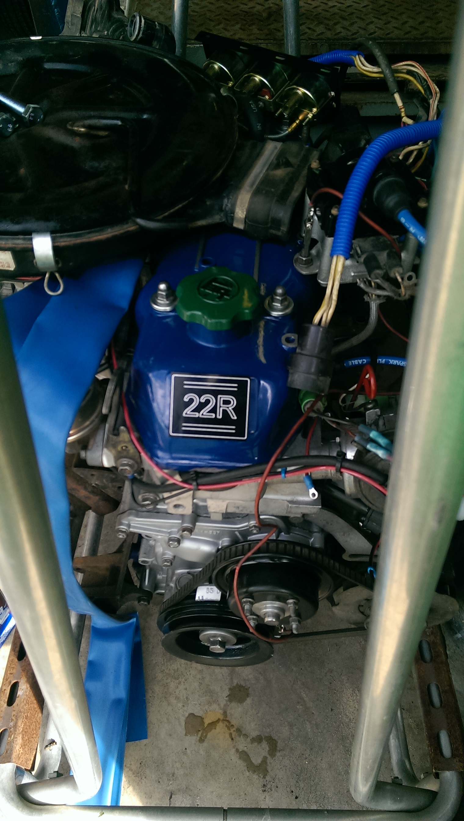

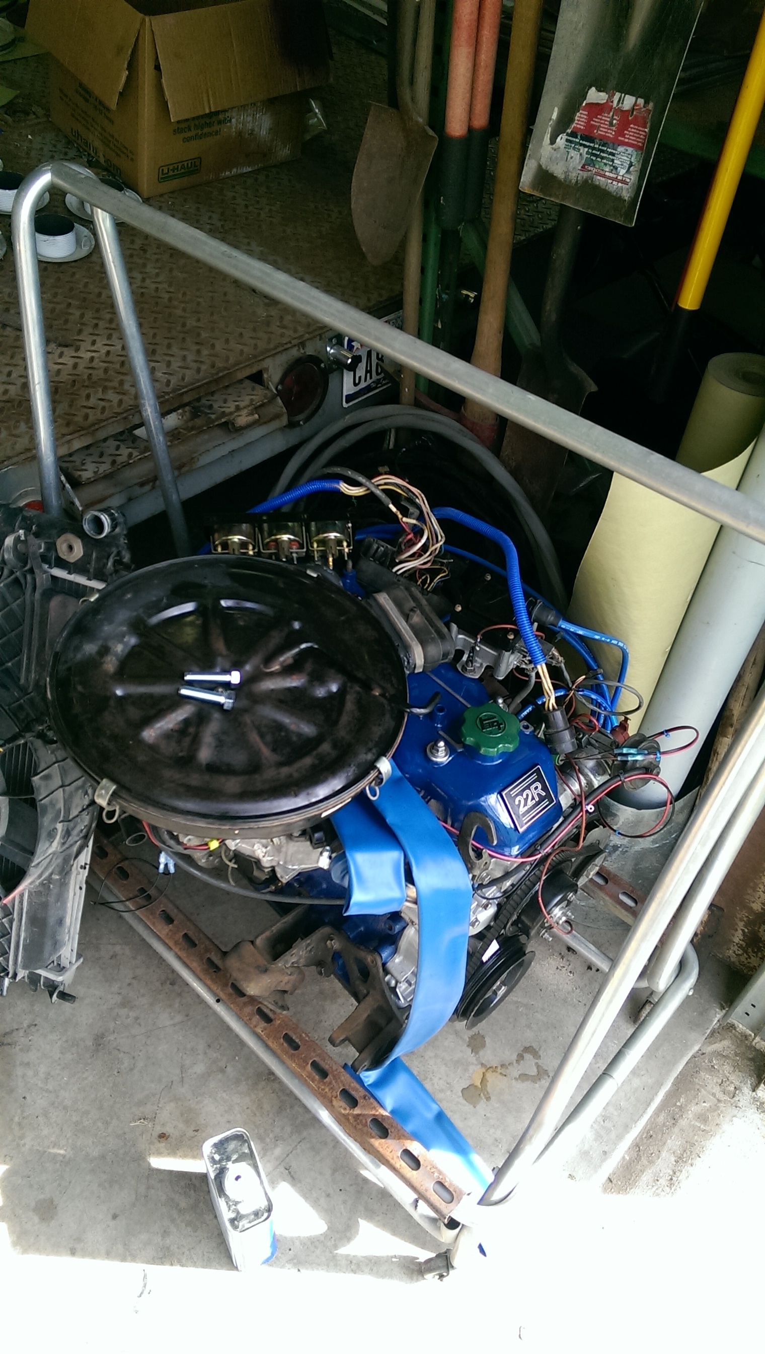

finished rebuilding my 22r!! woo hoo
engine has brand new
brearings
rings
rocker arms
LCE mild torquer cam
LCE oversized valves
LCE valve keepers
cap and rotor
points pick-up module
NGK spark wires
newish fuel pump
i polished the ports and abit into the intake manifold. EGR deleted. i had the head cleaned and plained flat and the connecting rods checked by a machine shop. plasigauged the bearings for fitment. stock the engine made 97 hp and 129 tq and i guestimate probably 130ish hp and 160ish torque.... the block its blue with black and green accents the valve cover is blue with custom 22R emblem
