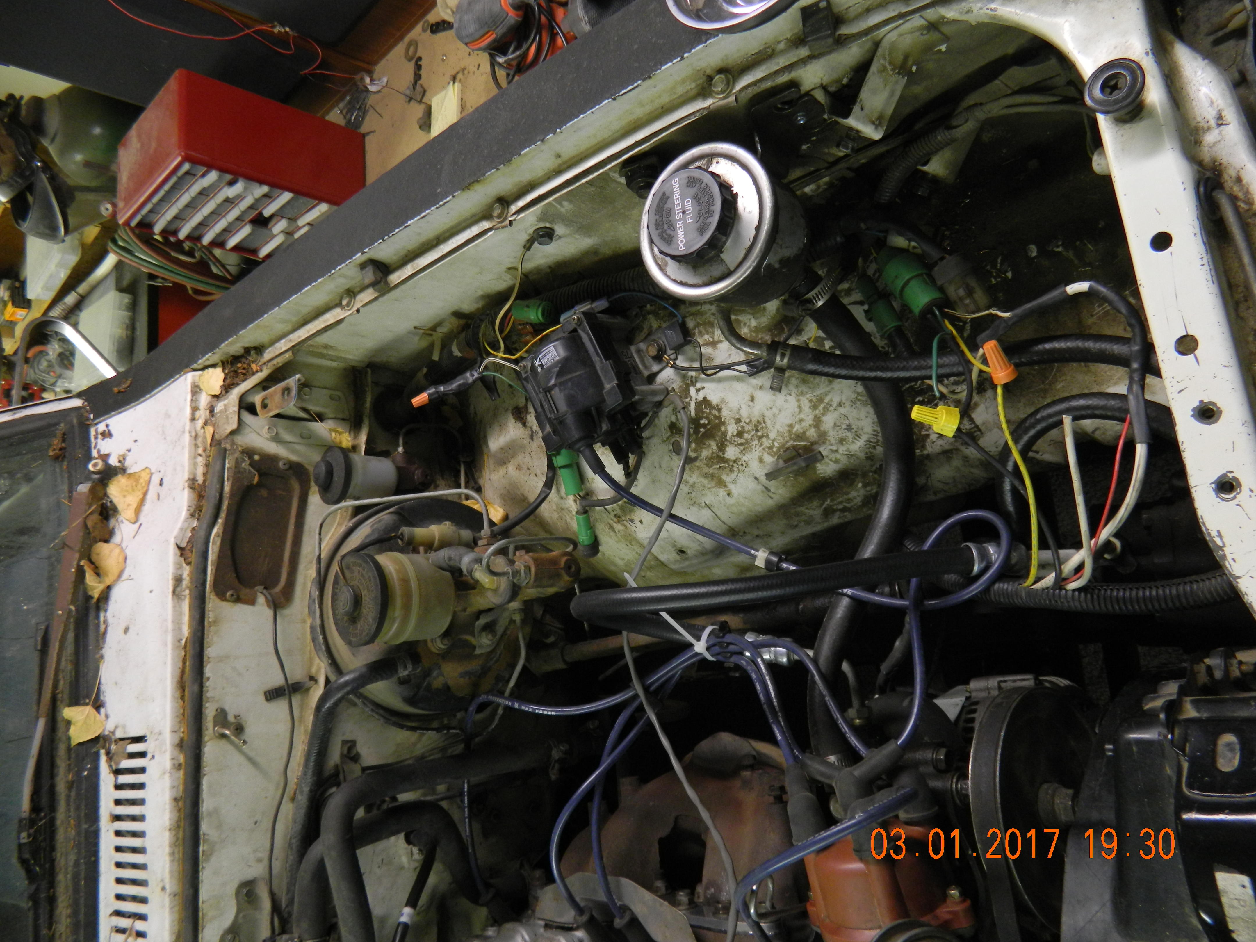

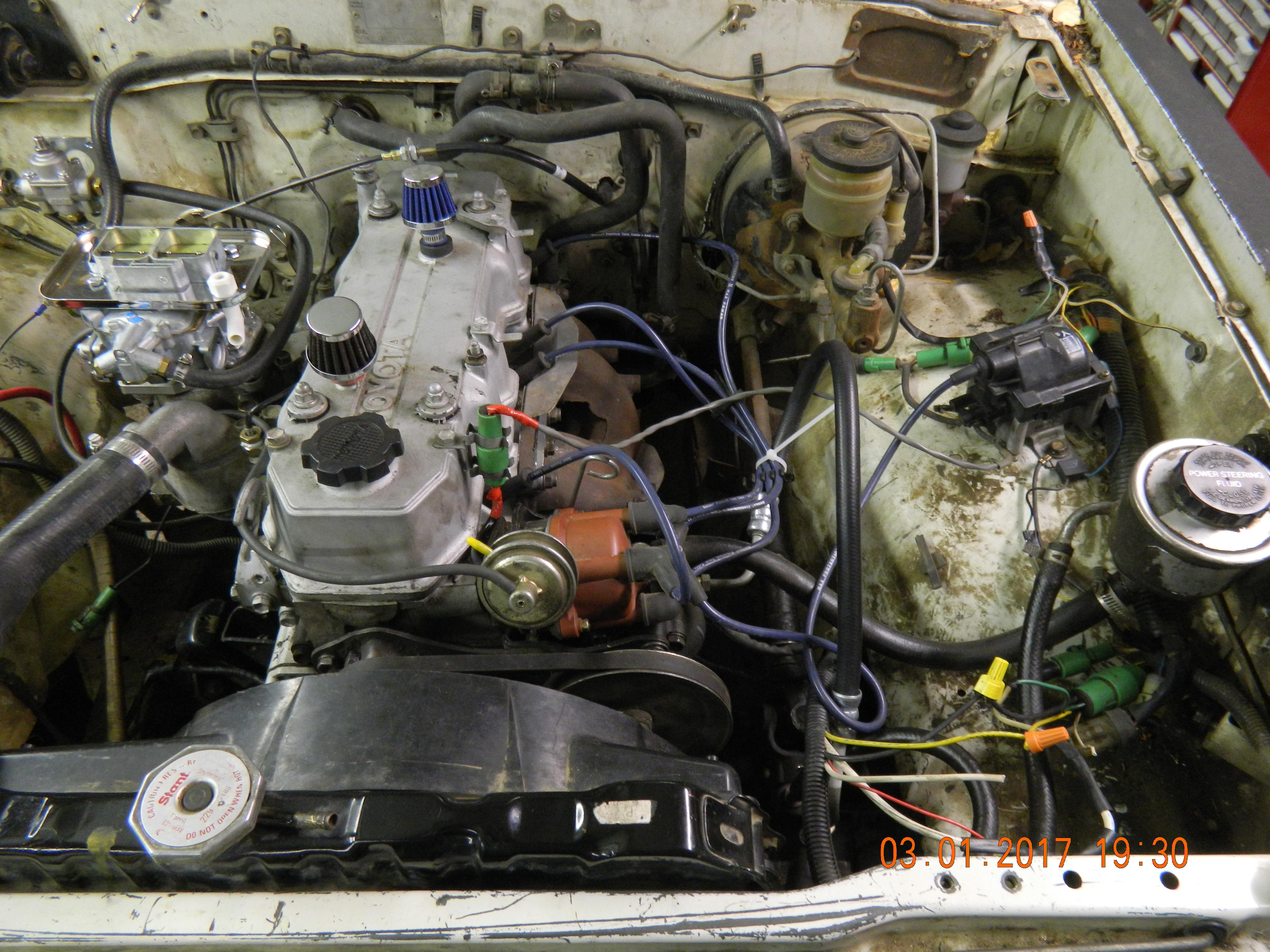

engine pics
here are some shots of the engine compartment, tried to get an angle on the possible problem areas
Attached Thumbnails 22r carbed starts, runs, stalls-001.jpg   22r carbed starts, runs, stalls-002.jpg   22r carbed starts, runs, stalls-003.jpg
