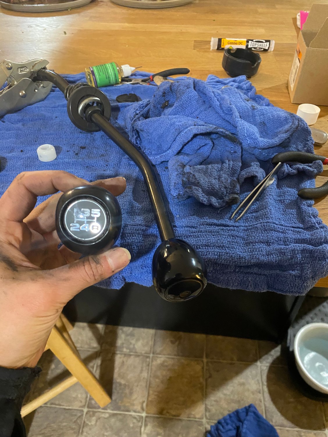

While replacing the shifter bushings on my 1982 4x4 5-speed, I was hoping to be able to put a new boot and knob on too, but I cannot get the knob off for the LIFE OF ME. I used vice grips on the rod and turned counter clockwise with my hand on the knob, used a heat gun, had my bf who is way stronger than me try as well and it just won't budge. I'm thinking maybe a former owner crazy glued it on or something? I've almost thought about sawing it off or taking it to my mechanic. Any tips? Thanks!

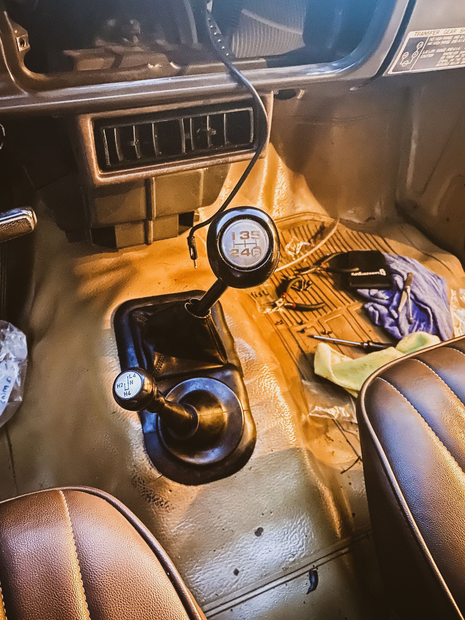

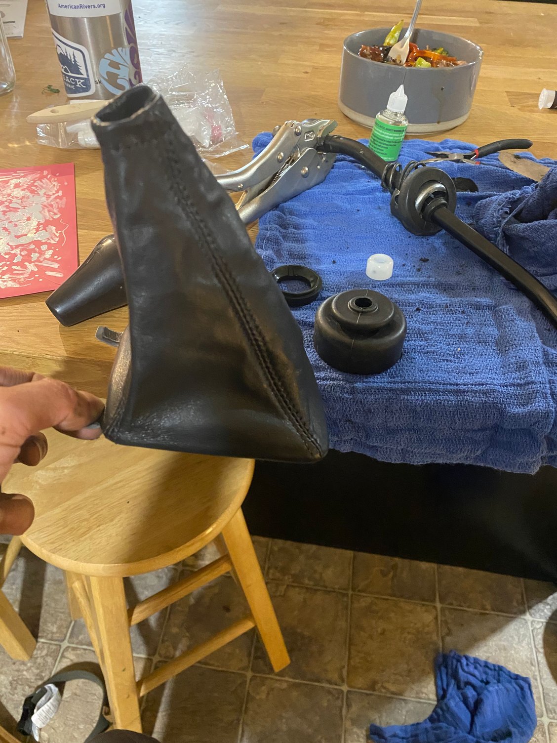

The shift boot is in beautiful shape! Is it stock or aftermarket?

Mission accomplished. I had tried to take it off for months while it was in my truck, would not budge even with a heat gun. This afternoon I ended up listening to some advice on here, drilling in the top and adding penetrating oil, then finally just took a hack saw to get down to the hard plastic (it was indeed super glued on) picked away at it and then smashed it with a hammer and it came off. I was able to add the boot and new knob. Yotatech community for the win!! Thanks y'all

Shifter boot is indeed aftermarket. Found it on eBay, glued it to the metal frame, and i’m so happy with how it turned out.
Here's a link that helped me with the step by step: https://www.redlinegoods.com/Hilux8183install.php
