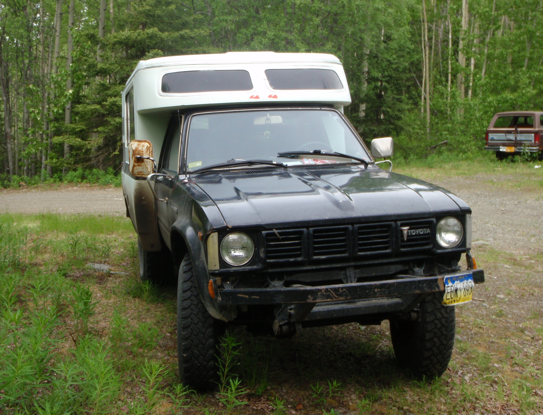

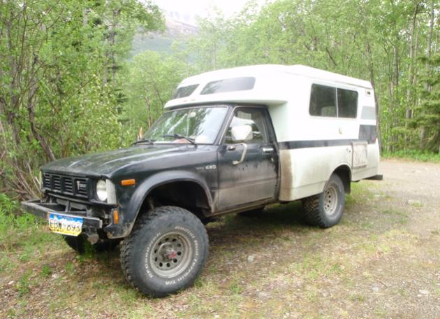

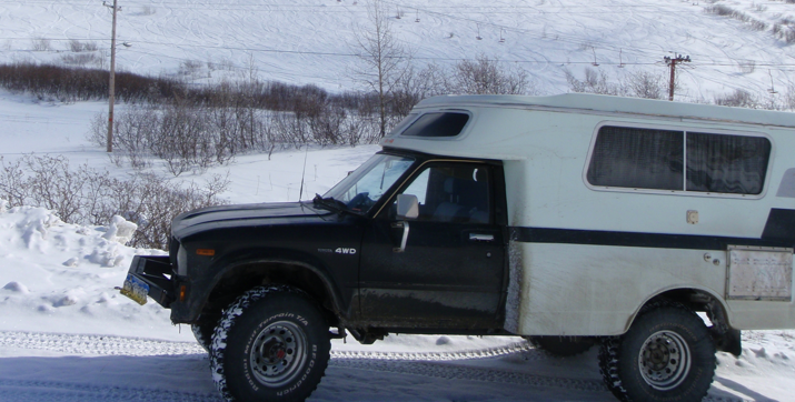

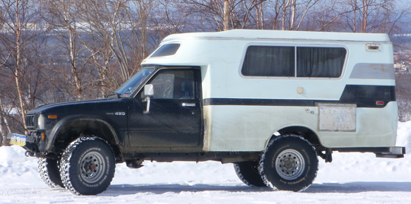

Hi every one...
First time poster here....
I recently bought a tired old Chinook... and mean tired...
The tires and the fuel tank held, but everything else leaks bad...
The truck actually ran pretty good and has been my daily driver for the last month... requiring daily top-offs of ALL FUILDS...
That was until yesterday...
Yesterday, the thing overheated... and started chugging clouds of pure white smoke out the exhaust pipe...
I tried staring it after it cooled down and I re-filled the radiator... but it only ran for a moment and like crap, so I shut her off and towed her home...
Which brings me to the creation of this thread...
I want to fix my truck, but I am not sure what is the best approach...
I am leaning twds a crate engine from .. somewhere?! (?!)
But I have also wondered if there is a DIESEL engine that will fit my truck... I would love a turbo diesel in that thing...
But maybe I should just rebuild the engine I have...
So.. let me hear some of your thoughts and comments...
I'll leave you with a few pictures of the rig...
Cheers...

yeah i have a 2lte in my hilux.. or a 2l or maybe a 3b from a land cruiser would fit!!
or rebuild the 22r
gotta love a 4x4 motorhome!!
your truck rules please restore and give it a good home!

Man that truck is cool ,good luck with whatever engine you choose.

Yeah, I want one now...that thing is cool..got any interior pics?

Looks like a nice canidate for a resto..

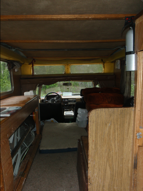

I'm sure your interior is pretty beat up, they're made pretty crappy, but if you strip it and start over you can make them pretty nice.

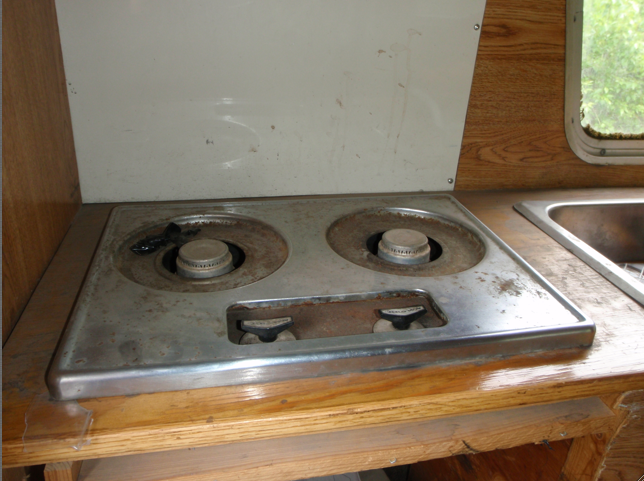

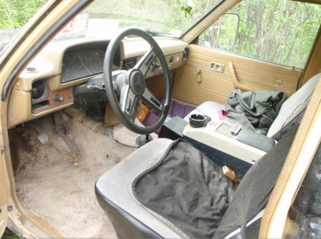

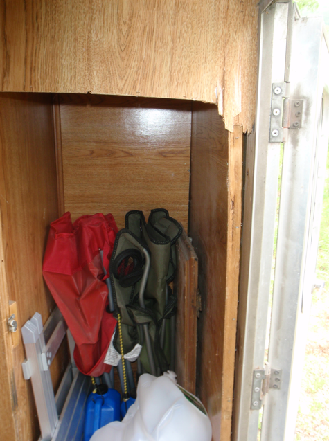

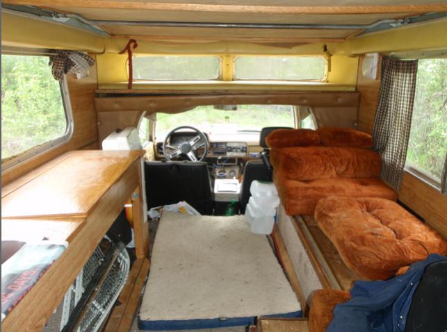

You know, as far as old RV interiors go, I would say this is a 6 out of ten...
The doors are ripped off the cabinets, the interior lights don't work, the seat cushions came from an old couch...
But other than that... the stove works, the seat/bed is solid... and the pop up top hasn't leaked so far...
Which brings me to the idea of just sealing it in the down and locked position... fiberglassing it over to MAKE SURE there are no leaks EVER ...lol...

Well. I was afraid it would just make more sense to keep the gasoline engine... darn it... oh well...
I paid US$1500 for it... plus an oil change and tune up at the local speedy lube shop..lol...
Not too bad, but I really wish it had waited another month before it puked it's guts...
So... now I need to find a reputable engine shop...
Or... would I be better off to buy a crate/remanufactured engine?
anyways...

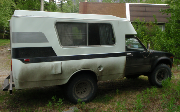

Here are the pictures I promised.. sorry for the mess... it's the dog's truck really.. not mine...lol..
Cheers...
