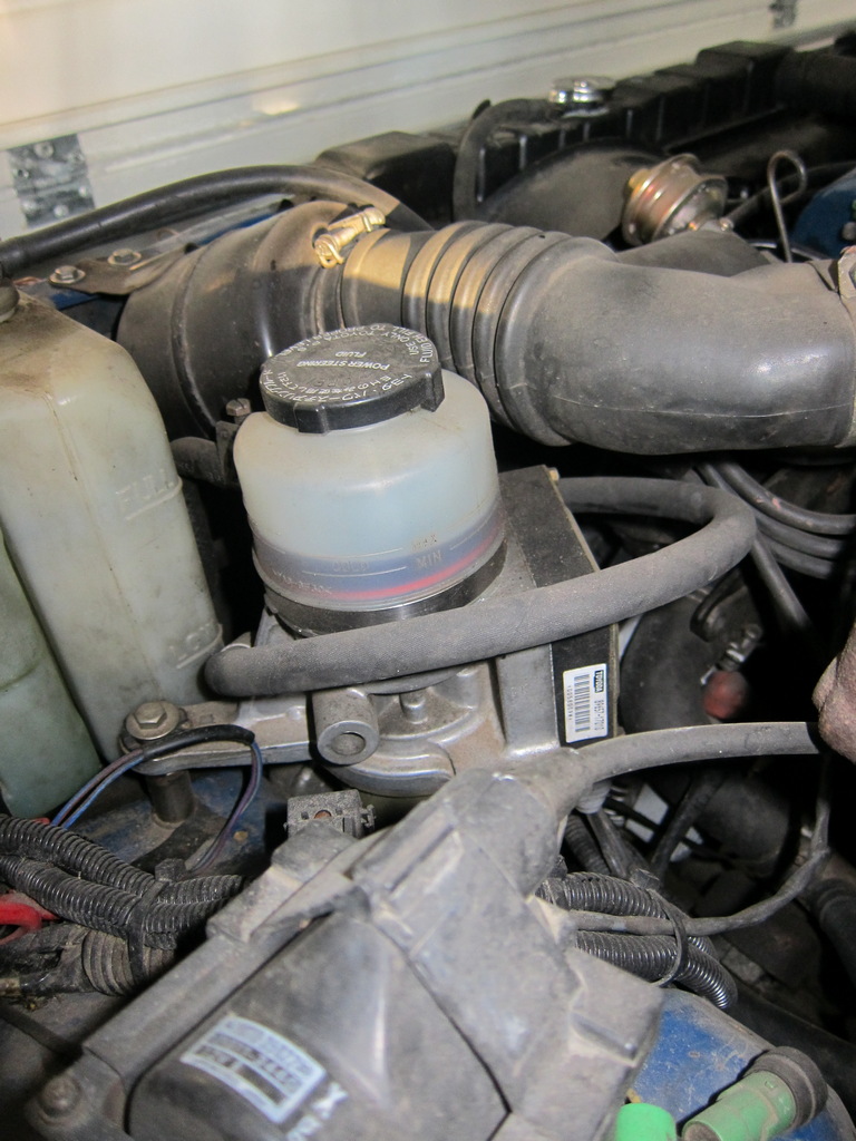

I converted manual to P/S on my 82. I then added a 20R head later.
I then added an electric P/S pump from an MR2 Spyder about 5 years ago in order to get better mileage on the hwy. Without the motor spinning a pump that's not required at those speeds should save a tad on energy. I also like the rigid feel at hwy speeds with the ability to turn the wheel to lube the drag link is handy. The reservoir, pump, motor and controller are all one piece and the high pressure hose from the truck fits with no mods. The pump does draw 45A in full turns. I also run an electric fan.
