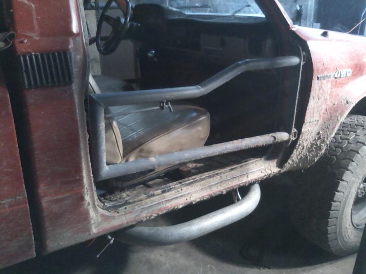

Testing the new pipe bender out. I bent the doors and step rails.1980 Toyota step bars and pipe doors-toyota-2.jpg Soon there will be a full cage. I just have to get use to the bender so I don't wast pipe. 1980 Toyota

Cool. Vicegrips and c-clamps mounts If you are gonna wheel I would suggest making a full set of sliders to protect the entire rocker panel and bedside.
But for your cage please use Tubing and not pipe...JMO.

and on your step there...you should cut halfway through the middle of it..and then make it flat..so it's an actual step
and yes..use tubing for these things...not pipe..and yes there is a difference

LMFAO Yeah I just trying things out. Trust me I am going to take the pipe off. It is 2-1/2 Galvanised. And yes when I took the pic I was not done mounting the rails. But thanks for the input. I plan to use 1-1/2 or 1-1/4 tubing like the doors are. Michael

pretty much what I figured but saw those clamps down there so thought I had to give flip you a little bit..
cool that are fabbing up your own stuff. I just got a welder, still practicing so I can do a little work myself
