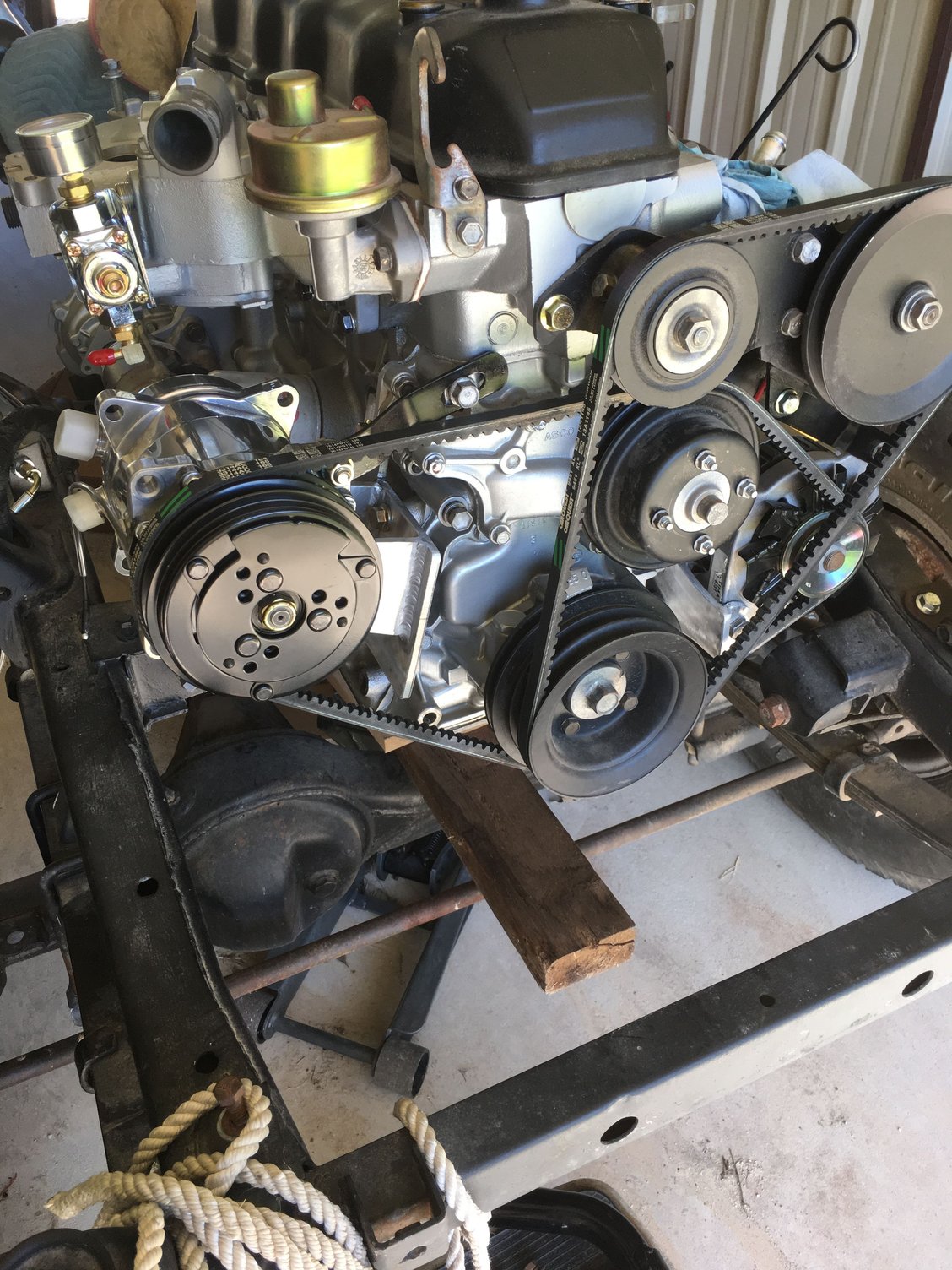

I added AC to my '81 and had to make my own mounting bracket. I used paper and pencil to rub an outline the hole pattern on the engine. Cut and drilled some 1/4" aluminum plate. Then made 2 standoff brackets and attached to compressor with the bottom trough bolt, aligned the compressor v-belt pulley on the crankshaft and marked their location on the plate. Welded on the standoffs and made an adjustment arm.
This what the finished bracket looks like. Hope that will help.

Beautiful bracket!
Thanks for that note and image. I actually did find a bracket but many people I know will love the image and knowledge of making their own. I live in the LA area around Encinio and looking for a mechanic help me put everything together… I have everything I need just not sure I have the confidence to put it all together and the AC fluid… charging. deananux@gmail.com. I’m not sure the forum etiquette for leaving my email. Love to pick your brain on what all you’ve done.
