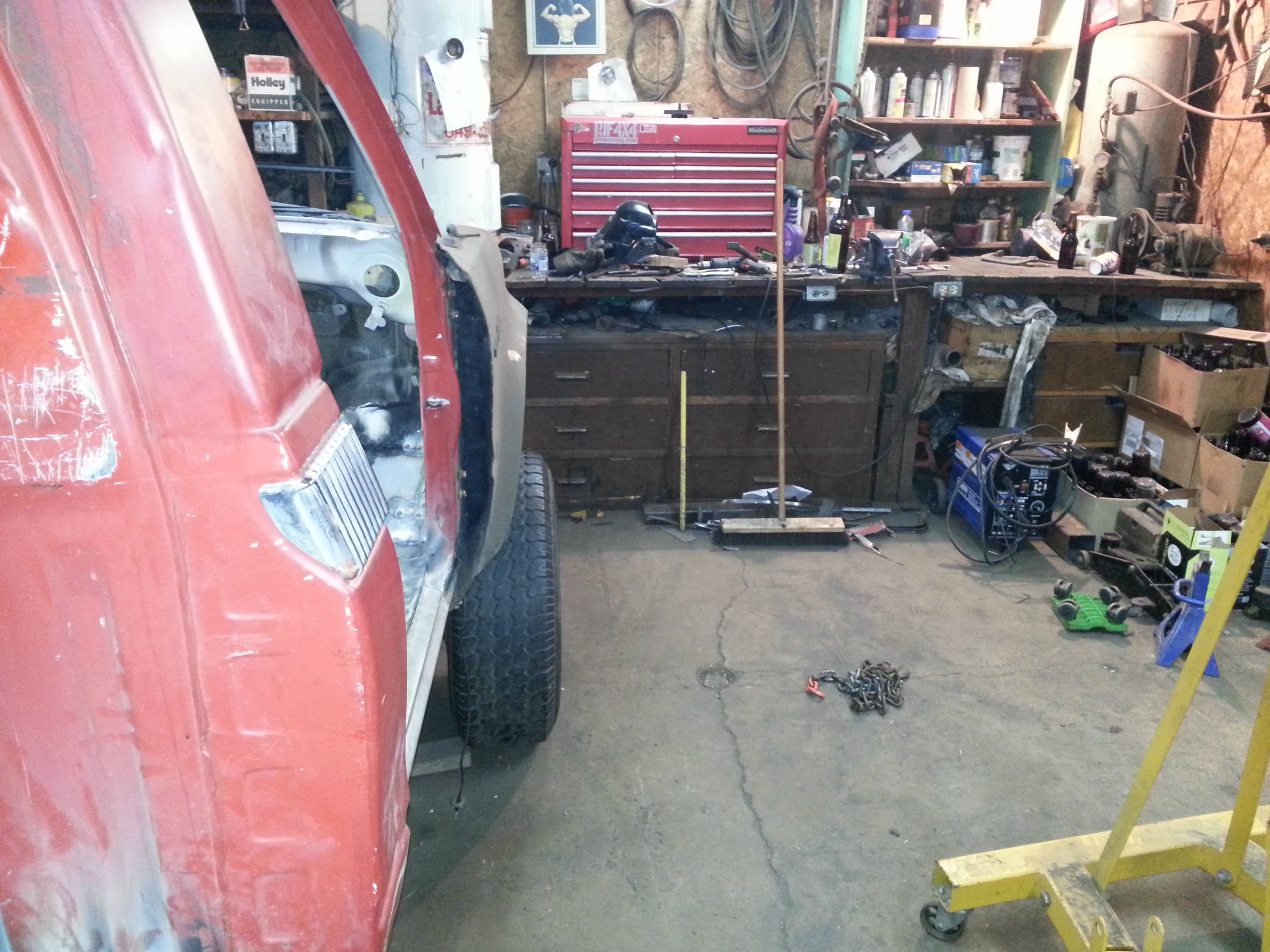

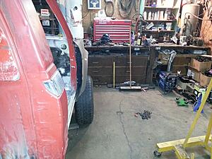

TSL Radials before my SAS
During

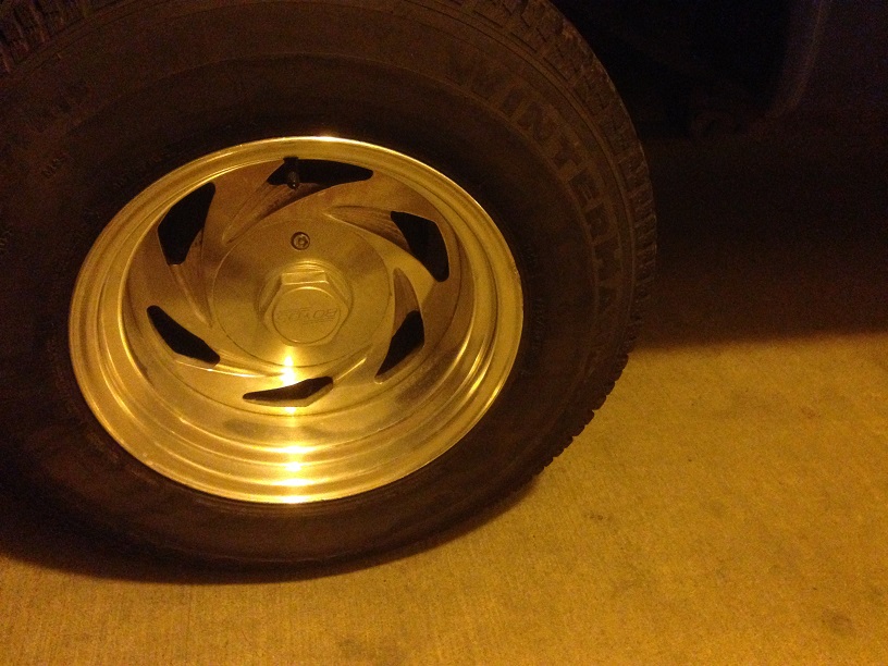

Boyds, 15x7. Using stock size tires. Got them used for 50 a wheel, not too bad.
During
Just out of curiousity, How do you SAS a truck that is already has a solid axle??

Maybe by swapping in a different solid axle or a rebuilt unit? Just guessing that SAS means 'Solid Axle Swap.'
