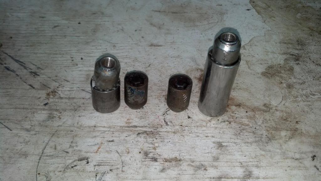

cheap 12 point sockets for removing locking lug nuts as a last resort.
