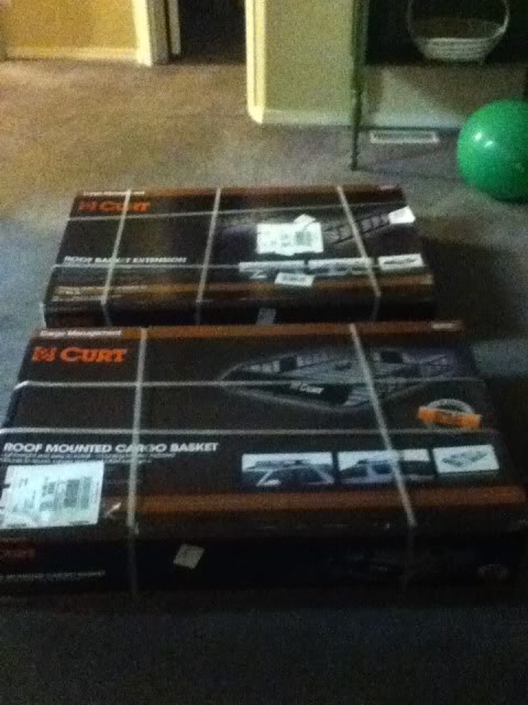

Packaging

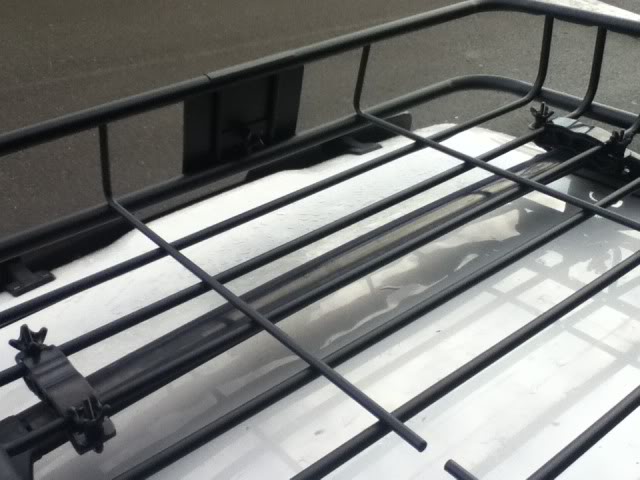

Mounts
I just purchased a Curt roof rack system and extension from amazon.com and had it out of the box and together in about an hour. it was very well manufactured and 95% of the holes matched up perfectly. The other 5% needed a little force but the bolts did go in and every thing lined up properly.
The mounting system is somewhat universal and can be used on round and square tubes.
I did need to reverse the forward cross bar to add the extra support for the front of the rack.
It measures 62"x37"x4" with extension installed and 41.5"x37"x4" with out
Overall for around $210 for the rack and extension I felt it was a good buy and would recommend it.

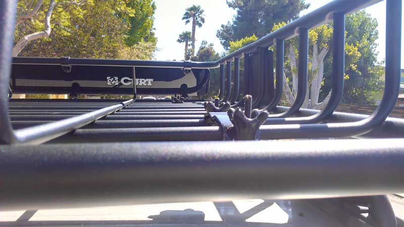

I installed this rack today (Curt 18115 Roof Mounted Cargo Rack without the extension) and I will share my first impressions. (Bought on Amazon and arrived 5 days sooner than expected. I am in SoCal). I have a stock 2001 Toyota 4Runner SR5 4x4.
The mounting bolts are oriented so they stick up past the floor plane of the basket and this is not good. I am going to see if I might be able to flip the mounts somehow but I don't think that will be possible. The bolts and knobs/nuts could easily damage items up there or get damaged by items up there.
Also, the nuts have a plastic molded knob to facilitate tooless installation but these are really hard to tighten. REALLY hard. I jury rigged a drill with hole bit, 2 pieces of wood and a pair of vice grips all duct taped together to get them tightened. I have hand problems which only made matters worse. I'm not sure if I could have new u-bolts made that are shorter or something. I might look into this option.
The rack looks just ok. I don't think it looks bad but I also don't think it really adds to the look of the vehicle very much.
The rack bolts are so tight and difficult that if I decide to remove it in between trips or whatever I will leave it attached to the factory cross bars and remove them and the rack all together.
BUT- I bought it to be able to store gas cans and other lighter/bulky items and it is plenty strong and fairly light and so for the intended purpose I am happy.
I will report back w pics or other useful info if I come up with any.
Cheers-
O
Wow, mine wasn't too bad to install, sure the bolts end stick up but I just looped them off with my grinder after the were tight. I've loaded it up with my kayak and full camping gear and it did everything I wanted todo. Sounds like you might have cross threaded one of the mounting nuts, cause I have trouble keeping them tight on mine. Only thing I've seen is a 1-2 mpg drop in gas mileage cause I now have a wind dam on top of my Runner. Hope it works out better for you.

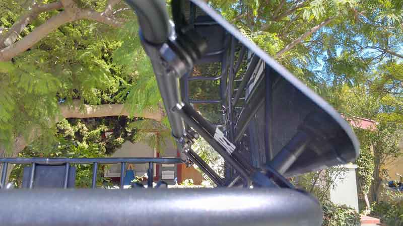

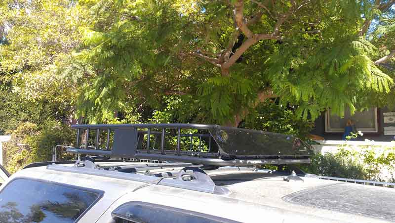

Ya it seems fine in terms of strength and such. I like it. I almost wonder if there might be a way to flip the mounts so the bolts face down. I didn't cross thread any but the lock nuts were just really tight on all of them. That is a good thing but rough for me and my overused hands and forearms. Posted some pics for others to see. The fairing I added a pic bc seeing how the hardware is oriented could be helpful.
