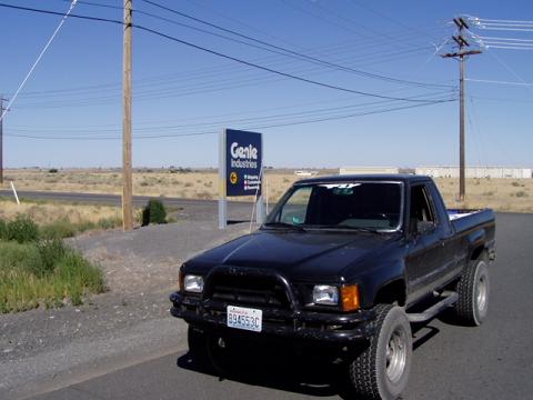

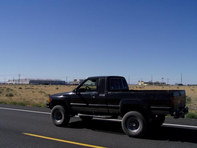

smitty built bumpers (nerf bars too)
i love the smitty built bumpers (double front. double rear) so much.
they came w/my 2cnd toyota, and i want to put them on my new*(er) 1988 model before i sell the 86.
Attached Thumbnails smitty built bumpers (nerf bars too)-copy-black-toyota-4x.jpg

I have those on my 86 4Runner and love them too

How are theses bumpers attached to the frame. Are they strong enough to use recovery straps on if you were to mount D shackles on them? Are they strong enough to use a high lift jack on?

They are a little stronger than the stock bumpers. I used to use HiLift on mine ('85) but found I needed to jump on the side of the bumper I used to jack on to push it back down to sit level. Up front they have two bolts per side into the frame where the stock bumper attached then two more brackets that catch the front two body mount bolts.

that kind of looks like rancho dr and dacatur out here in vegas. also looks a bit like ocotillo, ca. its a desert in southern cali. your truck looks awesome

Can't speak to the jack.
I've seen them ripped off by a hard tug. I wouldn't pull from them personally. Use the stock tow hooks.

i used to have the smittybuilt neft bars when i first bought my truck. tried using the hi lift on them and all they did was bend.

S%itty-built. I had them and by the time I finally took them off, they looked home made. I bent them, dented them, twisted, etc... They are great looking bumpers, but they are not thick enough for any type of abuse. I once saw one get completely ripped apart being tugged by a Jeep with a STRAP! Great for street queens, bad for real trucks.
