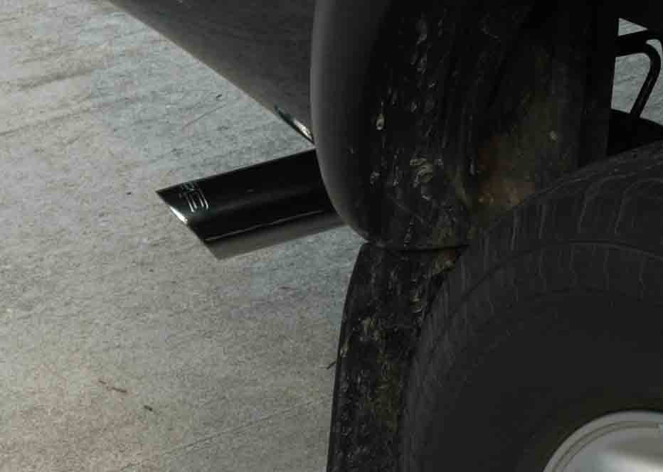

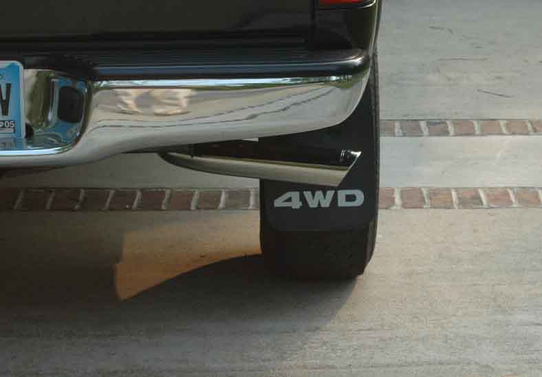

Couple pics...
Attached Thumbnails Quick TRD Cat Back review...-trdtip.jpg   Quick TRD Cat Back review...-trdtip2.jpg   Quick TRD Cat Back review...-trdtip3.jpg

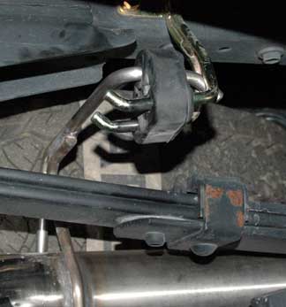

I too just installed the cat-back on my taco. I'm having the same problem with the rear hanger where it's not perfectly aligned. I can force it in the rubber hanger but the vibration unhooks it after 20 miles. kinda pisses me off.

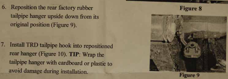

mine is just the opposite. It rattles at idle because its pushed to far on. I need to bend the bracket to make it stop. You do have the bracket rotated so its upside down from stock right?

So, how do you like the sound of the new cat??? When I had my TRD cat back installed the rear hanger was a problem also, had the installer remove it and re-install the hanger in a slightly different postion (about an inch higher & about an inch more to the rear) and I didn't like the way the tailpipe stuck out, kinda like yours Cynicx so while he was there I had him bend the tail piece a bit so tha it is pionting out the side instead of out towards the back......plus my tail piece isn't round it is more of the older style it is oval shaped....but I think it looks kwel......I'm happy with it......

I like the angles and how it comes out...looks sporty too me. The sound....ahh its alright...I need to have one of my friends drive it so I can hear it from outisde of the rig. Inside it sounds a little ricey at high rpm, my WRX's Perrin Turbo Back as alot deeper and raspier...of course it was about a thousand bucks more expensive....all in all I like it though, I just need to modify that hanger when I stop being lazy....
No, I didn't have to do that. I would be suprised to see what yours looks like. Here's what mine looks like when it doesn't disconnect itself.
http://www-rohan.sdsu.edu/~christop/exhaust.jpg
http://www-rohan.sdsu.edu/~christop/closeup.jpg

well i could have bent it down...but the TRD direction told me to reverse the hangar....
they do this so the hanger doesnt hit the rear spring if alot of flex....
here is a pic of the directions and a pic of my truck....
in the pic you can see how far away the spring is from the exhaust hanger....once i bent the trucks hanger open it doesnt get close to touching or rattling anymore...so i'm happy....
Attached Thumbnails Quick TRD Cat Back review...-dsc_0052.jpg   Quick TRD Cat Back review...-dsc_0053.jpg

I see what you're talking about now... I'm gonna try that. Should keep the thing from loosening itself free.

oh yeah, there is no way that thing can come off....unfortunately it was difficult to put on that way....
