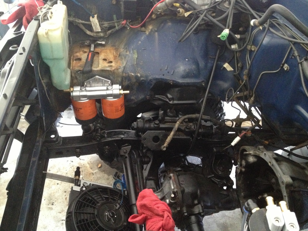

This is only what I've heard from people up here is to stay away from the cast aluminum stuff cuz they leak( like transdapt). I installed a system on my truck, but I haven't finished the engine yet, if your gonna do it though, do it right so it won't leak
Mine was less about filter relocation as it was about adding more oil capacity, but where it is now I don't have to worry about oil drain back and I should be able to get to the filters easily. Hope this helps!
And I just got the kit off eBay, the threads are the same as a ford truck, 3/4"x something, just look it up and then if you can find a nice system marketed for a 22re you can get it for something else.
