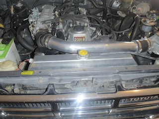

i found an LC engineering aluminum radiator w/ electric fan on craigslist for 300.00 regularly 719.95 not including shipping my radiator was on its last limb so i figured id pick it up it was in good condition and was supposably used for only a week, the reason being it didnt have a trans cooler for the first owners 86 automatic 22re i talked the person down and intalled it the next day i hooked it up first with a cheap 20 thermostat for the fan from autozone the thing was crap the fan had a mind of its own turning on and off at random so i purchased the flexalite adjustable thermostat from summit raceing just got it in last night and its so nice i gain the power from not haveing the clutch fan and the aluminum radiator is unreal light its a nice upgrade considering i live in hell arizona i would highly recommend it

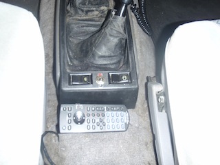

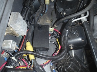

some pics and a shut off switch for water crossing
