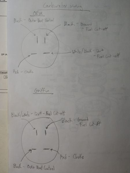

First, The wiring harness (round plug) was wired wrong. I had to pull the pins out and rewire it correctly before the fuel-cut soleniod, vent, and choke started working correctly. I can see now how the other guy complaining about his alternator being burnt up by this carburetor may be possible.

Please post a clearer picture of the hand drawn pinout of the plug, its not very legible, it will help anyone that stumbles across this issue in the future..
Looks like they did the typical reversal, not knowing if the diagram is showing the front (mating side) or back side (wire side) of the plug.

The diagram is showing the female PIN that's attached to the carburetor and compares between OEM and their wiring.
It doesn't appear they had any rhyme or reason. It looks like someone was just sticking wires into the PIN connector and didn't care. They had the 12v+ (Red) for the choke in place of the 12v+(White/Black) for the Fuel-cut, the ground (Black) for the FC was wired to the 12v+ for the choke and the 12v+(Black/White) ground for the FC going to the Outer Vent ground (Black). The only one they got right was the ground (Black) for the FC.
