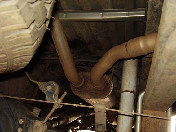

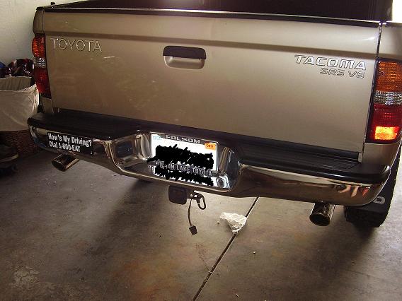

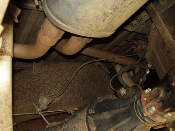

I have a dual tip setup on my taco and it's welded to a 1-in-2 out magnaflow muffler. I had a muffler shop do the instal for me and the guy who did it had the same thing on his 97 taco and loves it; so I had him do the same thing to my 02. He basically used 2'' pipe after the muffler and then did the exits with 3'' stainless tips. Not a true "dual exhaust" but it sounds great, no dummy pipes and I still have my spare tire in the stock spot. i put on some attachments, so hopfully it went through
